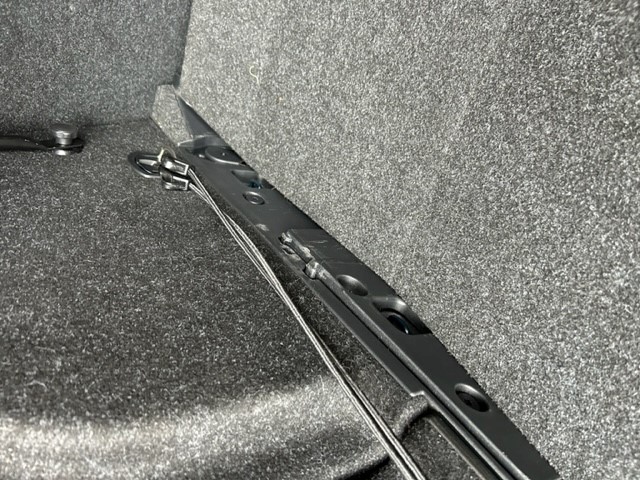

Does anyone here have the multi layer/variable boot floor in their car?
im looking at a possible retrofit so am after a VIN and also a lot of detailed photos of everything no matter how unimportant it may seem.
I believe there may be a bit more to this than bolting a few brackets in but want to be 100% sure.
thank you to whoever may help :)

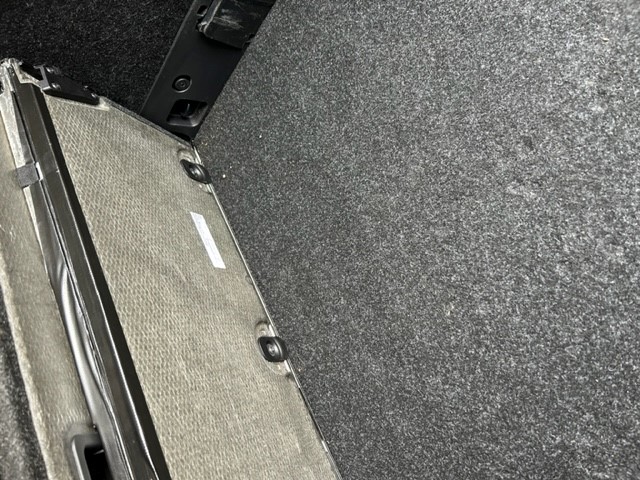

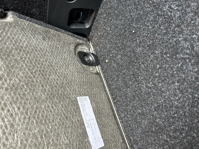

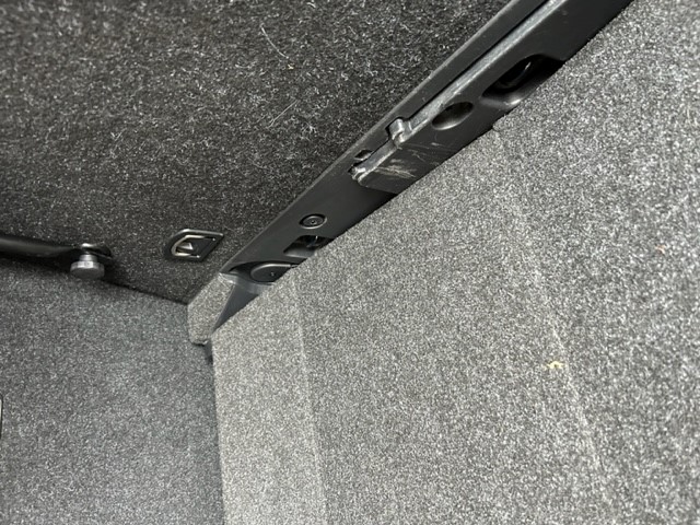

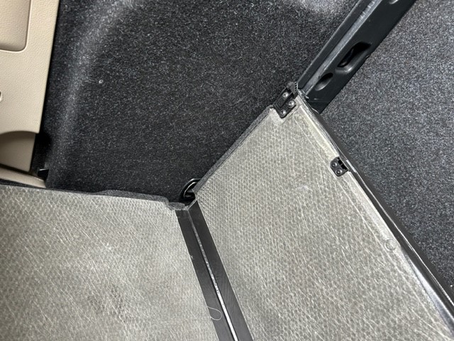

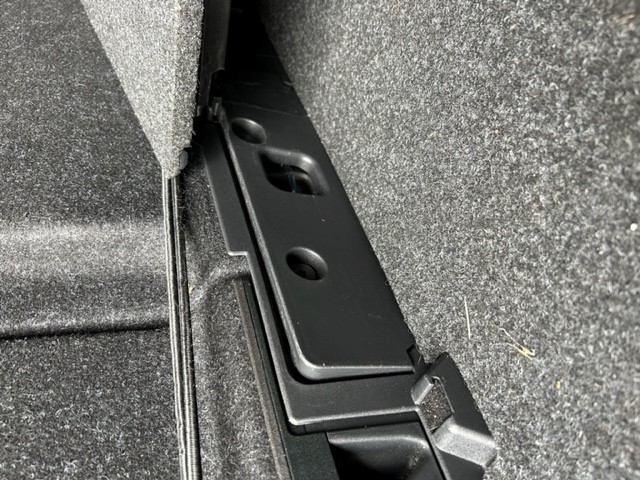

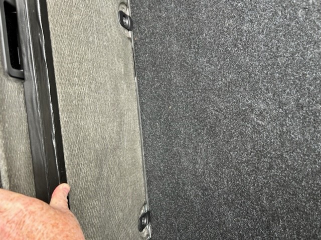

I have the variable floor on an estate, will that do?
That’s exactly what I’m after thanks.
As many photos of all bits as you can get would be massively helpful!
OK, I'll do later and PM you the VIN.

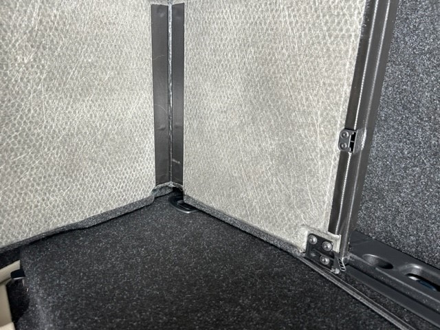

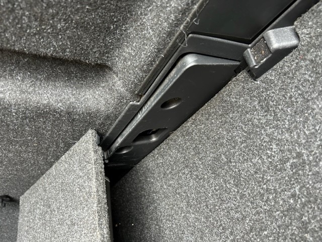

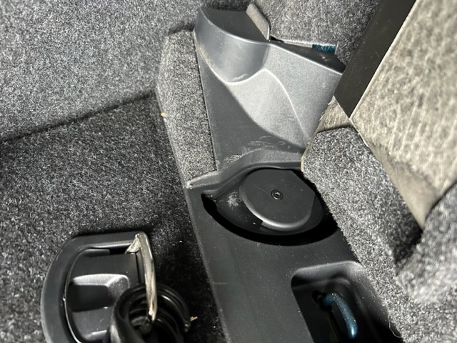

Thanks for all that dude!!!
much appreciated.
of course it’s so much more intricate than other vag cars!!
much appreciated.
Let me know if you need nothing else. PS Sorry about the rotated iPhone images :angry:
There is a hinging system under the floor by the back seat that is/was listed on the foreign car part site everyone uses (cant remember its name)
Do you mean ifinterface.com?

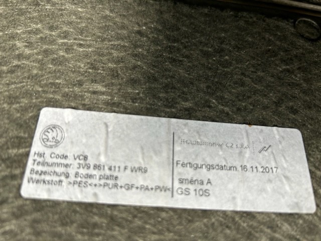

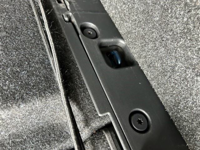

As far as I can see, you will need:
3V9 861 411  Boot Floor
5E9 861 527/528 floor retaining bar
3V9 864 321 cover for retaining bar (2 required)
N 908 265 03 screw (2 required)
3V9 864 511 filler panel left
3V9 864 512 filler panel right
3V9 858 857 A filler panel left with sound system (check variations)
5E9 853 909 A clips (4 required)
N 909 747 01 scred (2 required)
