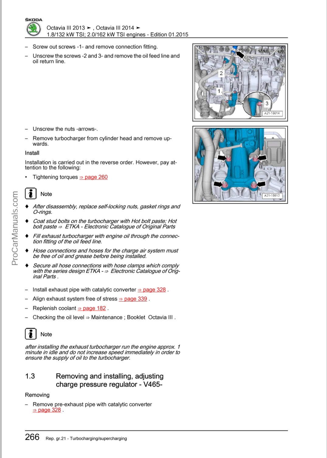

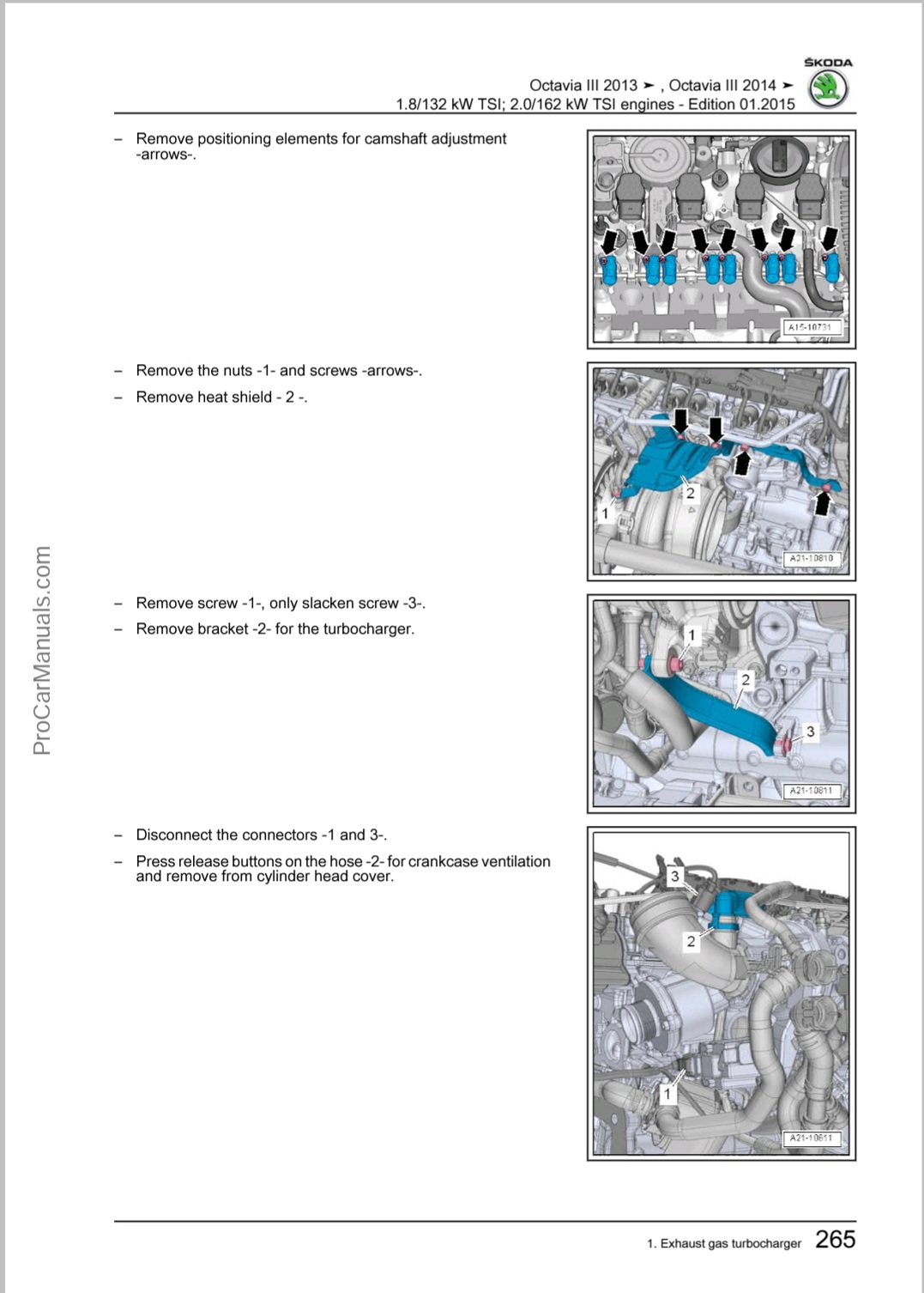

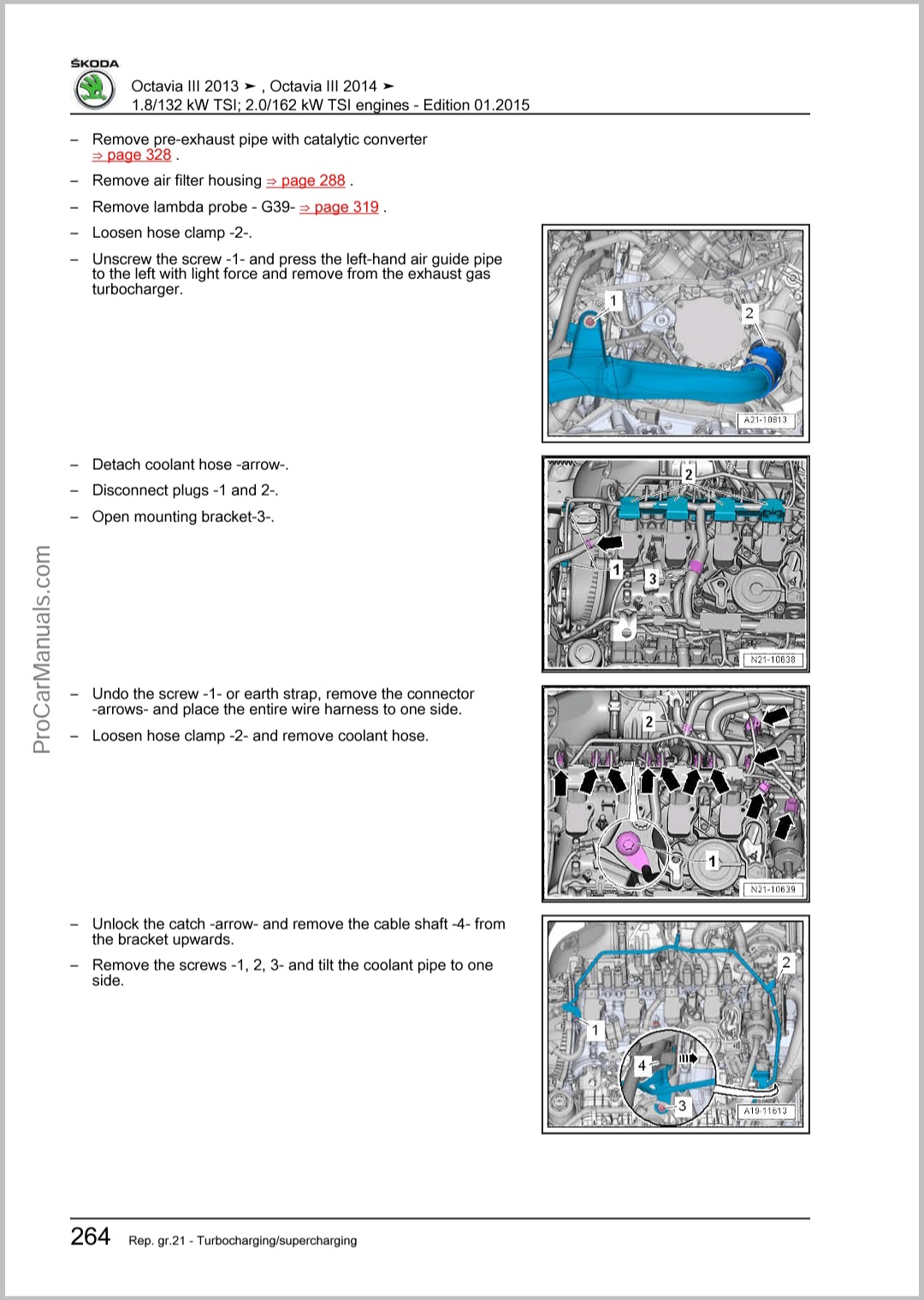

I had my petrol turbo replaced by a independent vag specialist a few years ago. I'm also pretty handy, but didn't have time to do it myself. It seems pretty OK to do, the most important bit is to fill the new turbo with oil before buttoning up.
1660288648_Screenshot_20230824_181146_AcrobatforSamsung.thumb.jpg.08fb481ba9d71787b12bc79a062d0534.jpg2086202129_Screenshot_20230824_181149_AcrobatforSamsung.thumb.jpg.fc1f67b17fcae7f8a0a8080abeac7769.jpg481593068_Screenshot_20230824_181153_AcrobatforSamsung.thumb.jpg.41986cfc1d58be32d1273590493cb19d.jpg
