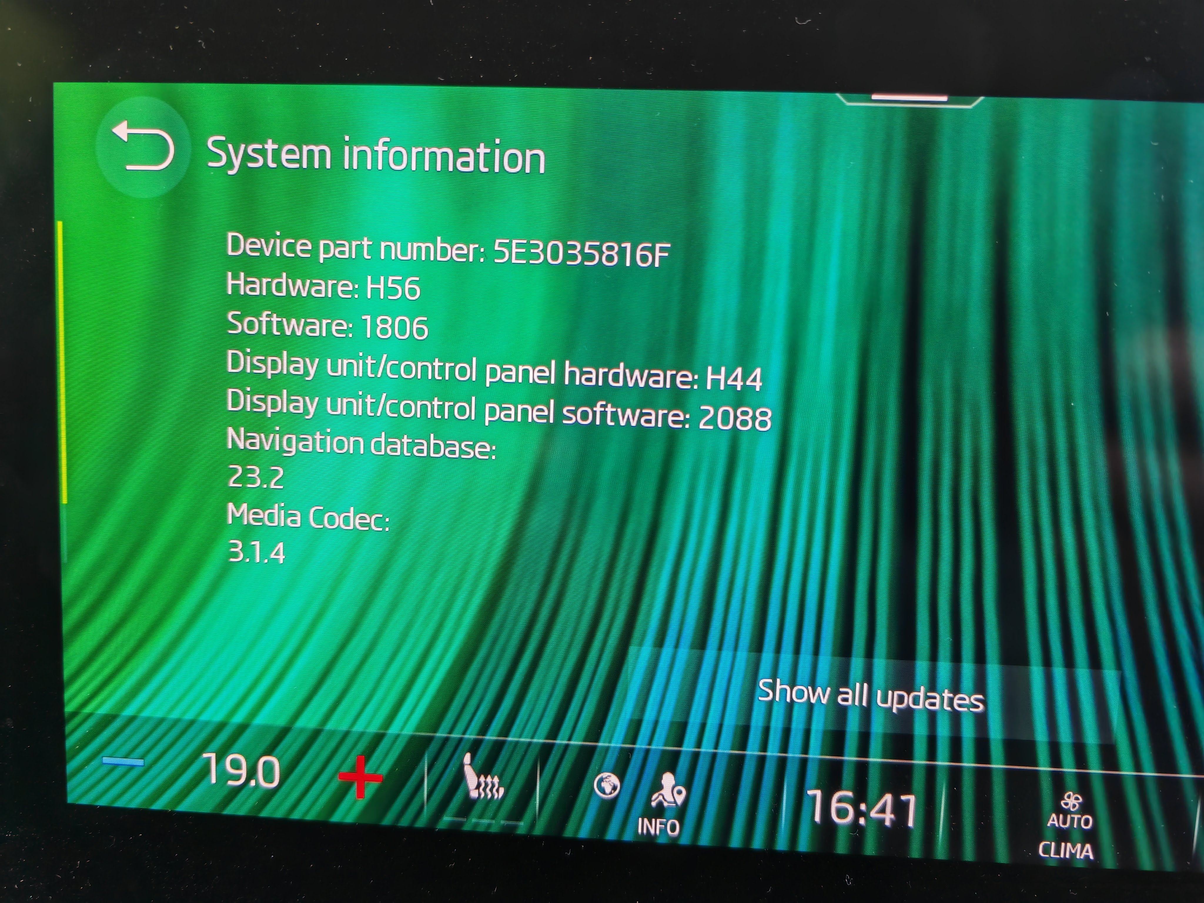

Not sure. This is what i have installed-

See above for the version. I'm not sure which one is the relevant one.

I wasn't sure which one of the numbers listed in the screen was the relevant one.
Why isn't it upgraded OTA? is it just too large?
It has to be updated to a higher version of the firmware first, then it can go up again, although it may have to have a hardware upgrade as well before that can happen.
