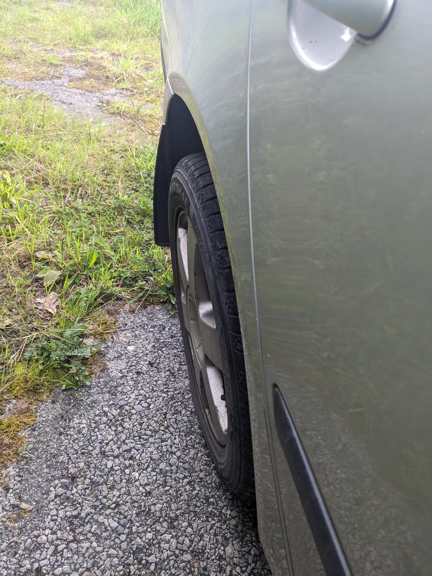

I have a Skoda Octavia Mk2 Estate, 1.9tdi, was driving along a couple days ago and suddenly one of the rear wheels suddenly went inwards - im not a mechanic so forgive my poor way of describing it. Managed to crawl it to the local garage I use who are very honest and understand my finance position and told me my rear beam axle has failed. He said one brand new is a lot of money so I could try ebay. He did say if possible try to get a complete set and mentioned the word subframe but maybe I miss heard or its the same thing?

Can you take a photo of the part that is broken? Perhaps the upper wishbone (13), lower wishbone (7), or the axle guide (2).
Broken rear springs are very common. When you say the wheel suddenly went inwards, do you mean that it looked like the rear spring was suddenly fully compressed? If so, this is most likely a broken spring.
If you don't have a factory fitted towbar, then gknautomotive thinks you have rear springs with OEM part number 1K0511115BF. These springs have 1 white dot, and 3 yellow dots.

I suspect that the rear crossmember/subframe/call it what you will has severe corrosion and the upper wishbone has parted company, that would explain the confusion in the terms.
Could equally be a rotted upper or lower wishbone, the whole set up is self composting!

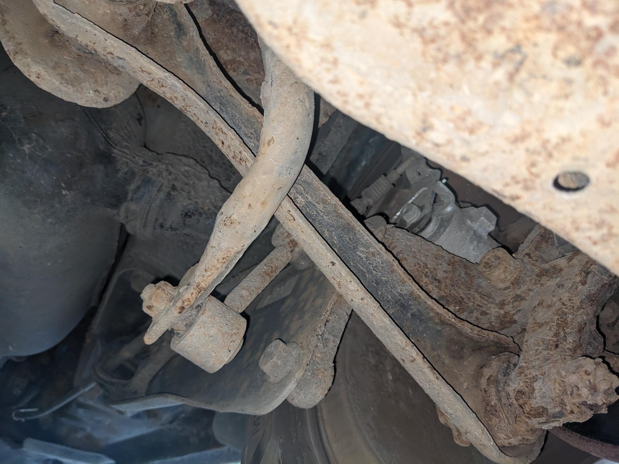

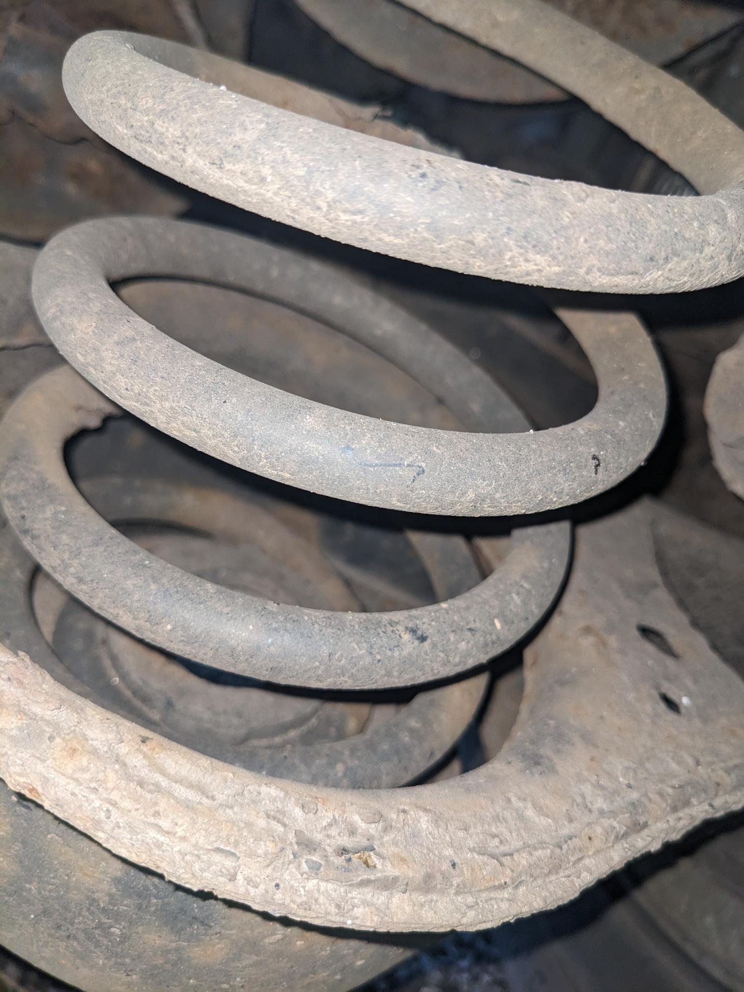

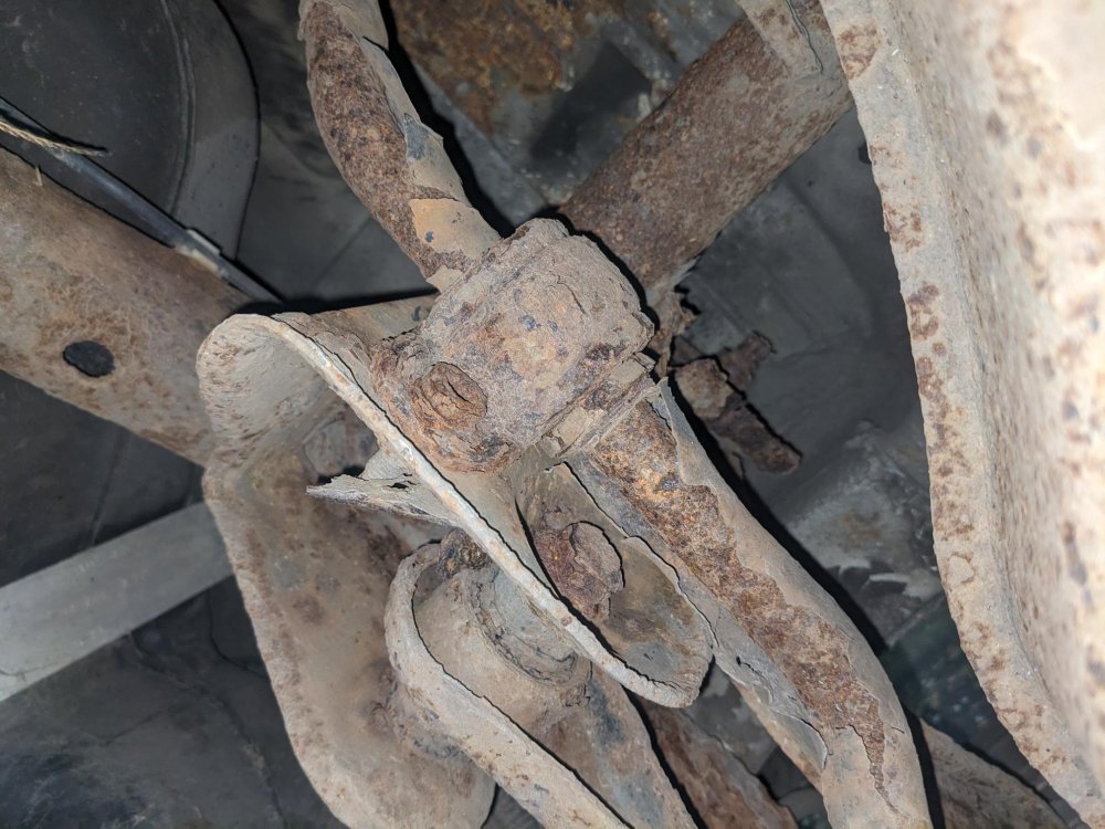

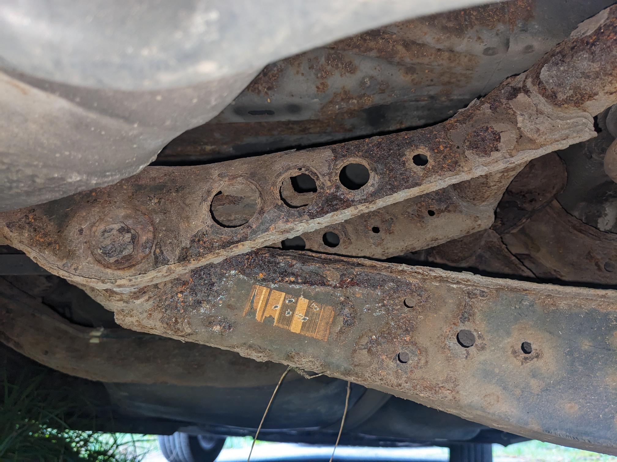

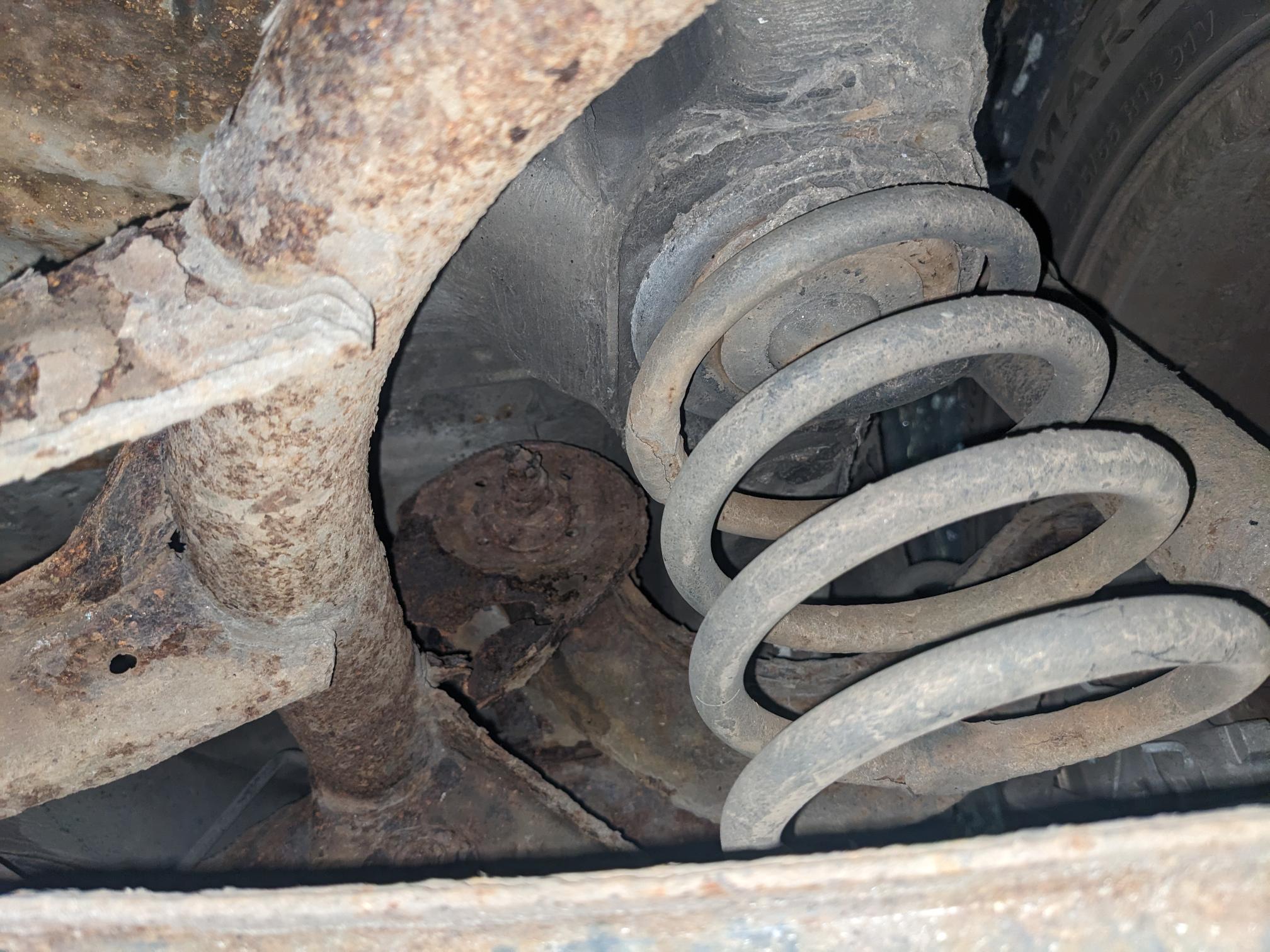

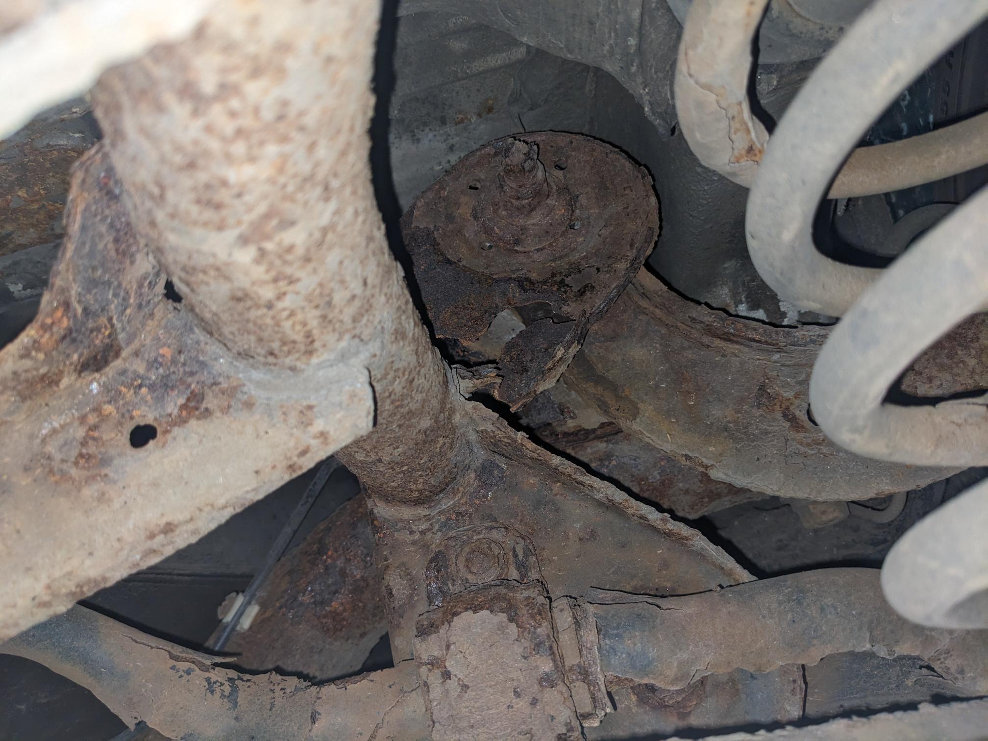

Hi all,

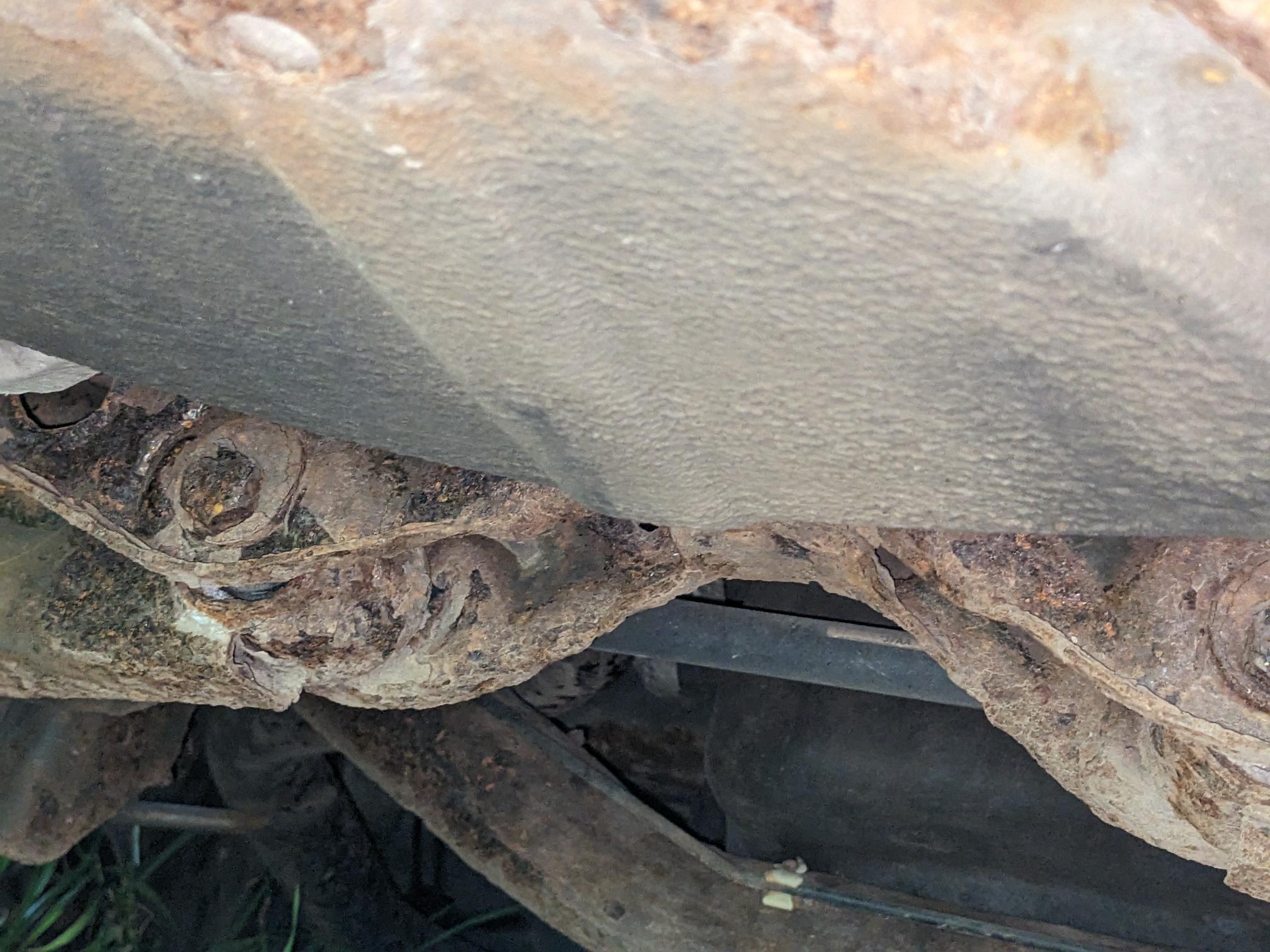

I managed to walk over to the garage, get under and take some photos. Jesus im no expert but was shocked at the sheer amount of rust, Even part 16 in the drawing in previous post looked like hell. Im now wondering if its even worth it but any thoughts or advice or even if you need more photos just say, would be really appreciated. Im bracing myself for the worst
PXL_20230825_093658112.thumb.jpg.a0d2c78be900b98108b59aa10501b68d.jpgPXL_20230825_093641021.thumb.jpg.9ab16c06d7527ede72183f4e3b930a09.jpgPXL_20230825_093757694.thumb.jpg.236429e4c4816b430954d7e5257a359e.jpgPXL_20230825_093652553.thumb.jpg.55dd0dbe6147b8746becc0ef03ca18cb.jpg
Replace the lot, springs may be good for a while yet.
Thank you, if im getting the local garage to do this then how much would you guess it should cost? Would £1k be realistic with parts, labour and VAT?
Perhaps a stupid question but should I look at the rest of the underneath including the front to see if its the same? If so then simply rid the car?
Thank you again in advance, im sorry to take up time but this is really helping and every penny counts. The rest of the car has been sound so far and its just a run about for shopping and odd 100 mile journey.
@SilverArse
I completely understand your situation...
All things considered, your wisest choice may be to source a good/younger complete assembly from an online breaker as suggested previously.  It makes no sense to buy new parts for such an old car, just patch it up as best you can.  A used assembly with less rust just perhaps needing bushes will be less outlay than new pattern parts from Germany, be wary of used part condition and breakers asking unrealistic prices but do allow for shipping, it's a large and heavy item on a pallet.
That may sound negative but bear in mind old car road tax cost and the inevitable other jobs likely due or imminent.
If you supply the parts of course you'll get change from £1k, seek out a reputable indie as it's just a matter of deconjoining the old bits and bolting the replacements on, likely with new bolts and getting a wheel alignment afterwards.
Edited by MicMac
I think photos 2 and 8 show what has let go, I assume you are no longer driving the car, if you are please cease to immediately if not sooner!

Probably a sensible, if unfortunate, decision if you've got to get someone to do the work. There's a lot of labour involved in building the rear axle up on these, and you can't be sure how good the mount points really are until you drop the axle off.
