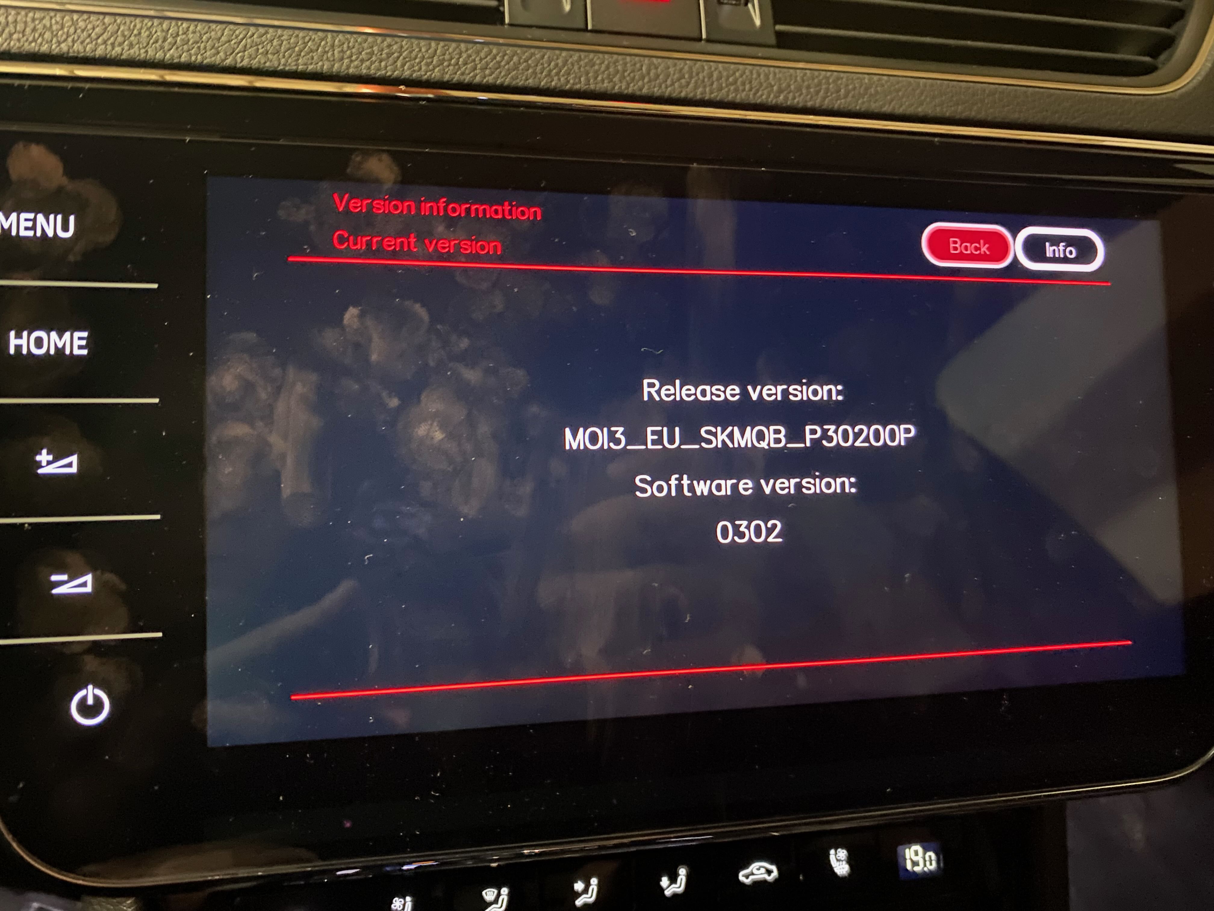

Hey, recently my infotainment started acting weirdly. I can not change the volume. The green indication bar shows up, but doesn't move. Tried on both, steering wheel and on screen.
It happens every time I start the car. Each time I need to restart the infotainment by long pressing power button, and sometimes it crashes on it's own.
I've checked the available updates, something shows up, but when I click update the text dissapears and nothing happens.

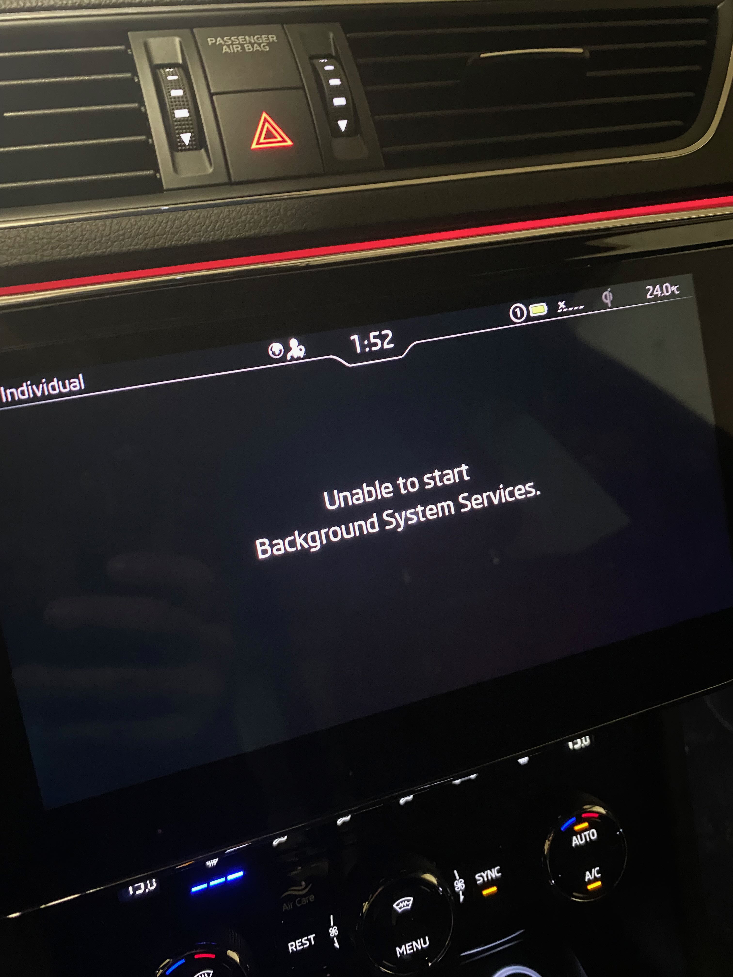

There is also a notification about application update, but I guess that's some weather app or something. The update doesn't work as well, getting "Unable to start background system services".

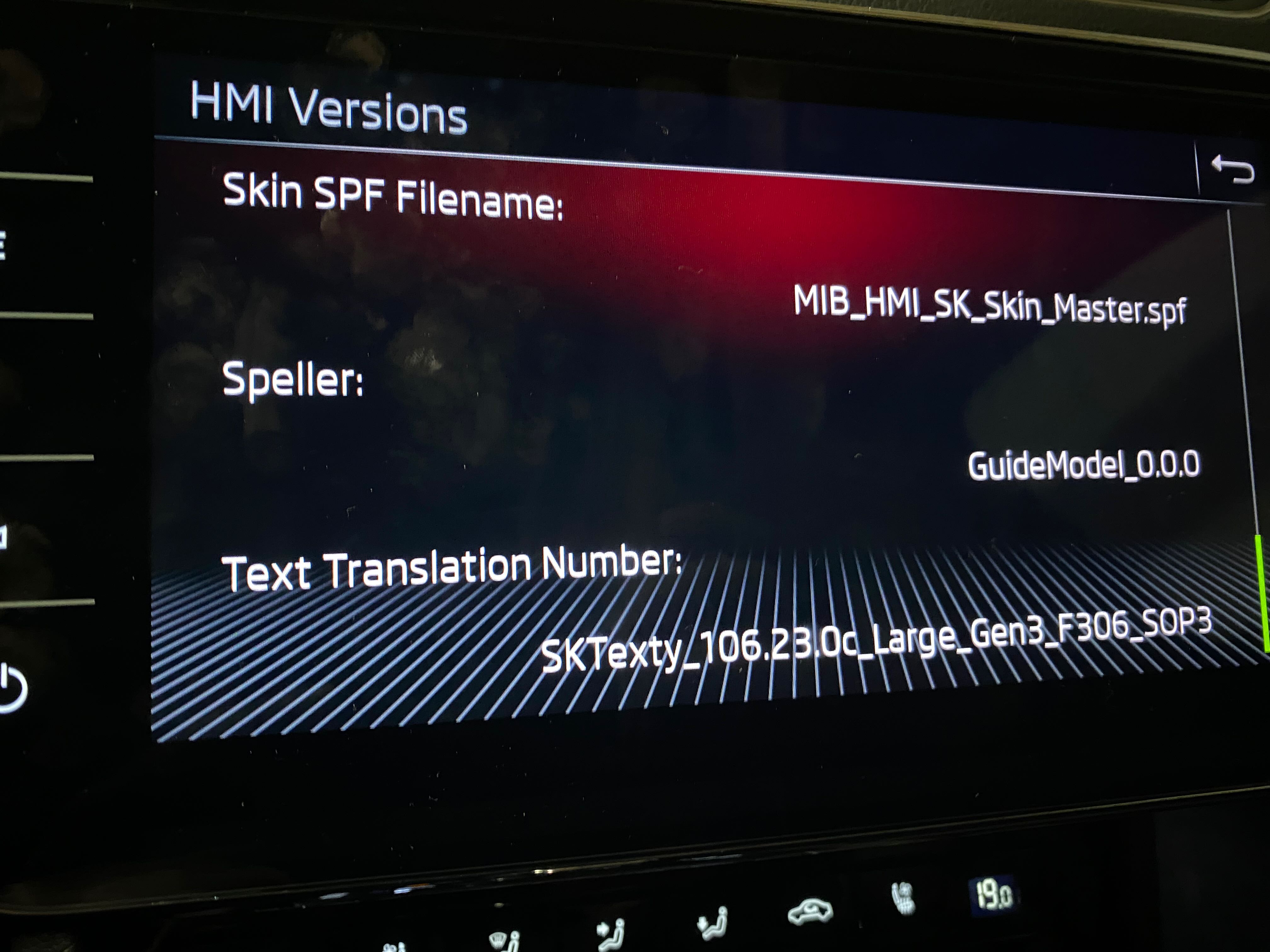

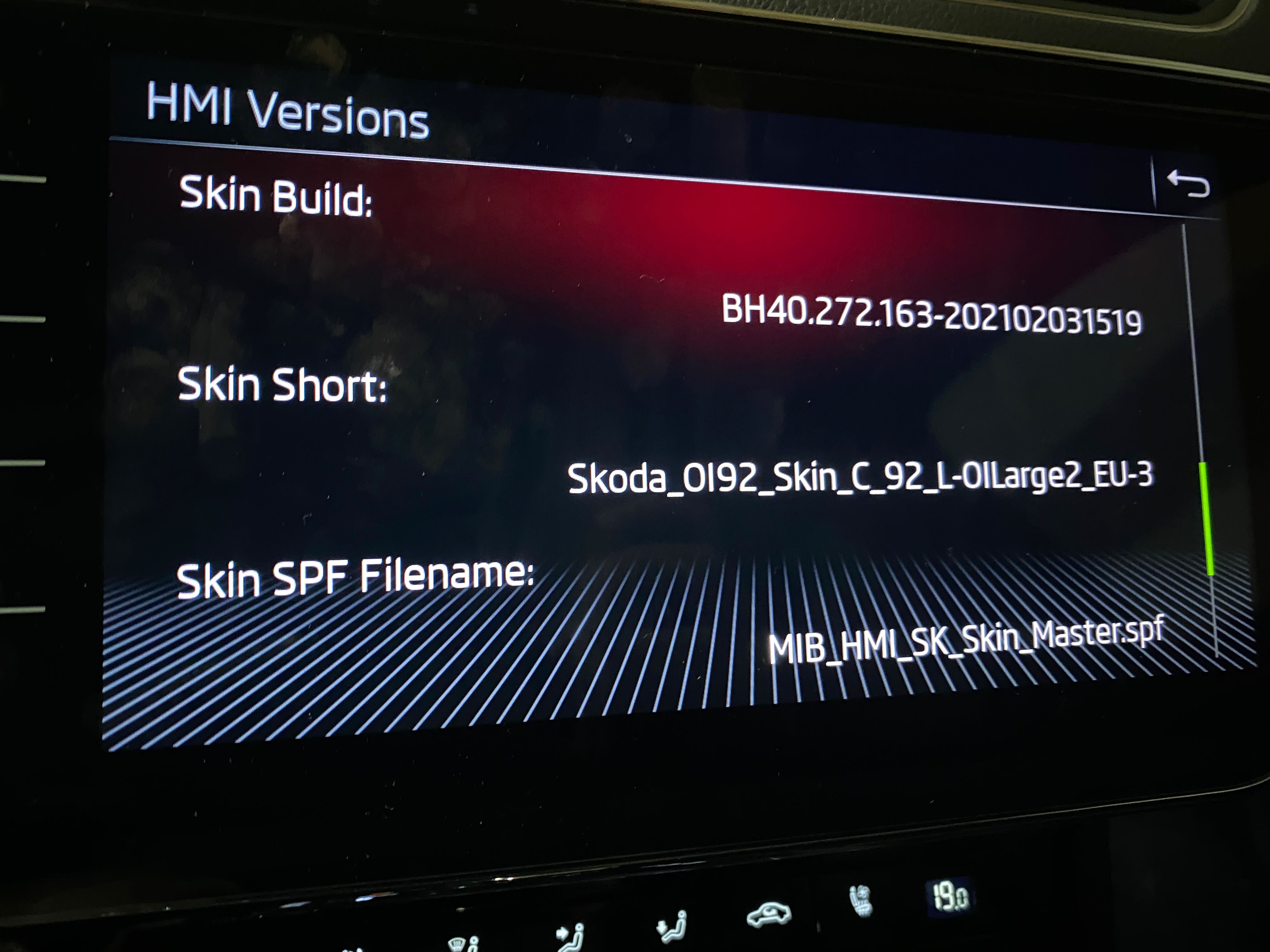

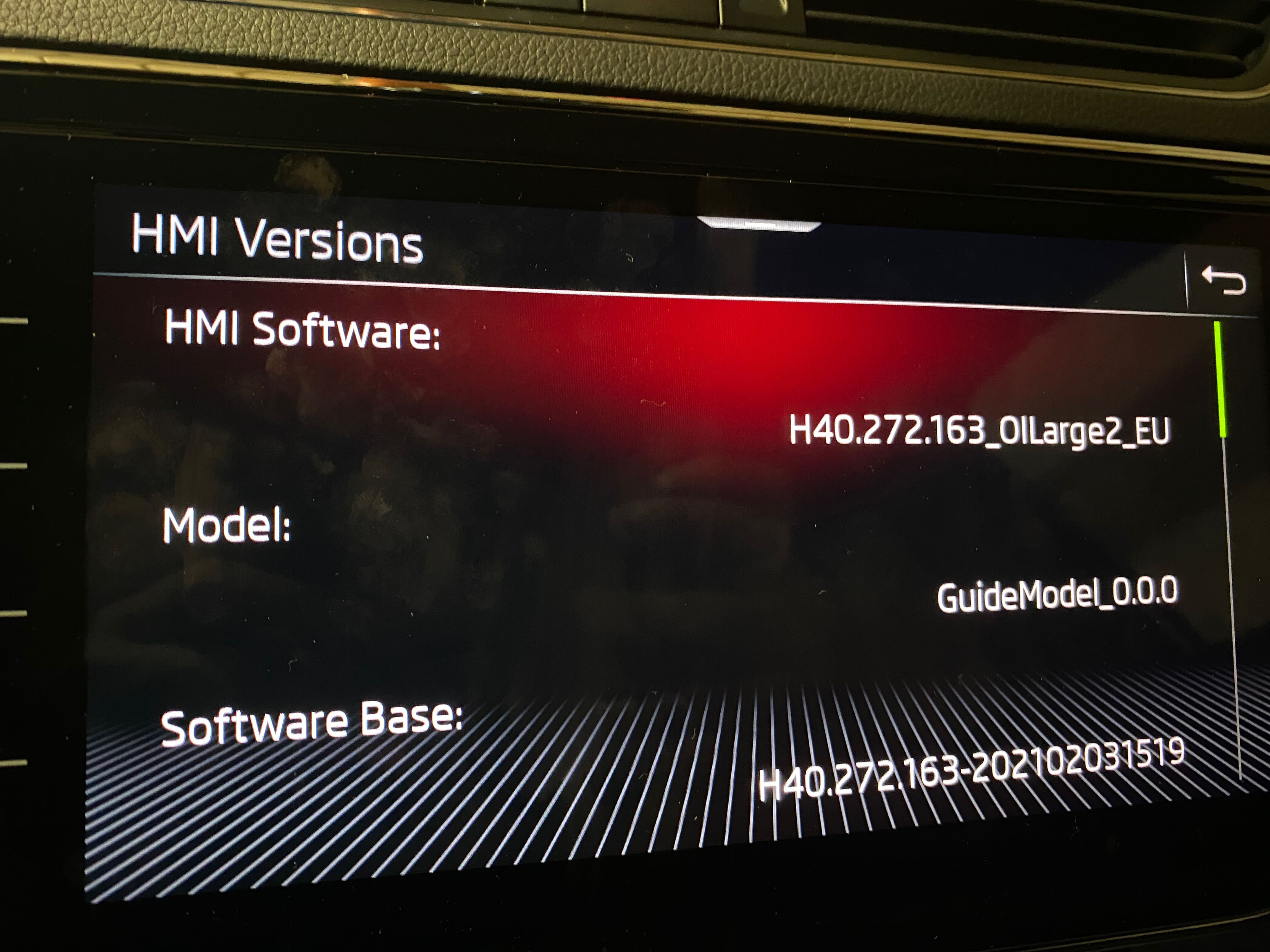

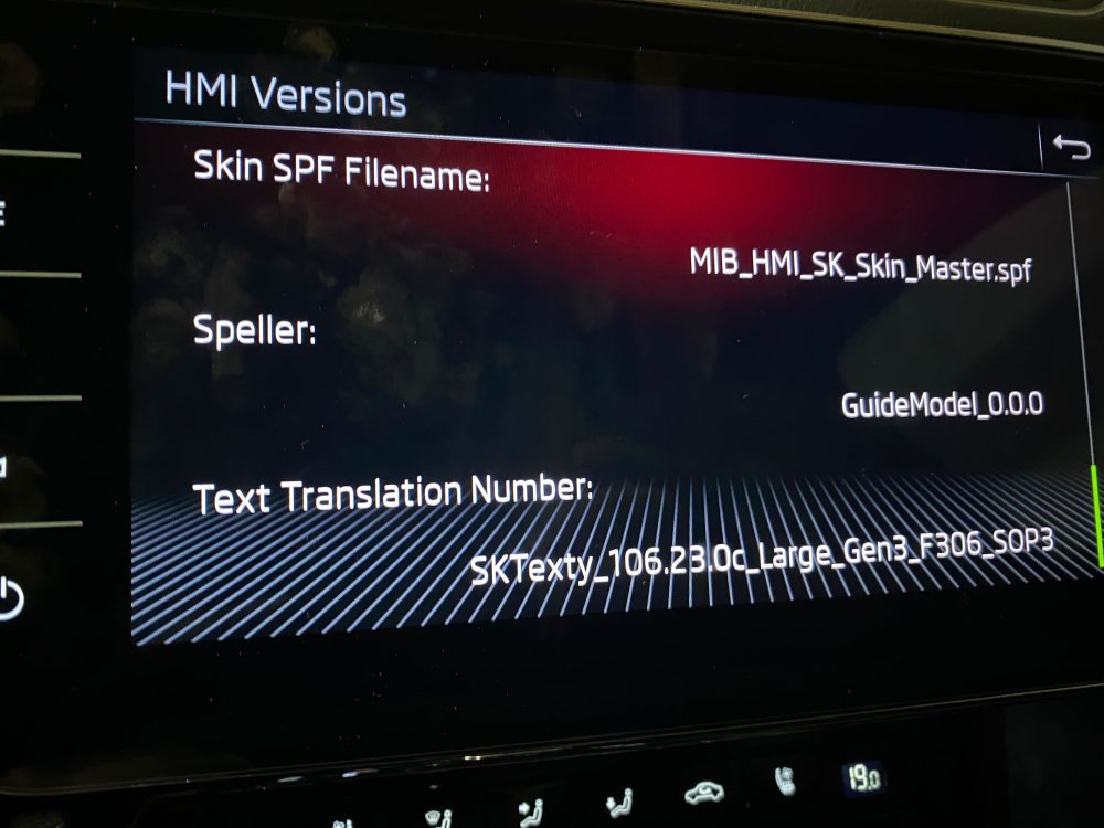

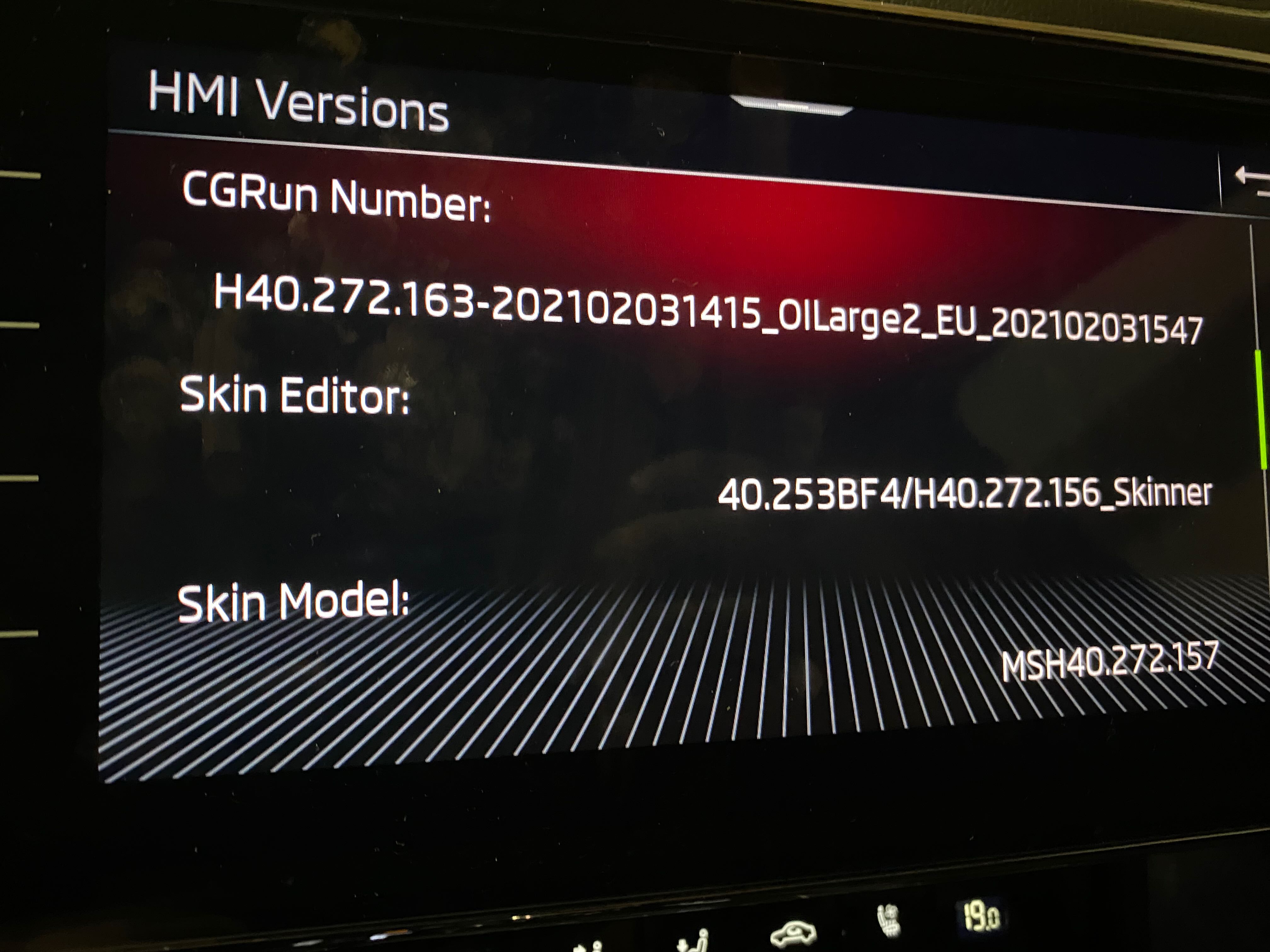

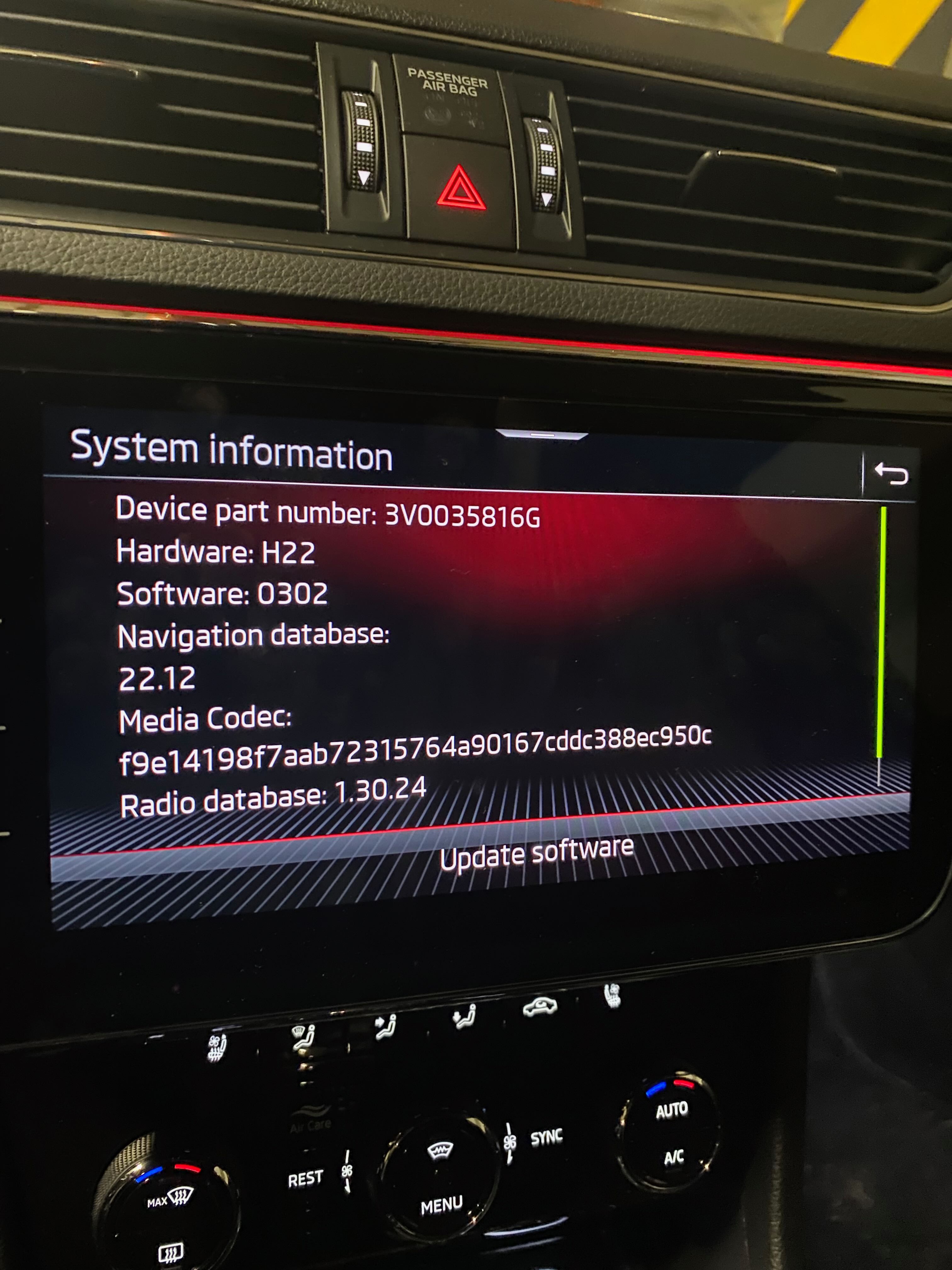

I'm attaching some photos of the system version. Any tips what I could do without visiting the dealer?
Maybe there is some crucial update and I have to do so?

You can update software yourself. Newest one is currently 0324.

I went to the dealer and they updated the software to 0324. Problem still occurs sometimes.

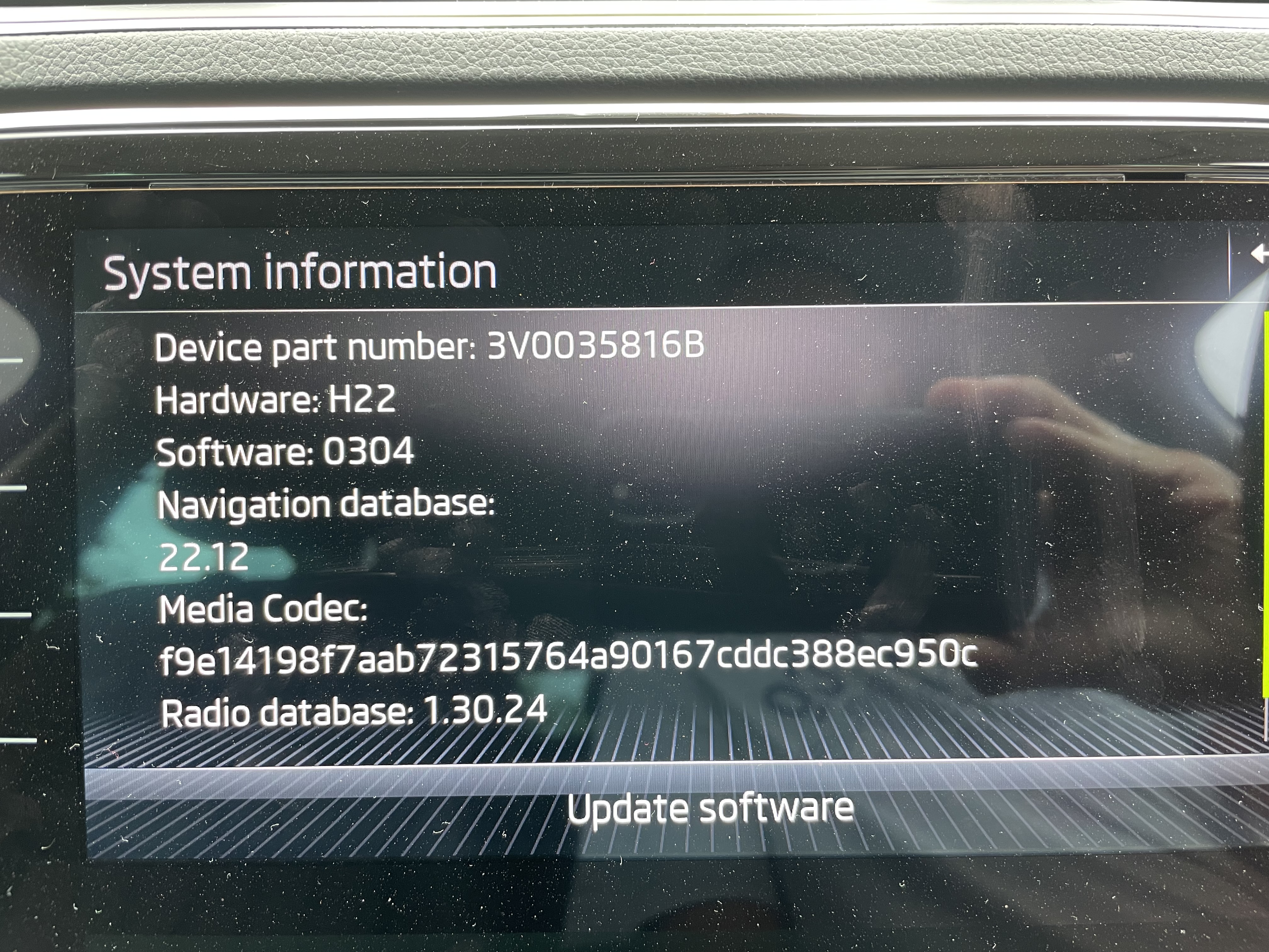

Could you share what is your system version now?

On 12/09/2023 at 14:16, GarySN said:
Different Part no. to @kbudaj- different ending letter; is this different versions of MIB?
