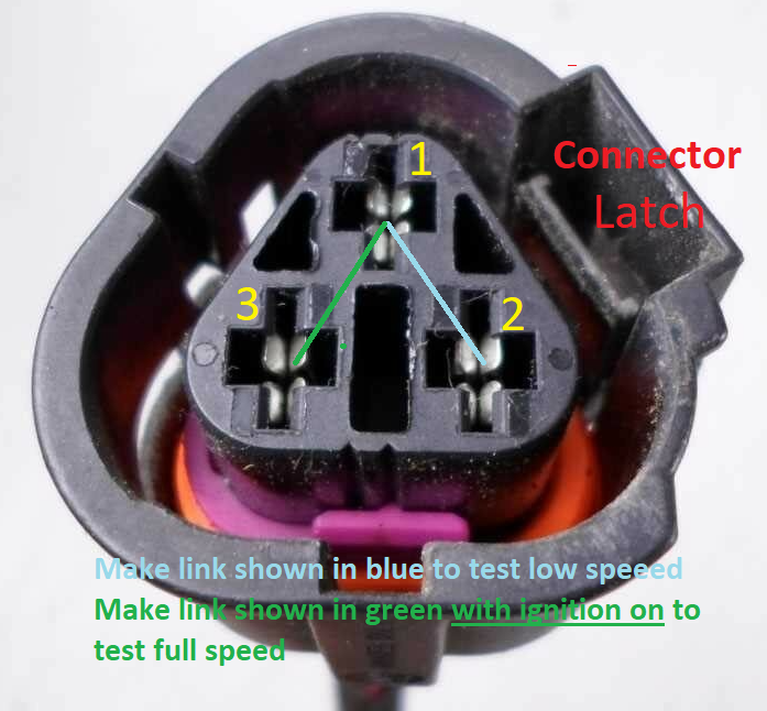

Try shorting out the thermoswitch, it should come on immediately.

Hi thanks I changed the switch previously but I will check again. I know the fan motor runs as it goes great with ac on
No, what you know is that the fan motor runs at FULL speed, I suspect it doesn't run at the lower speed. Please test it by shorting the terminals you've been shown.

If low speed function fails, when A/C is on the fan tends to run in short bursts of loud, full speed action punctuated by not running at all. Is that what you're finding?
Obviously most noticeable when car is stationary, idling.
What should happen, if A/C is active/cooling is that the fan should run continuously at low speed (if ambient temperature is warm/hot).

’my guy’ went underneath to test plug as suggested and noticed after removing sleeving that two wires for outside sensor (not worked for over a year) insulation ‘ bubbled’  it not broken. Scraped of some insulation and wires corroded and open circuit.
then took plug of temp sensor on radiator…… same issue.
insulation ‘bubbled’ and two out of the three same as sit temp issue.
no cuts to cables but wiring inside grey/green, brittle and fell apart.
quite poor quality? No actually 13 years old
