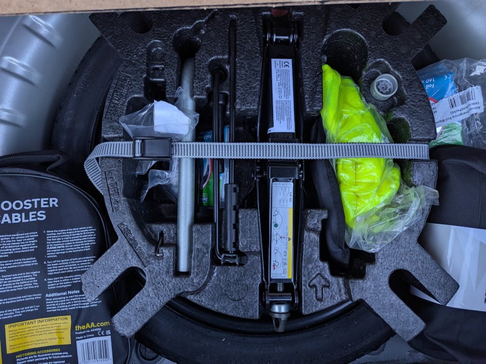

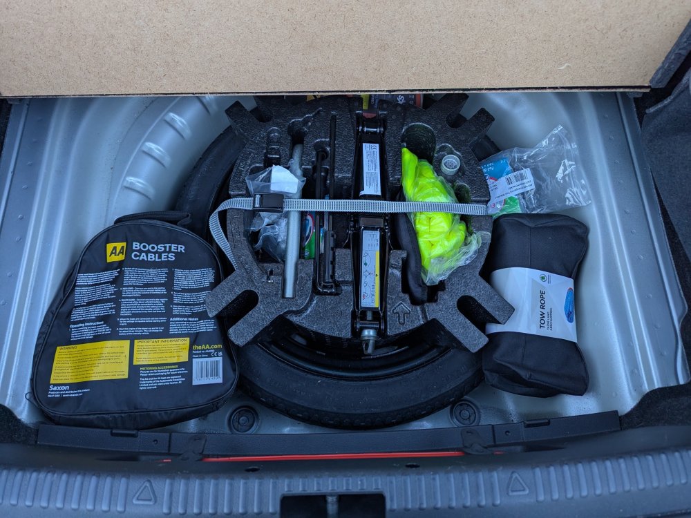

Here's my spare wheel and toolkit in my mk3 VRS
It contains:
- Screwdriver
-  Locking wheel nut
- Towing eye
- Clamps for removing the wheel trims
-  Jack
- Crank for the jack
- Wheel brace
Looking at the owners manual, i was missing three items, which I ordered off skoda parts:
8D0012244A wheel bolt cap remover
6H0867749 strap
3T0012245 tail light key
The strap fits great.  I'm not sure where the bolt cap remover and tail light key fitted, so i shoved them in the bottom.
(For emergencies I fitted a hiviz vest, foldable shovel, foil blankets in the foam insert.  In the space round the wheel is jumper cables, skoda tow rope, Aldi fault code reader)
