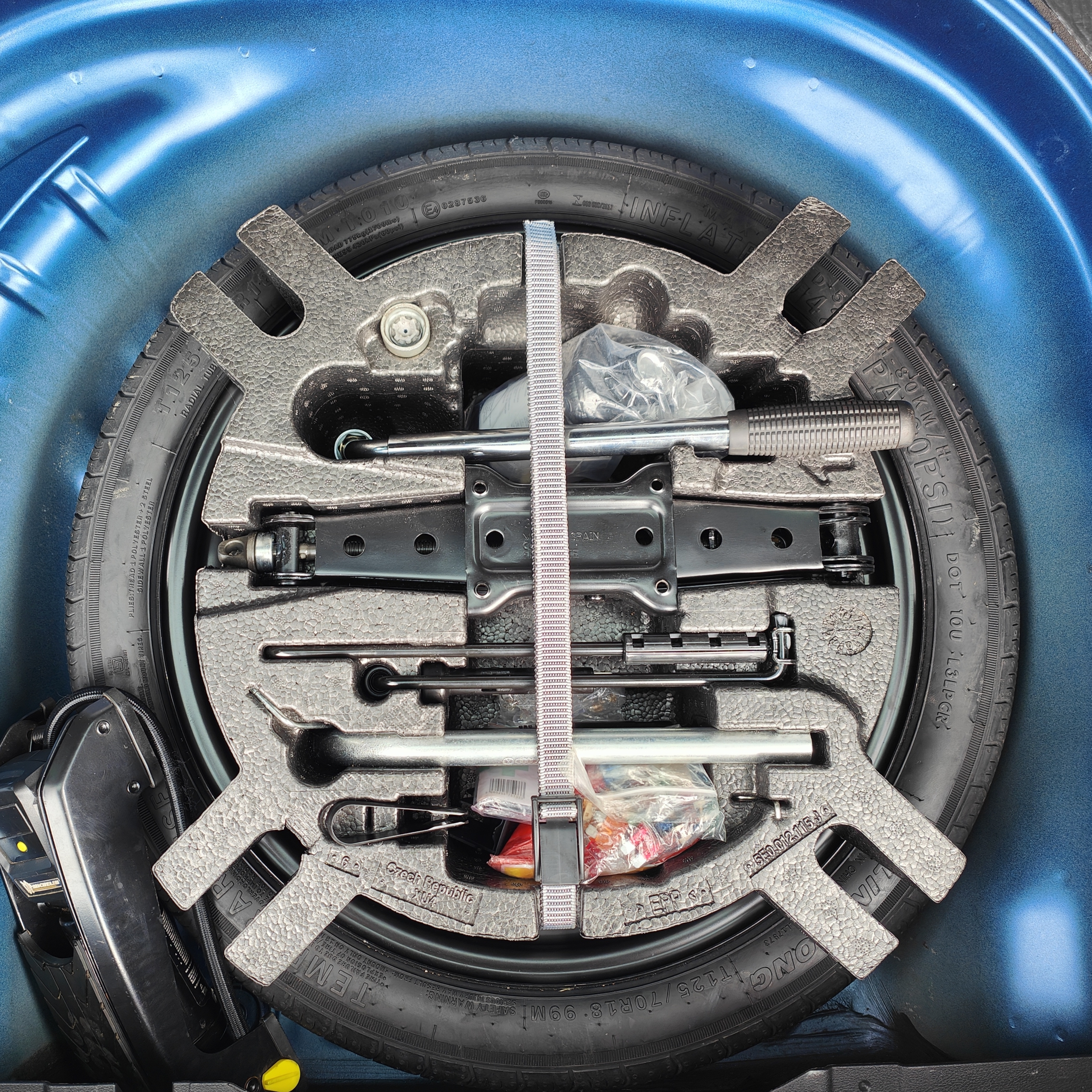

Once I figured out what size I needed (Thanks to Carlston above) I managed to get a brand new one from Facebook marketplace by looking around for £60 including the full toolkit, mines an 18" spare and fits in the wheel well fine.
Wow..looks pretty neat. i am looking for exactly same one as yours. I found some in marketplace but they are near Birmingham..Did you try to fit them? Does it fit? What is your original car wheel size and tyre spec?
Edited by automass
I have 235/45/19 tyres on original VRS Xtreme alloys (stock tyre size is 225/45/19) I figured an 18" was going to be as good as any space saver, but I *think* the lowest I can go for the front of the car is 17" anyway due to size of front caliper.
So Skoda being VAG pretty much any VAG space saver in the right size will be ok. If you follow the rules for the sizes above that Carlston posted you should find one from a VW or Seat also as they will use the same part numbers. Audi use a different hub diameter so wouldn't fit generally.
I considered getting a full size 18" spare, there would probably be space for this diameter wise but the width of the alloy I think would restrict the boot floor from closing properly, especially with the toolkit in.
What's that bottom left corner (black thingy)? is it inflator?
It's just a footpump. I also now carry a basic tool kit for just in case situations.

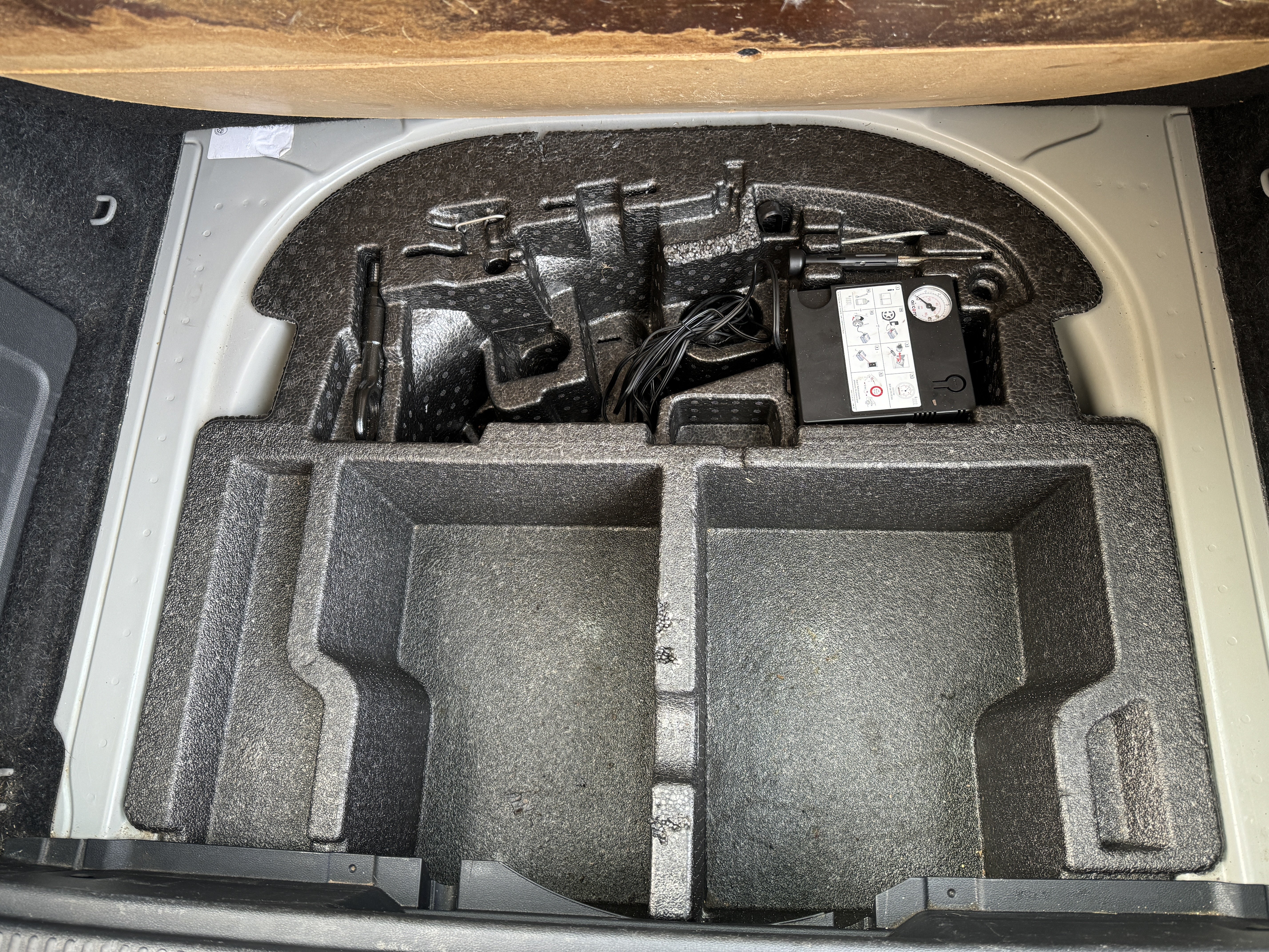

Hi, I have recently bought a 2017 Octavia VRS TSI - Can the lovely people of this forum tell me what items are missing from this photo please? - I'd like to acquire the missing items. Or potentially swap out the insert for a spare and toolkit.
Thanks in anticipation!

19 hours ago, JasonMew said:
I have recently bought a 2017 Octavia MK3 VRS TSI - I'd like to acquire the missing items. Or potentially swap out the insert for a spare and toolkit.
You can order a spare wheel kit from any VAG parts department using OEM part number 5E0093860F.
The kit includes everything except for the actual space saver spare wheel, which would need to be ordered separately.
I suggest you first order just the spare wheel kit (without the actual space wheel). Then you can work out if you can fit a full size spare wheel. As you have a VRS facelift, you will need at least 17" rims to clear the front brake calipers. I doubt you would have enough room for a 225 tyre width, but maybe a 205/50R17 fitted to a 6.5Jx17 ET49 5/112 57.1 steel rim (from a VW Caddy 2020 onwards) would fit...but there might only be enough room for a space saver spare wheel.
Spare wheel kit for the Octavia MK3 VRS (includes everything except for the actual space saver spare wheel) 5E0093860F (1479CZK is about £50)
18" Spare Wheel Replacement Kit
https://eshop.skoda-auto.cz/cs_CZ/sada-pro-vymenu-rezervniho-kola-18/p/5E0093860F
