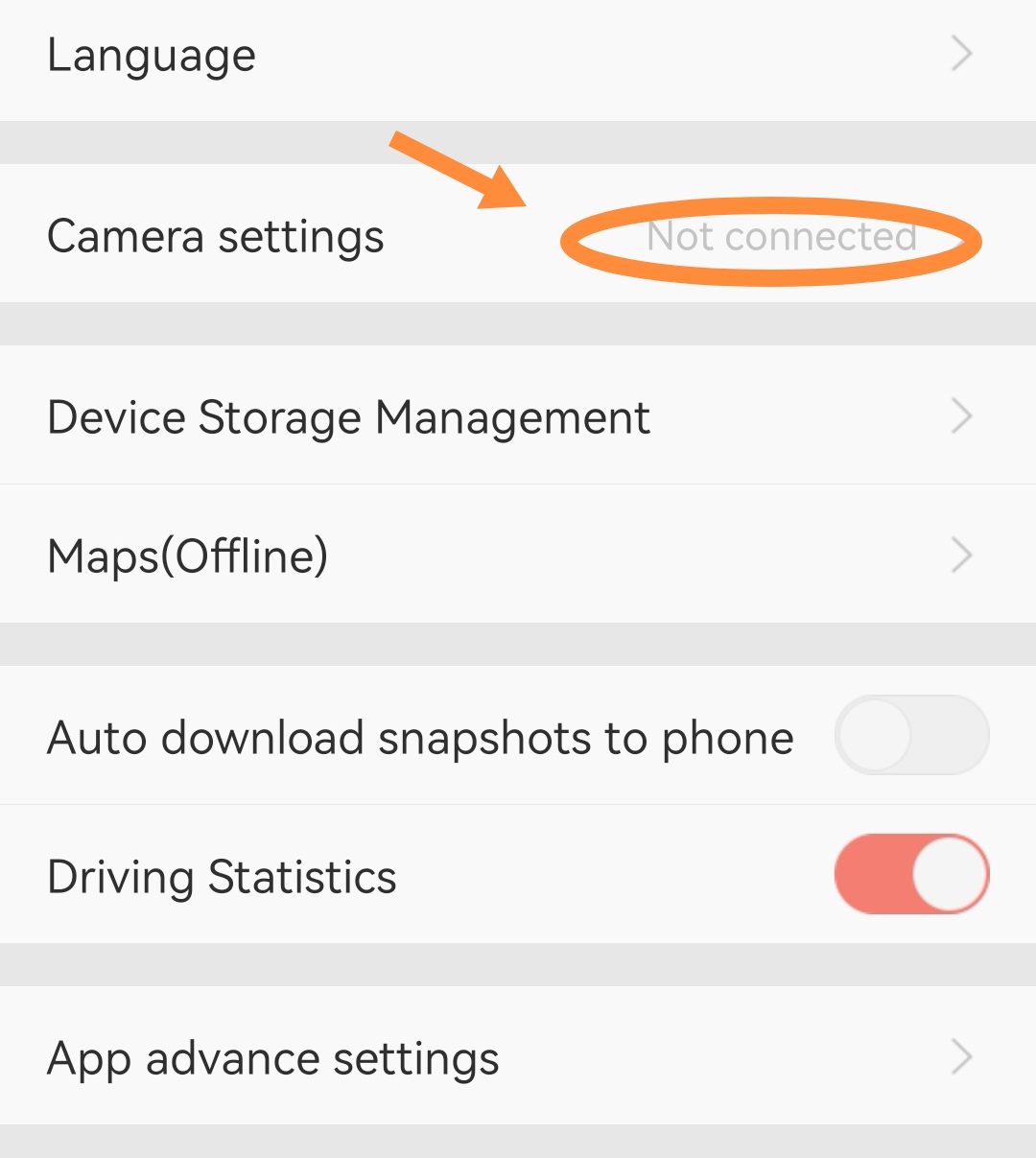

And therein lies the rub!
It is only possible to access camera settings once the app is connected to it via Wi-Fi.
Screenshot_20230913_163718_edit_123047084773411.thumb.jpg.645566f57af5db2ff4936e181aff3ad9.jpg
