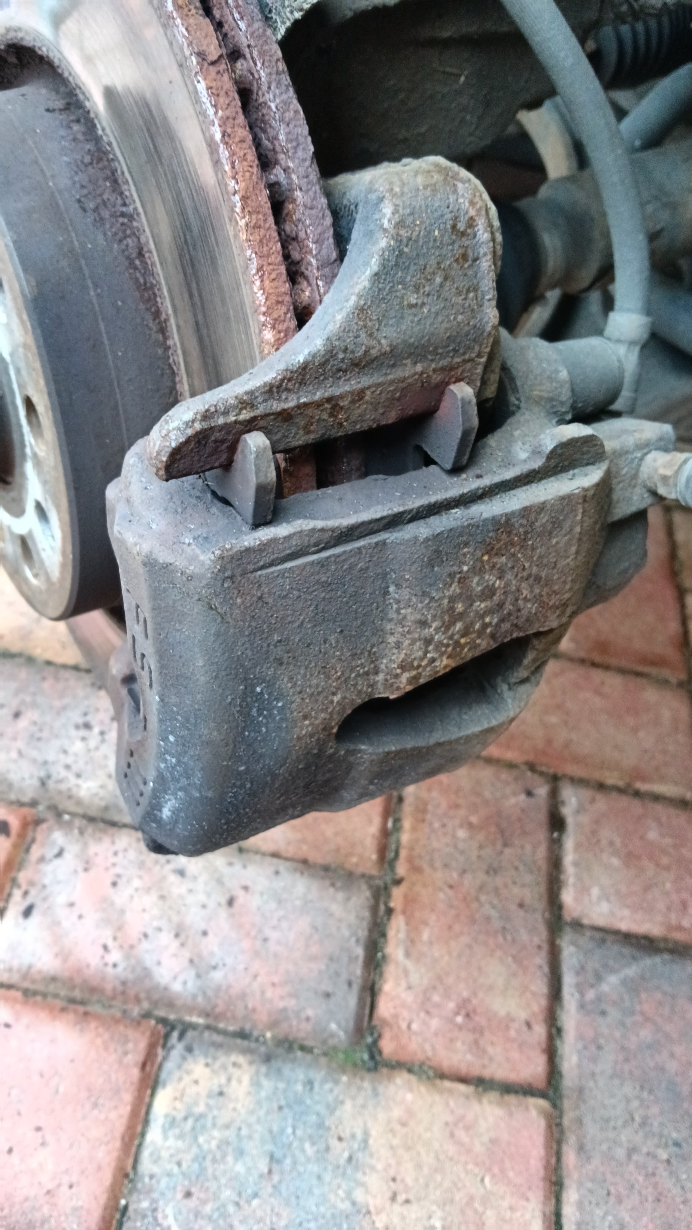

Confirmed that it's the smaller disc, after comparing images and FS III clearly cast into the calipers.
Thanks to Carlston and MicMac.

Picture and FS III cast into caliper confirms smaller disc.
