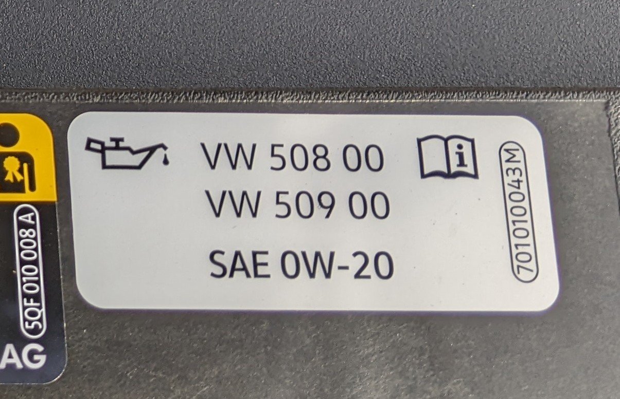

Is there nothing like this in the engine compartment?
image.webp.b48e6771853b15b770e956a10ec5660b.webp.2721e5e275bfd9c6b35e39bef234c58e.webp
1872327318_972195316_Screenshot2019-07-21at16_37_00(3).webp.50641ab517e18486d2a3840fbc61abdb.webp.a958cfdbadb3bb783edc2bad01b2ea3e.webp

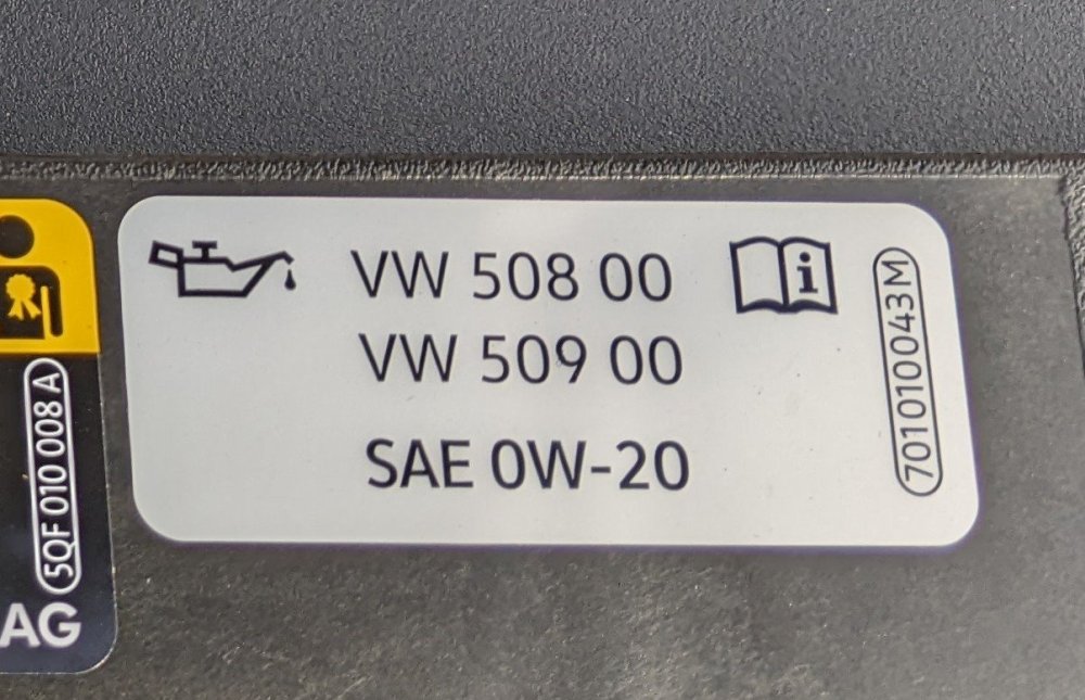

Thanks, that's really useful info.
It's a 1.4 and I'll check for the label in the engine bay tonight.

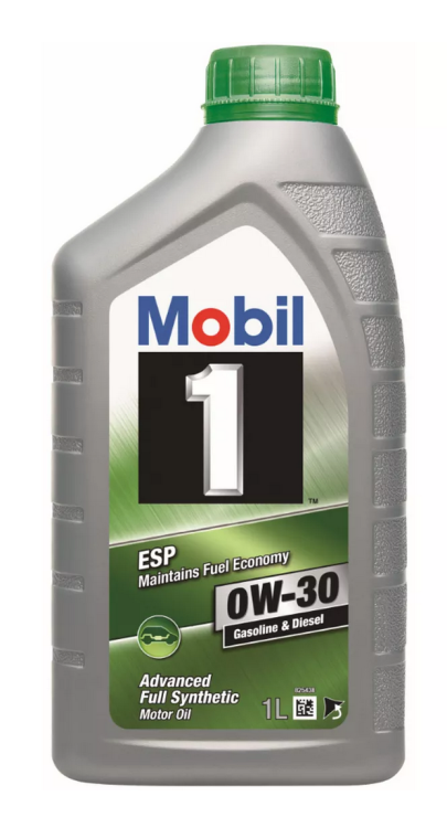

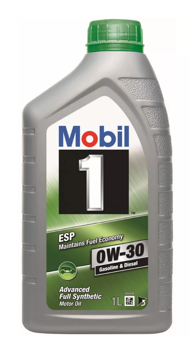

How about compromising and using 0W/30 oil? 😊
