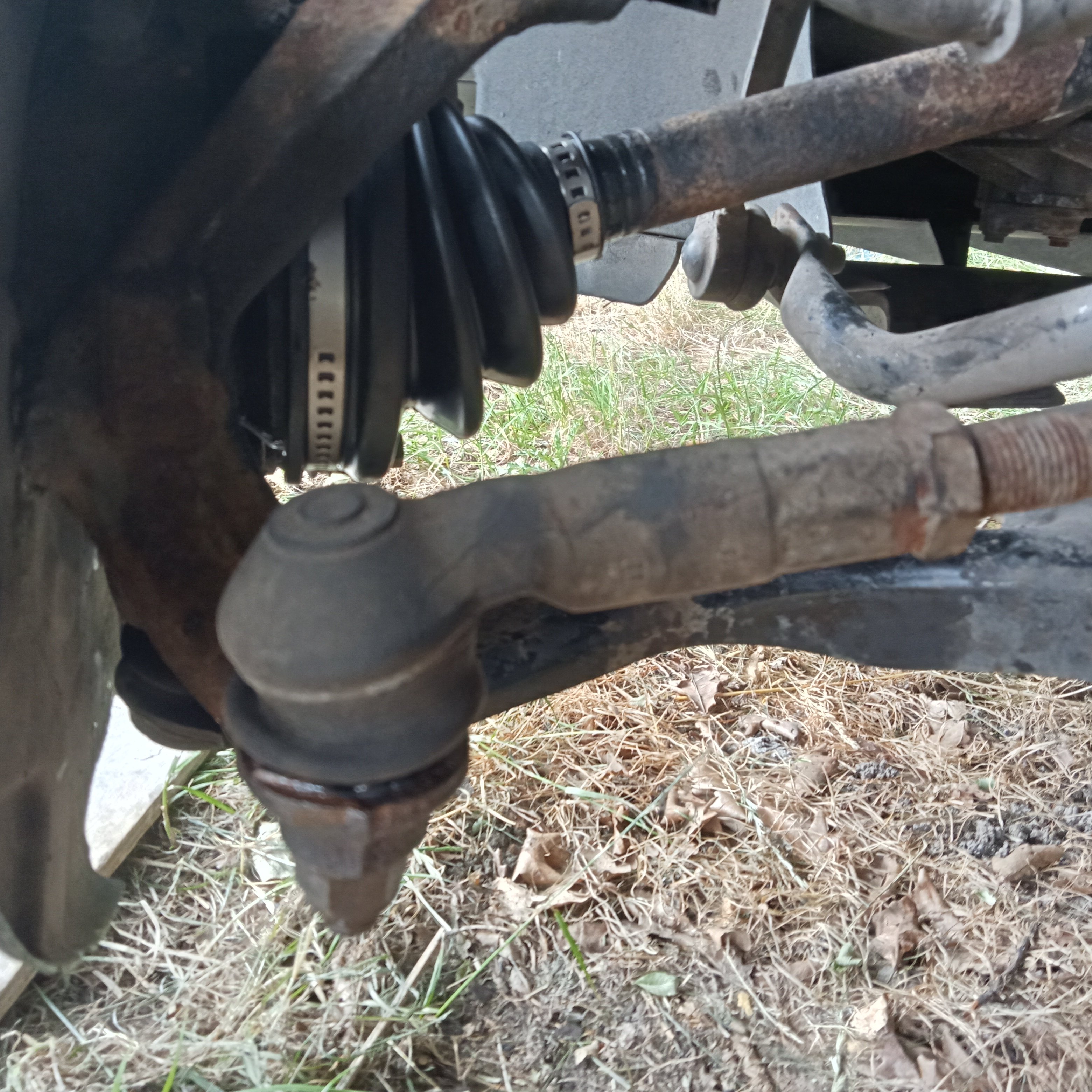

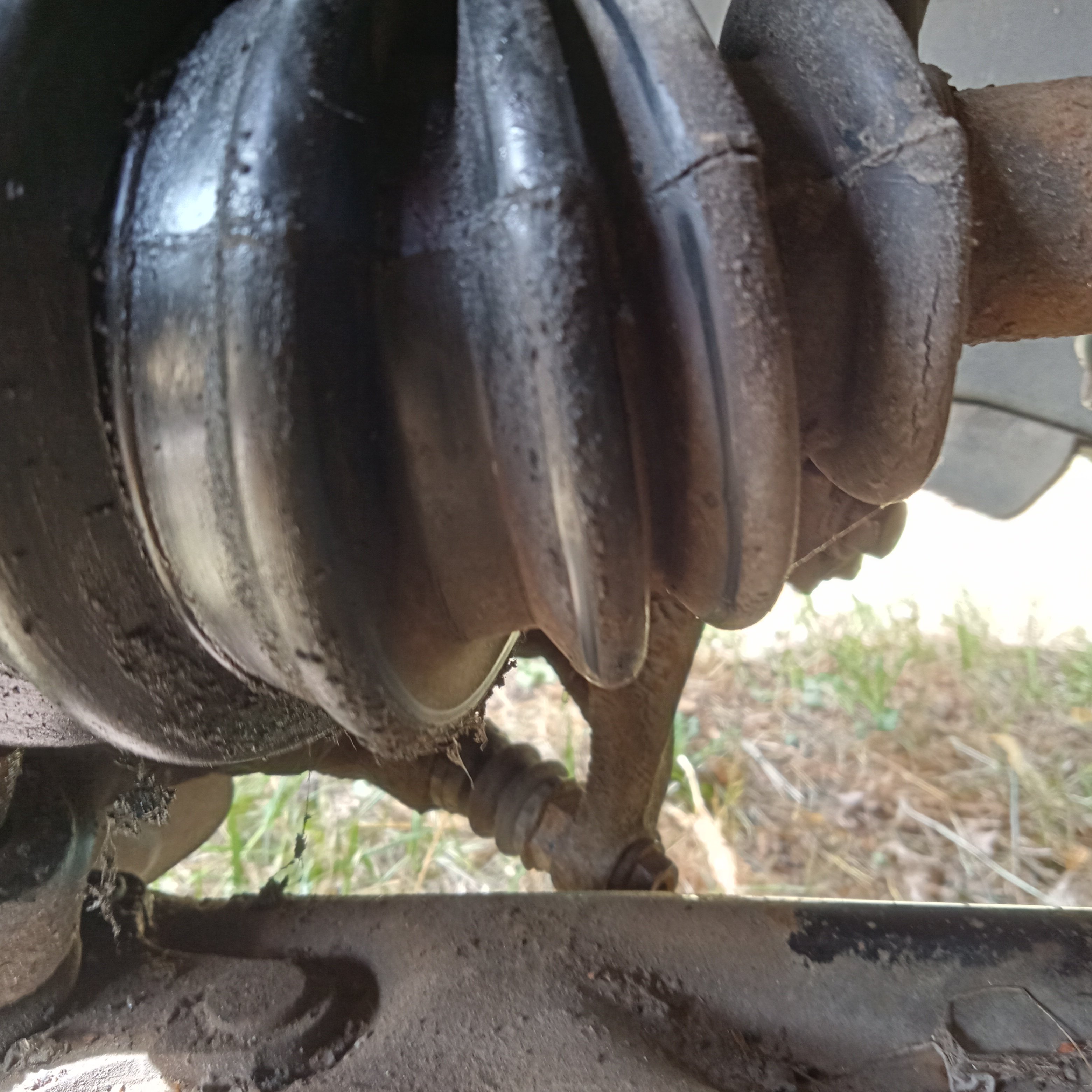

Just fitted this to father's Octavia on monday. By using a split boot I was trying to save time by not having to remove the hub ect. ect.
Didn't save too much time because of the limited space caused by components still being in situ.
Also I did have an issue in that the joint end of the boot isn't a tight fit over the joint because of the universal nature of the boot, which the slack of which has to be taken up by the clip. But the glued joint seems to be holding up so far.
Still probably saved £100 on dealer costs.
If I can remember I'll keep updating on the long term reliability, in case others want to fit one.IMG20230925124356_BURST001_COVER.thumb.jpg.dadf104efdd0b6cc7f7ace4506e8446a.jpg

Did you take the photographs before fitting the clips?
How do you avoid the glue joint becoming contaminated with the CV grease when you wrap it round the shaft in such a confined space?
Yes, as you can see the clips aren't installed in the photo.

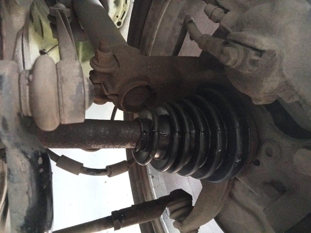

With great difficulty, I was lucky in that quite a lot of grease had escaped from the old boot, so there wasn't as much to contend with. The seam gets glued together in stages, after it is stretched over the driveshaft, so it's not as awkward as it would be if it had to be done all at once. But I could have cleaned the grease away first then re-packed the joint after the boots seam was stuck together.

Thanks for the explanation, I had incorrectly assumed that the joint would be glued with the gaiter in its fitted position, that would be the reason that its such a loose fit but the tywraps or clips should take care of that.

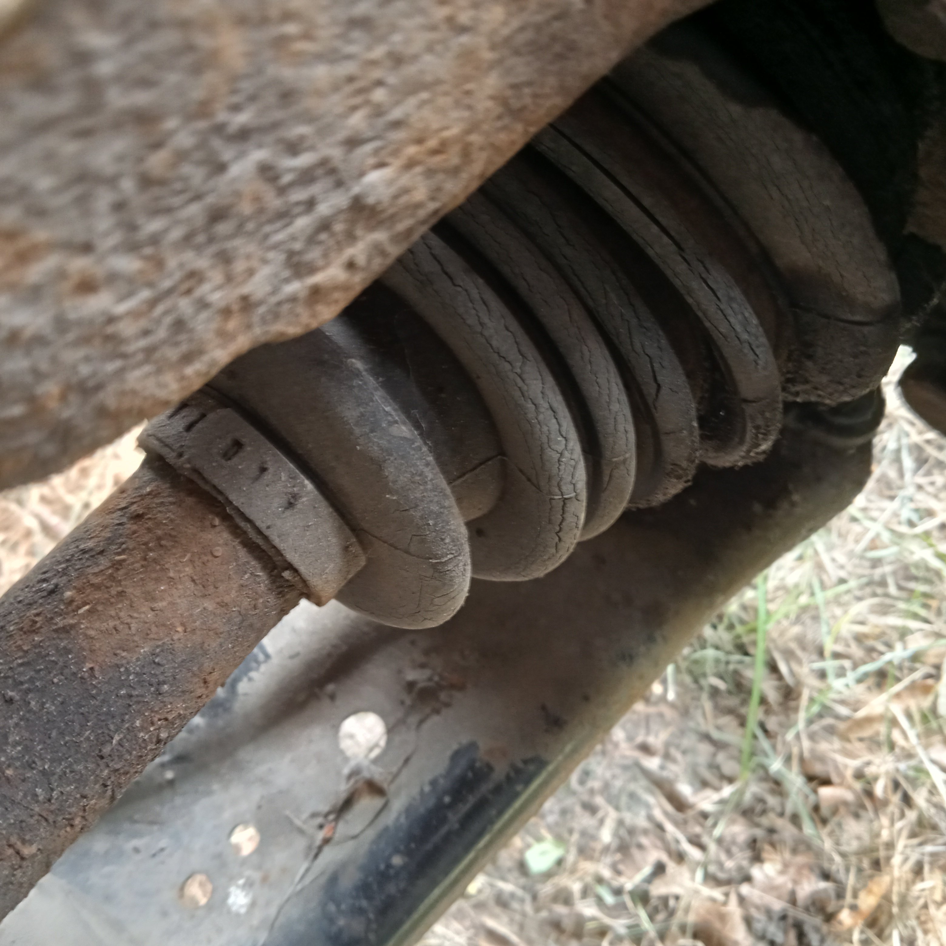

So as promised an update:
It would seem that it has started to leak again, by the looks of it part of the glued joint has separated. But even the rubber of the boot seems to be degrading after just a year.
I'd say that they are only good if you need a quick fix, say for a last minute MOT pass, or if the driveshaft can't be split due to seized nuts, otherwise there's no point.
Now I've got more time, I'll be fitting a normal one.

After a little cleaning it's only a little pin hole split, I could have probably fixed it with the glue that comes with the kit, but my father thew it away.
Edited by R_U_AFA
Spelling error
It's quite hard to see the spit in the pic
But there is some degradation of the rubber, with cracks.
So a replacement it is.

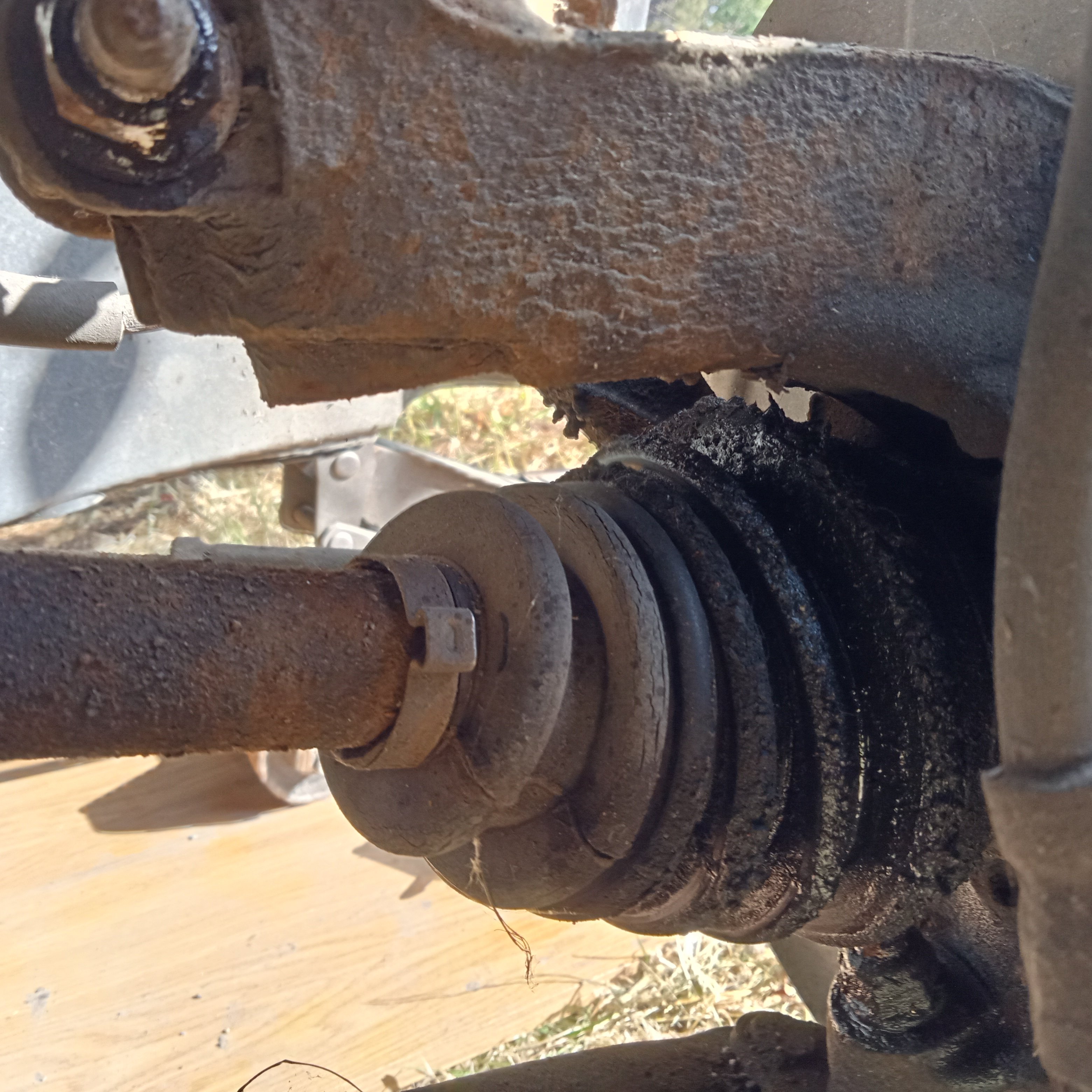

What a pain that was to replace, nothing seems simple on these cars, well not compared to the Felicia anyhow, on that the CV joint just taps off, it can generally just be pulled off by hand. I'd have never have thought off separating the joint this way so a special thanks goes to the creator of this vid (probably a well known trick, but I was stuck at this point)
After fitting the standard boot, the split CV boot does save a LOT of time, and your back as these hubs are heavy and take some manhandling to get the driveshaft back in.
So in conclusion I can't really give a definite answer on whether to use a split boot or not, just that the quality of the one I used was dubious.
