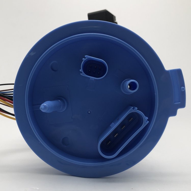

Hello, I need help installing a high-power low-pressure pump on my vehicle for a Stage 2 E85 flexfuel project. However, I'm having great difficulty finding a solution. I purchased a Bosch 0580200392 pump and a Bartek 590LH kit. assembles but as it is for type GOLF 7R the fuel gauge does not work it does not seem to be the same type because the tank is different, after several in-depth searches it seems that the VW ARTEON 280 / VW PASSAT B8 and SKODA SUPERB 3V 280 share the same platform with a specific pump and the same tank, my wiring concerning the fuel gauge is 3 pins, it seems that after several searches my car model is only compatible with a low pressure pump from Audi RS3 and that there is a plug & play wiring harness. https://scskunkwerks.com/en-gb/products/awd-mqb-rs3-pump-hardware-and-harness-kit?variant=47121984880961
https://scskunkwerks.com/en-gb/products/brushless-rs3-low-pressure-fuel-pump-upgrade-for-awd-mqb
If you know how to install it, please let me know which pump/harness I should purchase to install a high-power, low-pressure pump.
Thank you for your help.
Kind regards,

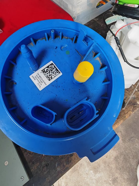

Hi
The Superb/Passat/Arteon 280 share the same LPFP as the RS3 so it simple to plug it and it works. I bought the same kit from SC Skunkwerks, recieved a great service.
What power are you aiming for? The stock LPFP is good enough for over 500bhp unfortunately we never tested it to the limit however the tuner said there was capacity to push it further.
Edited by Awesam
Thank you very much for your help Awesam so I have to buy an original RS3 8V bp pump, reference 8V0919087A but for the wiring how to proceed because mine is original on the Skoda the power supply of the pump is 2 pins (RS3 4 pins) and the fuel gauge is 3 pins (RS3 6 pins)
We can see in picture the différences of connectors, and for the fuel level its working ? No error on fuel level sensor résistance ohm ? Thxxxxx

You need to buy this harness: AWD MQB RS3 Pump Hardware and Harness Kit – SC SkunkWerks
to make it work and there were no errors, the Engine Builder put it all in and started the car no issues/errors at all, you will need use the RS3 LPFP fuel controller.
As you have the LPFP, I may have the a wiring diagram so you could make the wiring loom yourself.
I had the issue with the LPFP initially aswell then I become the guinea pig to test if a RS3 LPFP would fit in a Superb, fortunately for me it worked!
Bosch 980cc MPI's are really needed if you arent going to exceed 550bhp however ever little bit helps. Supersprint is crazy expensive!

Thanks a lot but it seems the article is sold out on the site but i think this one is the same : https://www.hpamotorsports.com/products/hpa-mqb-ea888-gen-3-brushless-in-tank-fuel-pump?srsltid=AfmBOopZ7KVWZUH9te3yJipYgYt7AygOU_jKW3DPwf2DSwm3zhOPYIZJ what do you think about ? I need to find a site where it can ship to Europe France, can you send me the picture of the wiring more clear i can not see the figure. Thanks
EQT Standard Brushless LPFP - VW/Audi MQB/e 1.8T/2.0T – Equilibrium Tuning, Inc.
They are good also.

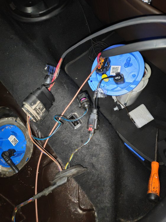

@Awesam
Hi mate,
I hope you’re doing well and thanks again for all the details you shared about your RS3 brushless LPFP swap on your Superb — your post has been super helpful!
I’m currently installing the same setup on my Skoda Superb 2.0 TSI 280 (EA888.3) using the EQT brushless RS3 pump and harness, but I’ve run into two issues I’d like your advice on:

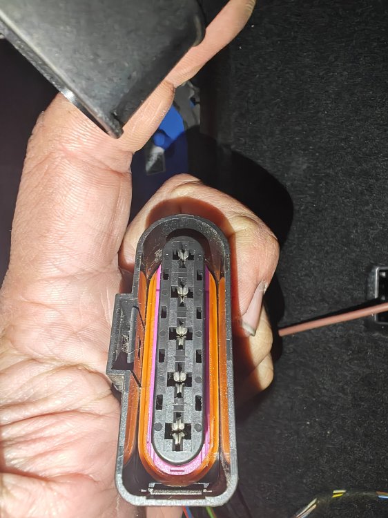

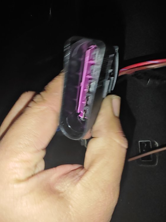

1️⃣ Main 5-pin connector fitment
On my car, the OEM 5-pin connector doesn’t seem to lock mechanically into the black 5-pin connector from the EQT/RS3 harness — it looks like the keying tabs or guides are slightly different.
Did you encounter the same issue when you plugged in the harness?
Did you have to trim or modify the connector housing in any way, or is there a specific orientation to make it fit?

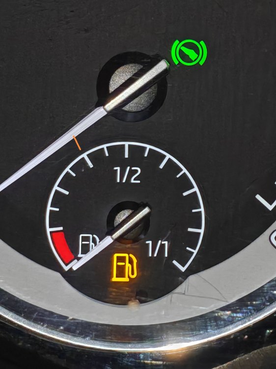

2️⃣ Fuel level sender calibration
The fuel level sensor is working, but it reads too low.
When the float is fully up (tank full), the gauge only shows about +¼ of a tank on the cluster. (Orange line on the picture)
it seems like the RS3 sender uses a different resistance curve.
Did you face the same problem, and if so, how did you fix it?
Was it solved automatically once everything was wired with the controller, or did you need a coding/calibration change?
If you still have a clearer copy of your wiring diagram, could you please send it to me directly?
It would really help me confirm all pin positions before final assembly.
Thanks a lot for your help mate — your build thread has saved me a ton of trial and error already 🙏
Best regards from France

Hi my engine builder said he just plug it in and it all worked. I will ask him and see if he can shed any light on your issues.

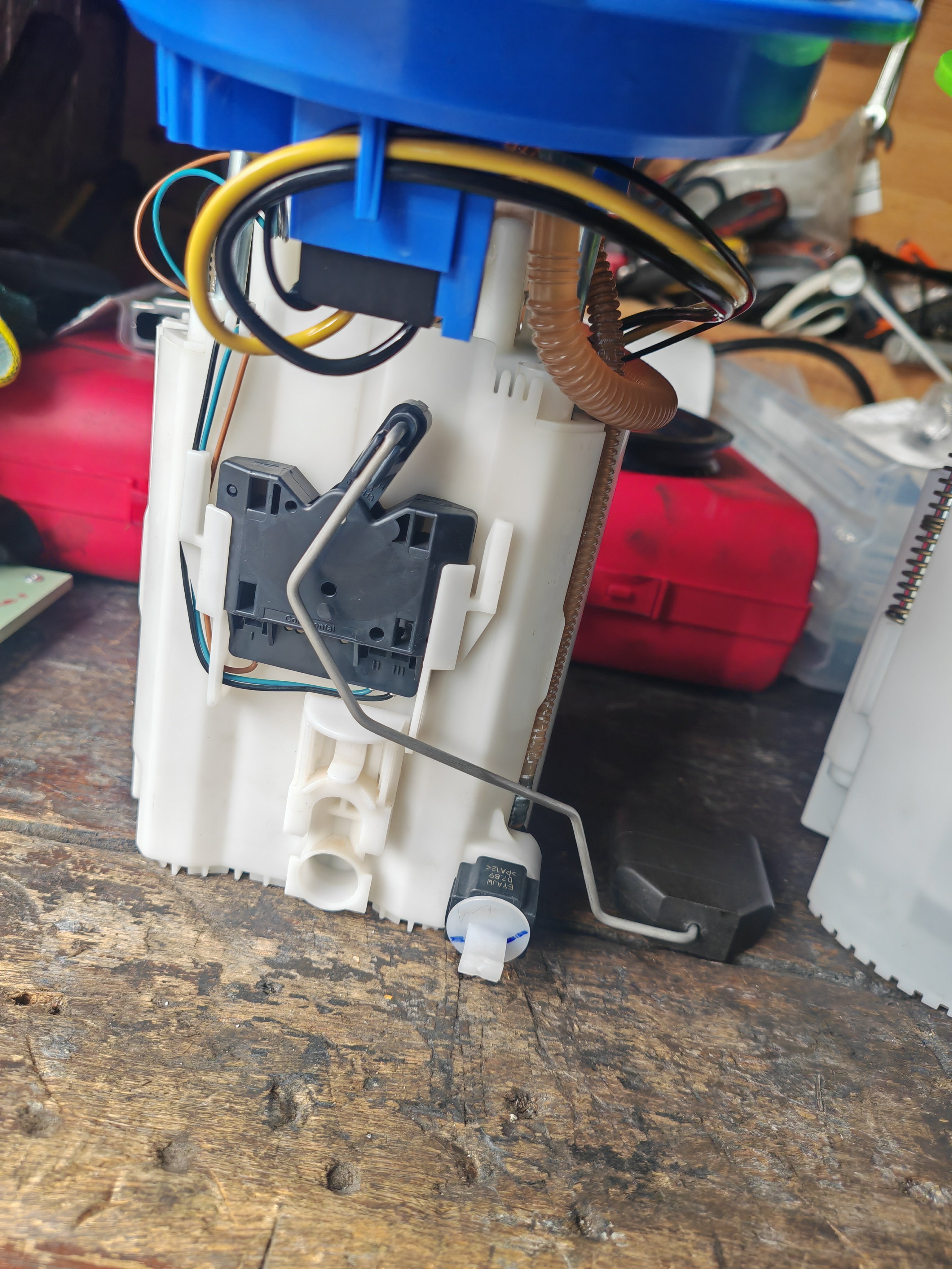

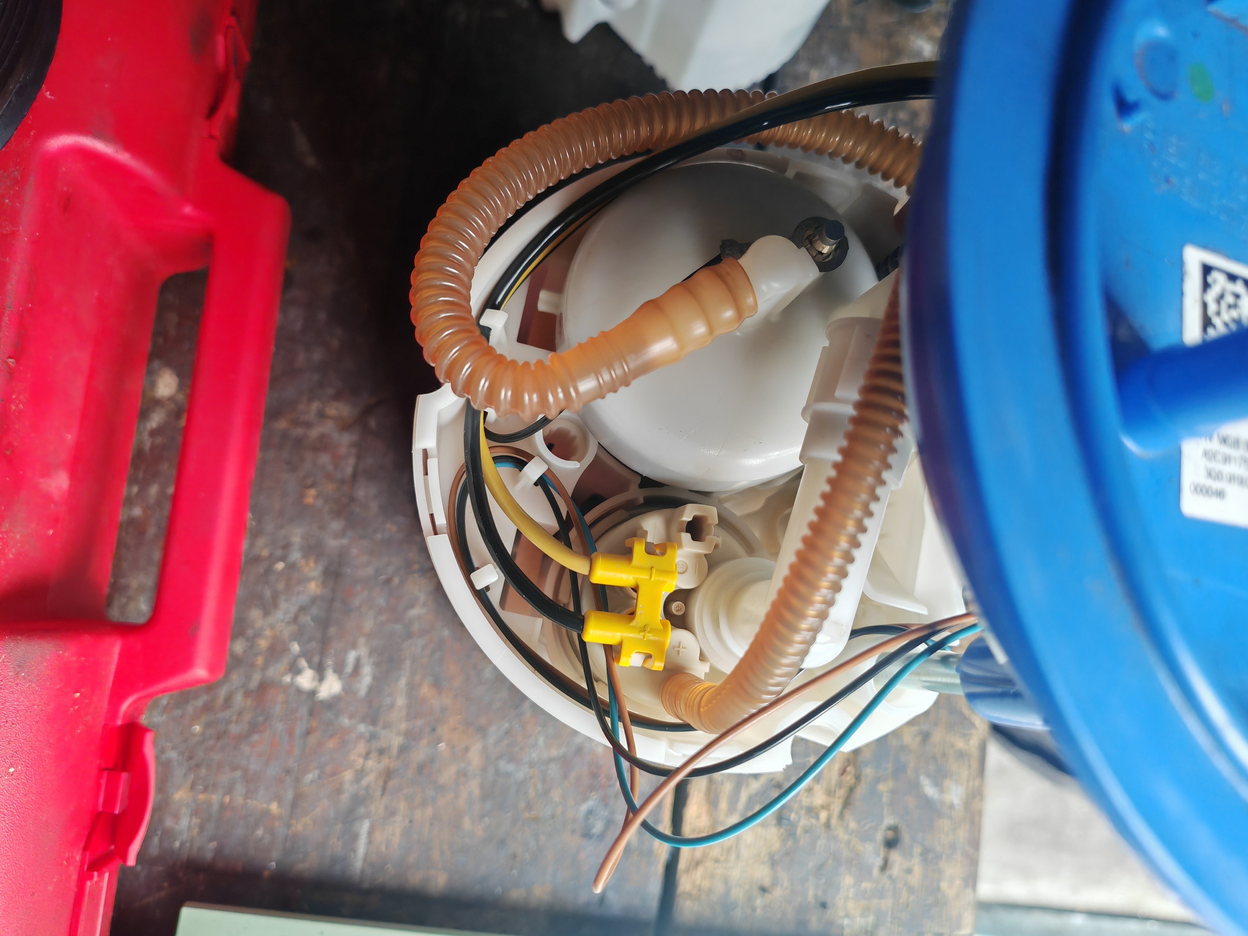

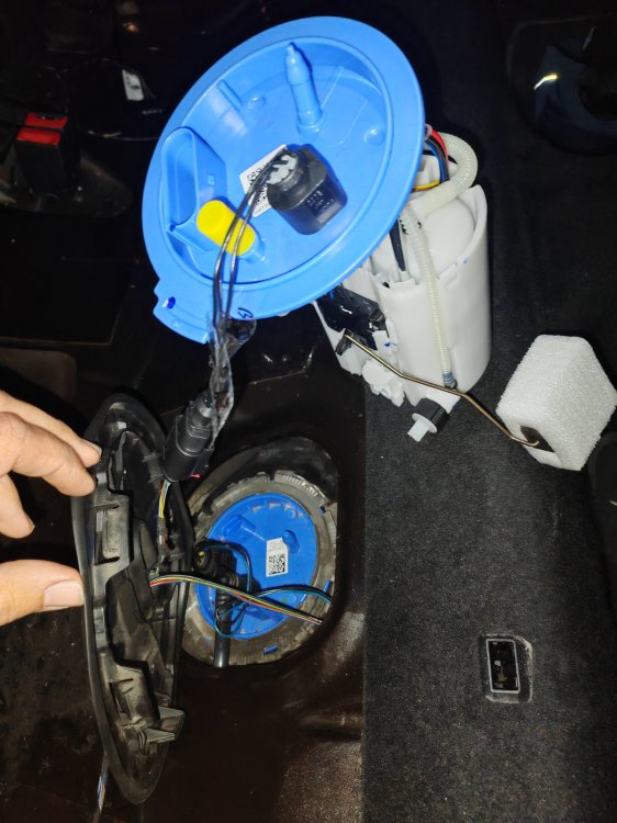

Hi thanks a lot, Thanks for your feedback, and otherwise, could you unclip your rear seat and take some pictures of your setup?
22 hours ago, Awesam said:
Salut, mon préparateur moteur m'a dit qu'il l'avait simplement branché et que tout avait fonctionné. Je vais lui demander s'il peut m'éclairer sur tes problèmes.
@Awesam
Hey mate,
I think I’ve just figured out part of the issue with my fuel gauge reading too low during testing.
On the Skoda Superb 3V, the fuel tank has a “saddle” shape (split into left and right sections).
The right side (passenger side) houses the main pump module with the primary level sender (the one integrated into the RS3/EQT brushless assembly).
The left side (driver side) has a secondary sender unit — it doesn’t pump fuel, but it contains another float and a siphon/jet system that transfers fuel to the main side.
Both level sensors are electrically linked and their readings are combined by the instrument cluster to display the total fuel level.
So when I was testing the new EQT RS3 pump by itself, with only the main right-side sender connected, the gauge only went up to about ¼–⅓ full, even with the float fully raised.
That actually makes sense now — the cluster was missing the signal from the left sender.
Once both senders (left + right) are plugged in, the gauge should display the full combined value correctly.
So I’ll finish the full installation and retest everything with both sides connected before suspecting any calibration or resist
ance mismatch.
@Awesam
Finally, I managed to connect the pump; it is indeed plug and play. The connector on the pump side had the pink tab inside slightly misaligned; I put it back in place. Now everything is in order, the pump works well. I have an appointment with the tuner Fredautosport in a few days for the configuration. So, I have a VWR R600 intake, large volume inlet & outlet turbo, GFB DV+ dump valve, Autotech kit on HPFP, EQT RS3 type brushless LPFP. The next modifications are a Wagner Tuning downpipe and intercooler. I found a downpipe reference; what do you think, Awesam?
