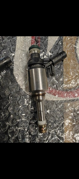

Thank you very much, I would really appreciate having the links. Currently, the power I have suits me fine, and with the RS3 FSI injectors, 980cc MPI, Autotech HPFP, and RS3 LPFP, it's oversized and therefore durable. The only problem is the gearbox; that's the only thing I want to fix now. With your solution, can I find TCU maps from TVS Engineering? Thank you.

Btw I think rs3 di inkectors are same as ours. Do you have ref number of rs3 inj?

Hello my reference is 07K906036N RS3 8V5 FSI injectors

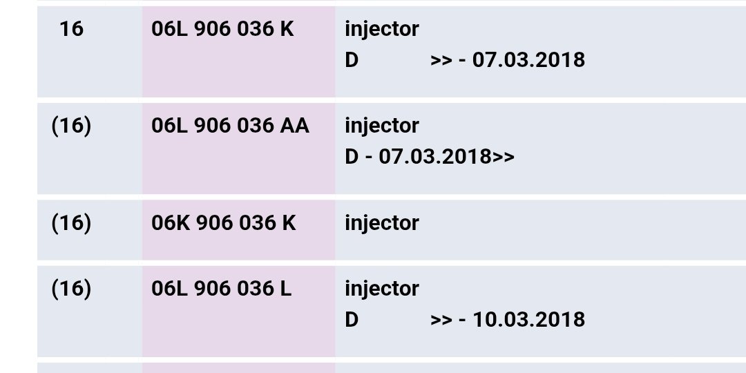

Doubt there will much difference to the standard injector as the parts number is 06K906036N or 06L906036
As I see, 06K...N is fot 272 engine, as well as R, TTS,...
06L...AH last revision is for 206kw CJXA and there is bosch replacement for that one.
Akstuning:
"These injectors are the part number from GPF (Gas Particulate Filter) models but will work in all 2.0 EA888 MQB platforms and offer a slightly higher flow rate over the non GPF original part numbers."
For most of the VW group parts the first digits denotes the car model i.e. 3V0 is Skoda superb or Golf R 06L or 5Q0 , then in most cases the remaining part number is the same across the mqb range
I know, but 206kw injectors starting witk K ends to AH as last revision.
And there is 06K for 200kw, first revision K, second and last revision N.
