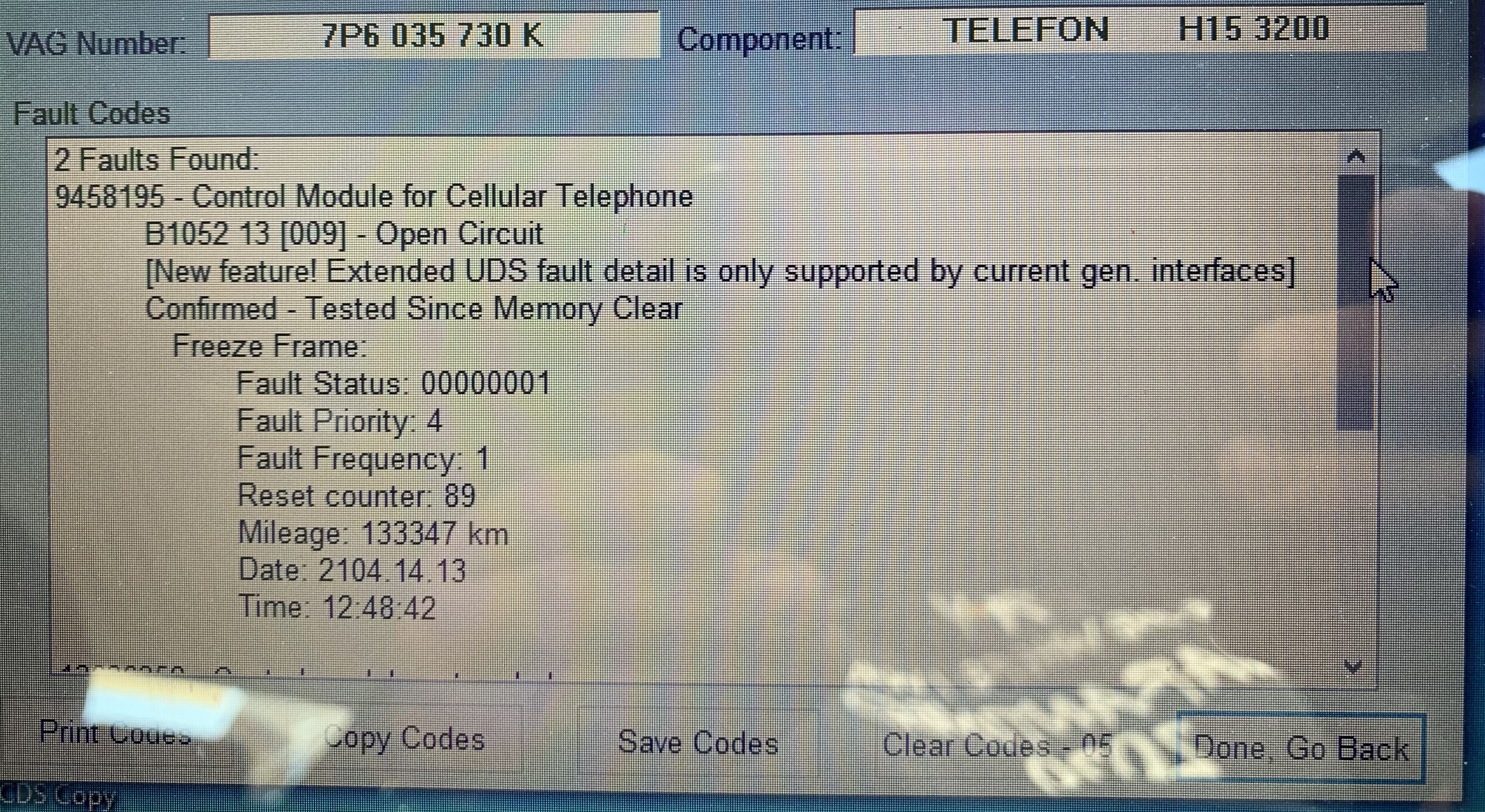

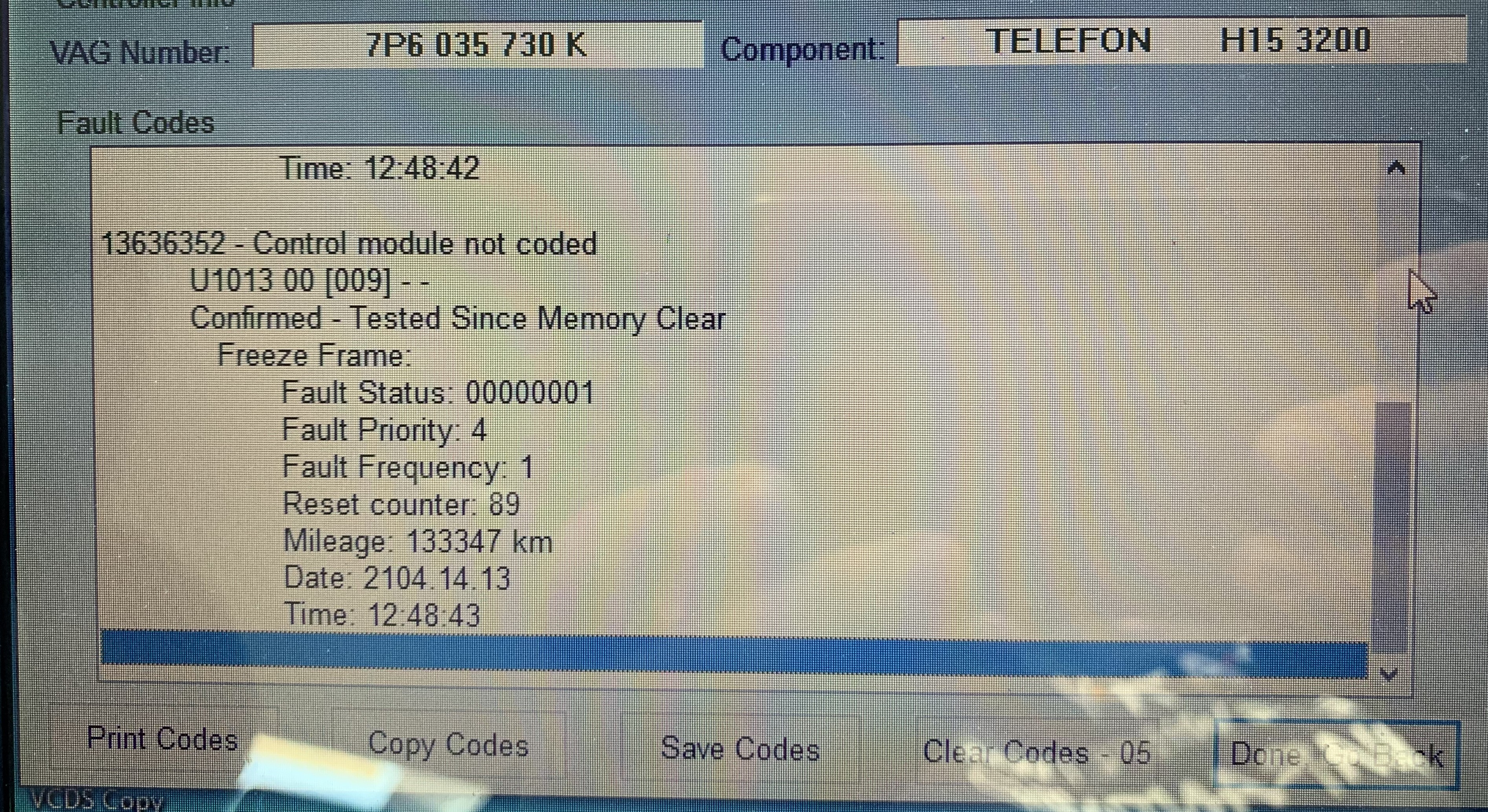

I ran a scan with VCDS, I am in no way proficient with VCDS, I just use it to scan for faults.
Two codes came up, not sure if these could be the cause of the battery drain? There is a receipt for a replacement Columbus headunit in the history file, I believe this was a like-for-like swap but no idea if it either needed coding or was coded?
