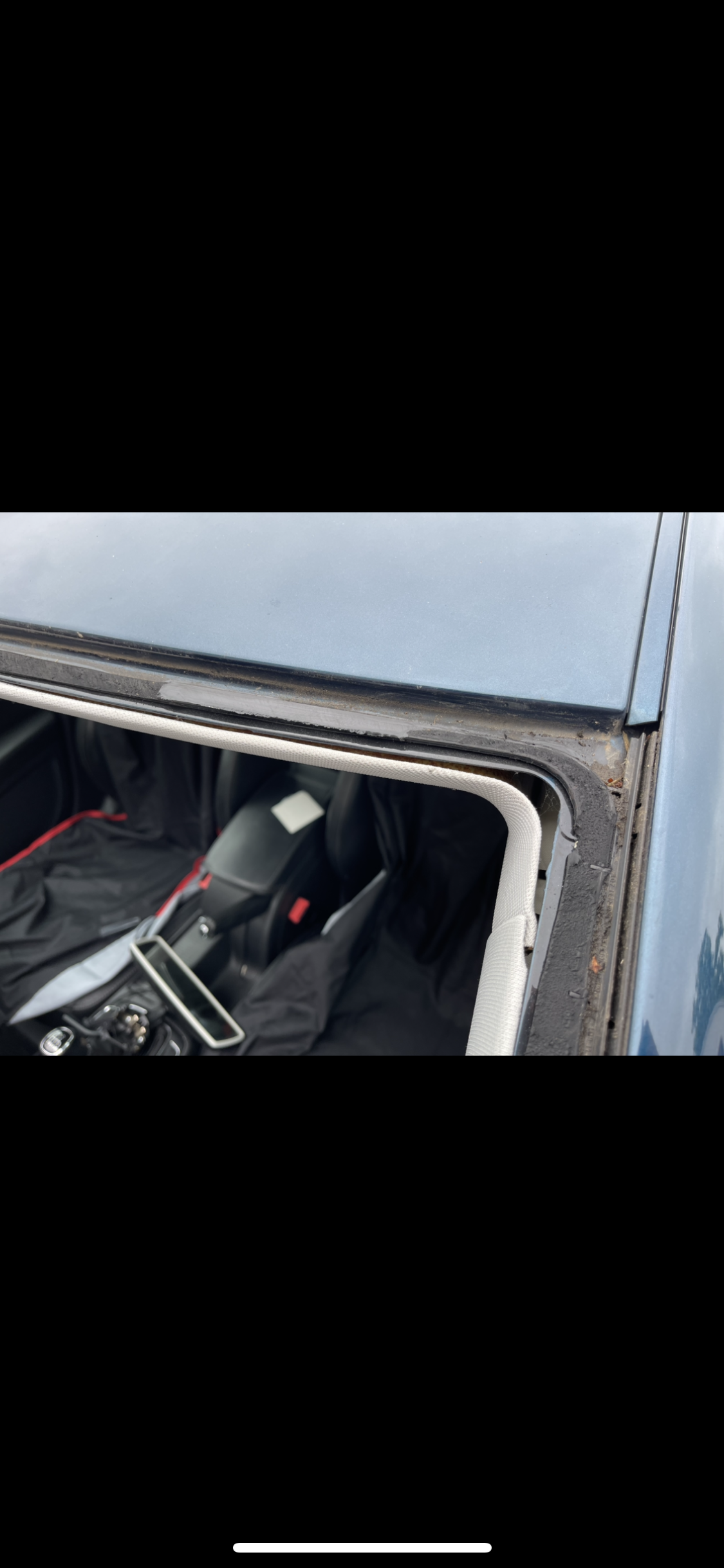

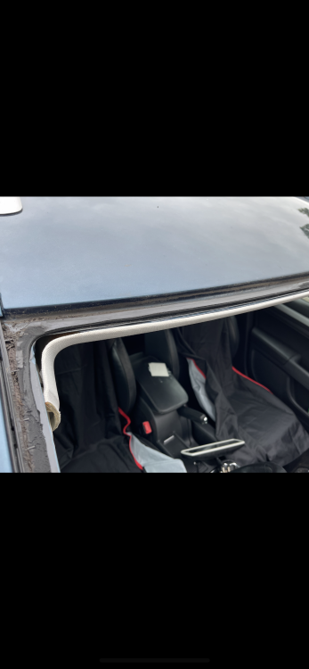

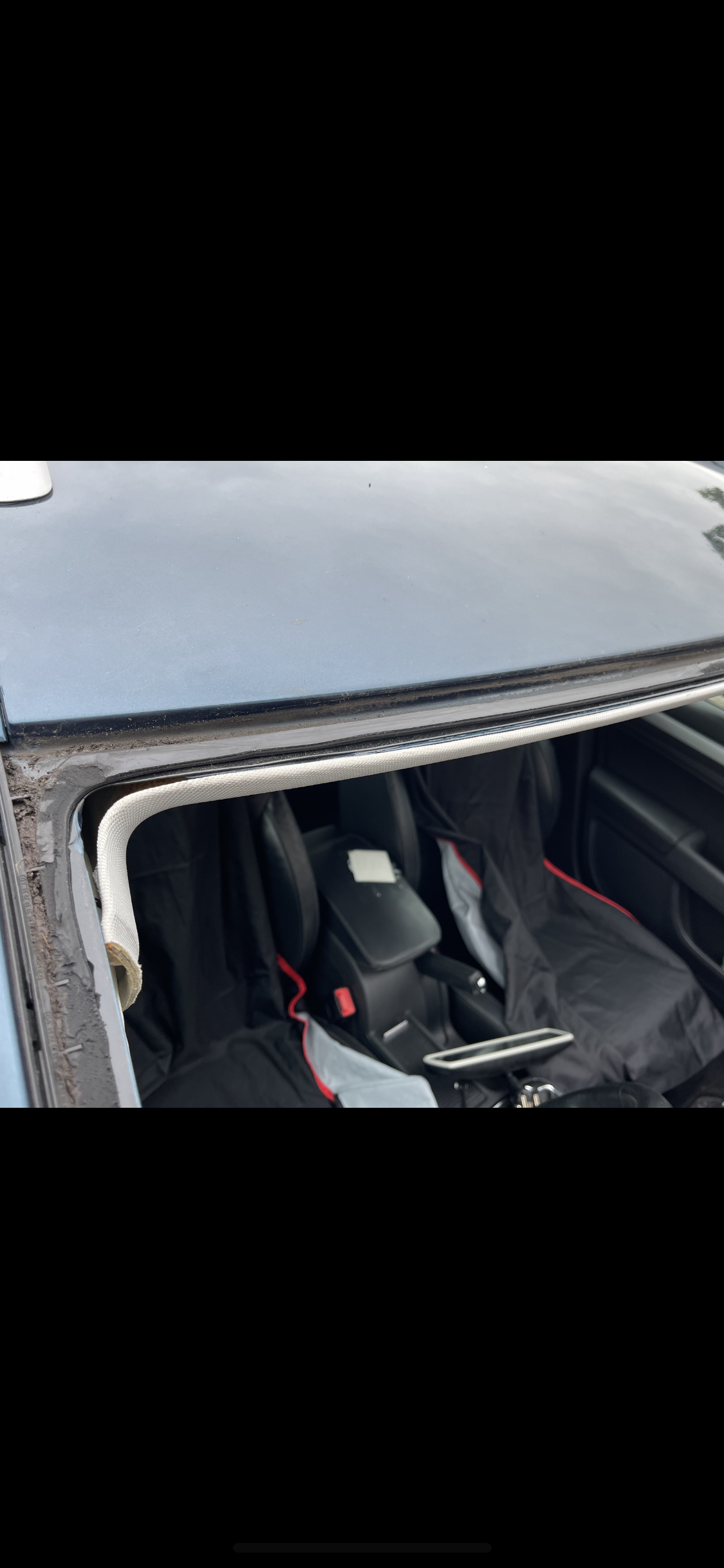

Had similar issue on our 2013 model about six mths ago. Had to have screen removed and refitted. Suggestion from windscreen specialist to effect that "we do a VW group vehicle every day of the week, they must use a dodgy adhesive, samw with Range Rovers he said" pointing to 3 x RR behind him in his workshop".
