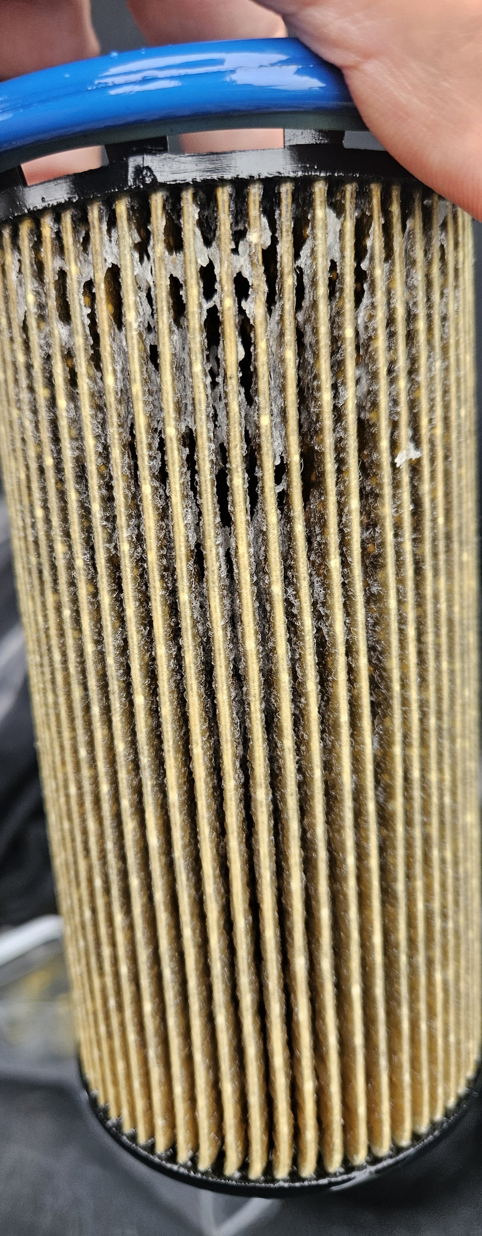

Got a 1.6tdi mk3 , driving the other night and glow plug comes on and after a few minutes I loose all power amd engine switches off
Now it won't start at all . My mechanic briefly had a look and thinks it could be bad fuel , changed the fuel filter, and still no luck at all .Here is my old fuel filter. Amy suggestions welcome

If it's bad fuel, how can changing the filter make a difference? It will be the same "bad" fuel going thru the new filter. Had you just refuelled?

Although when I had that, the filters were blocked with a black, gritty substance (almost like iron sand)
The OPs fuel filter does look like water contamination though.
Turns out the fuel pump is gunged up due to bad fuel
