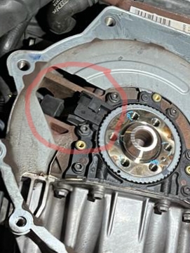

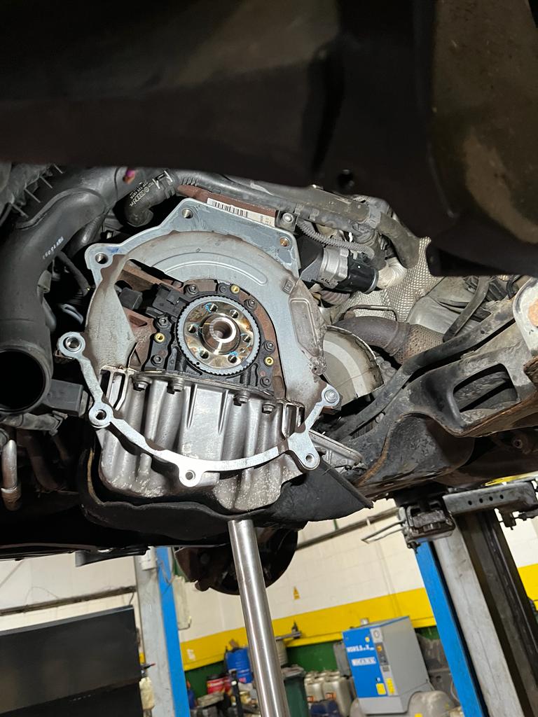

Ended taking  it to my local guy at mr clutch who removed the gearbox, big job, to gain acess to the crankshaft sensor, what a stupid  place to put it totally recessed in the casing between the engine and gearbox as per picture, hopefully no one else will need to replace theirs, car seems ok so far.👍
Not stupid, its the only place it could go, the problem is all the clutter obstructing access to it, it looks from the photo that it is removed in a radial direction and that the fixings are external and not within the bellhousing or is it the entire dark grey casing that looks like the rear main bearing seal carrier?
Surely they could have put it in a accessible place  the only way is to remove the gearbox ,other cars l have had in the past are straight forward bolt out and bolt in with easy access.
Now you have circled it it is reasonably clear that the sensor is withdrawn to the side of the engine block, the 2 bolts within the circle are for the crankshaft rear seal carrier.
You can see the hole in the engine block casting to withdraw it.
The only 2 places the sensor can be is radially around either the front or rear of the crankshaft, the rear is unhindered by cam belts, timing chains, water pumps etc and the risk of coolant or oil contamination as the oil seal is not exposed to road dust and spray.
It is where the sensor is found on most vehicles, I think torsional vibration of the crankshaft and the influence of the front pulley mounted harmonic damper is also a deciding factor.
