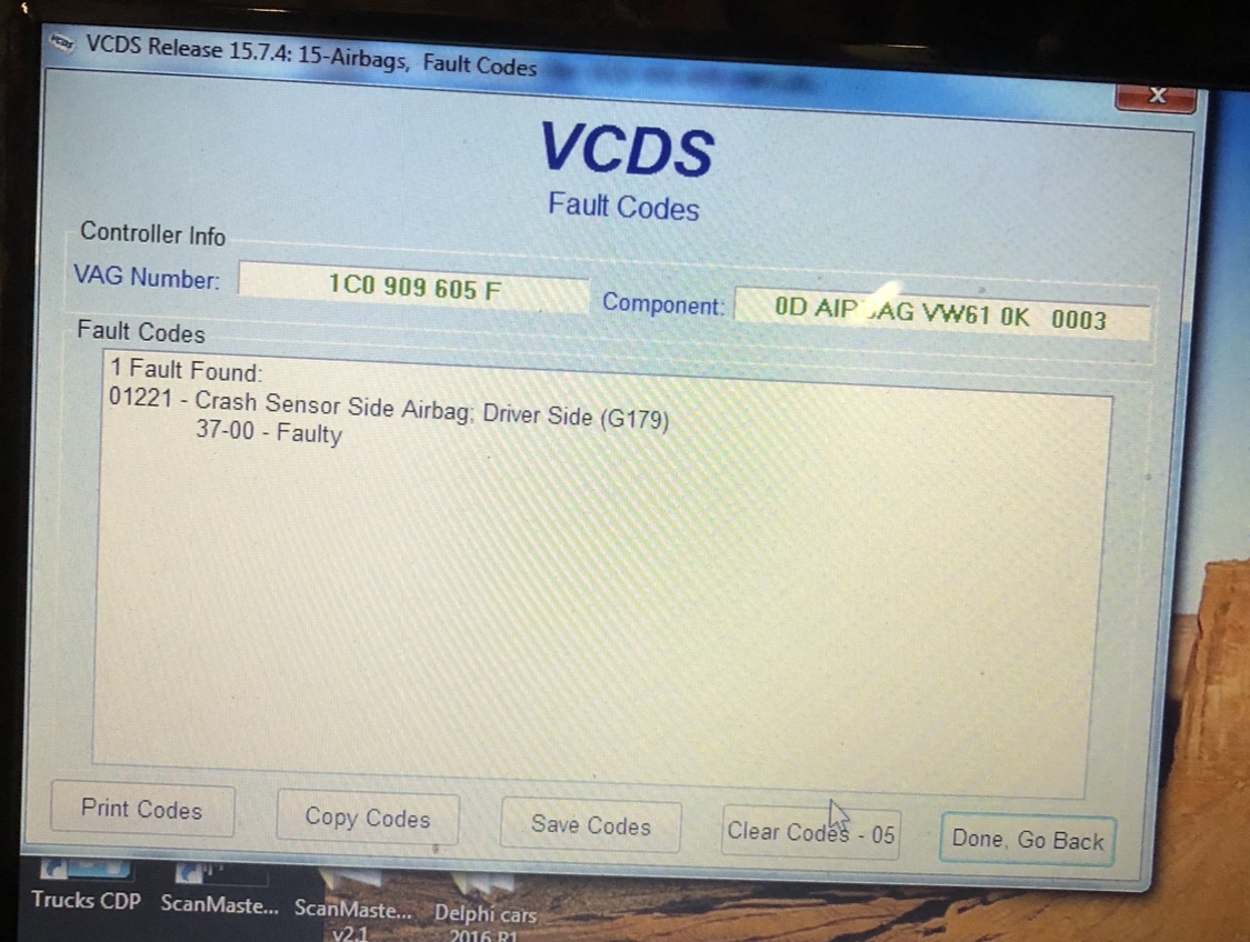

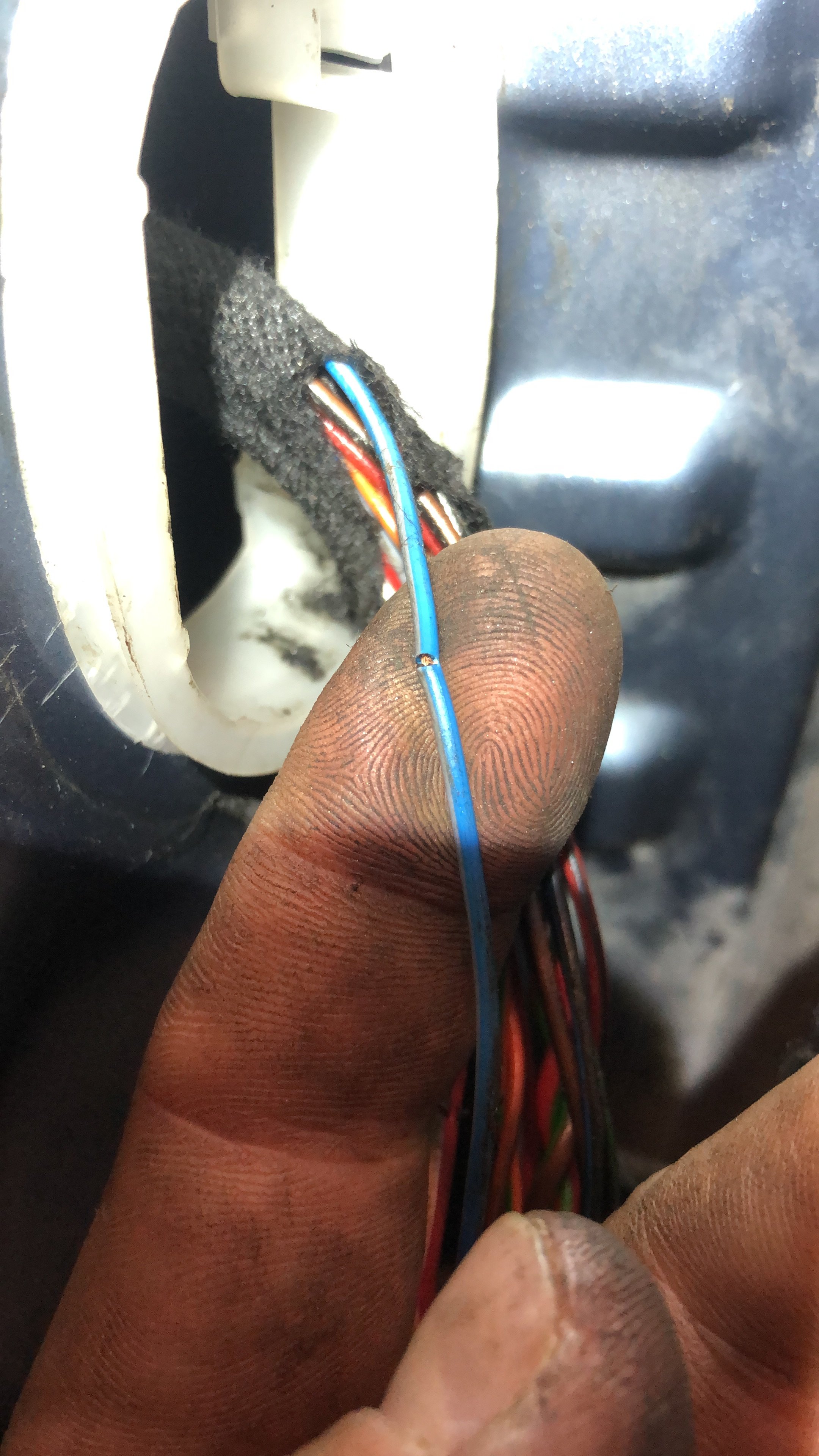

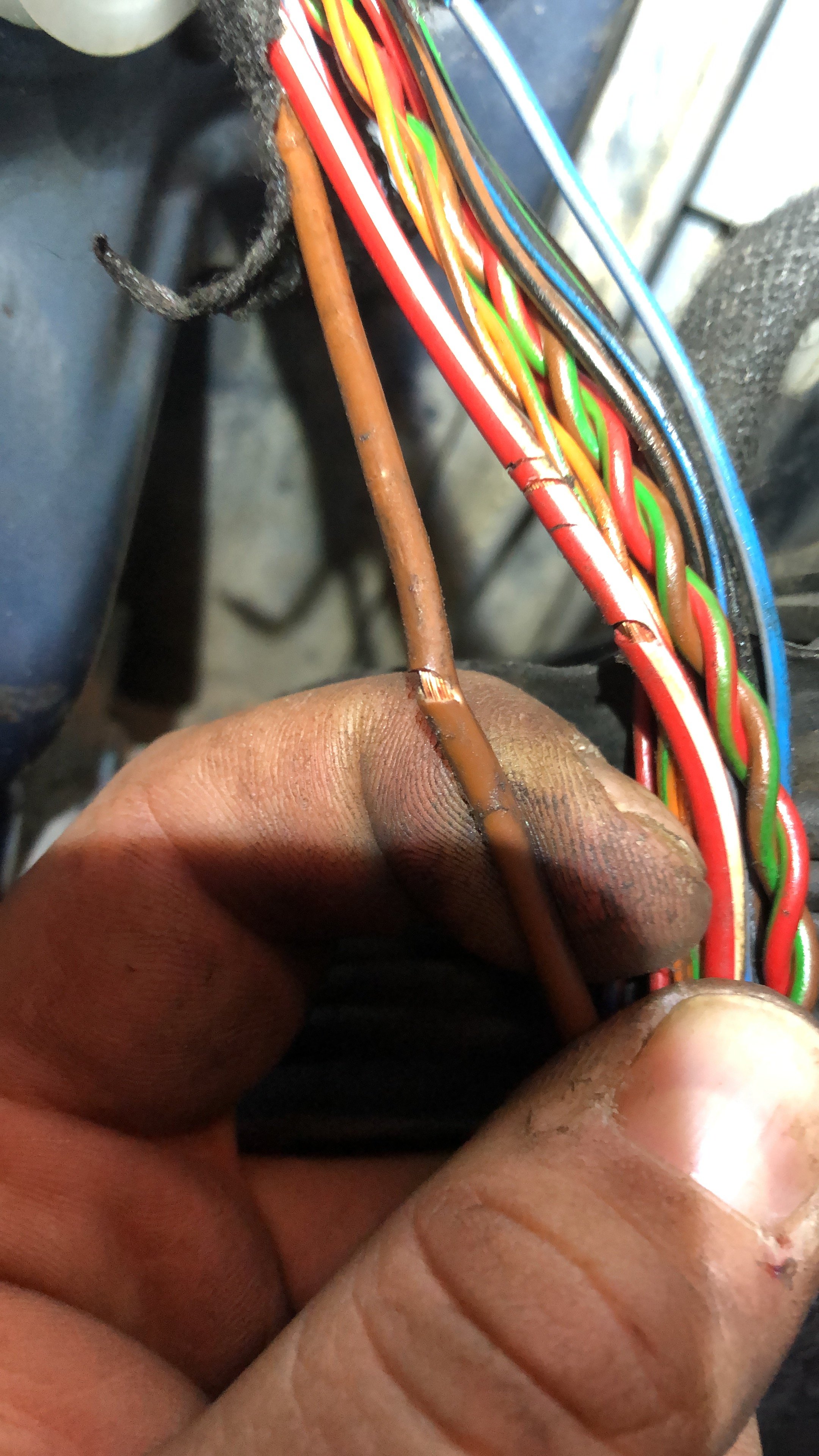

I have checked front wiring (fixed now) and also rear door wiring and still getting 01221.
I have vcds and it says 01221 faulty.
Where might be the sensor then? I really cant find it.
also under the seat yellow connector seems fine.
Suggestions? I am out of them now.
- Mikael
Attached pictures of drivers side wiring.

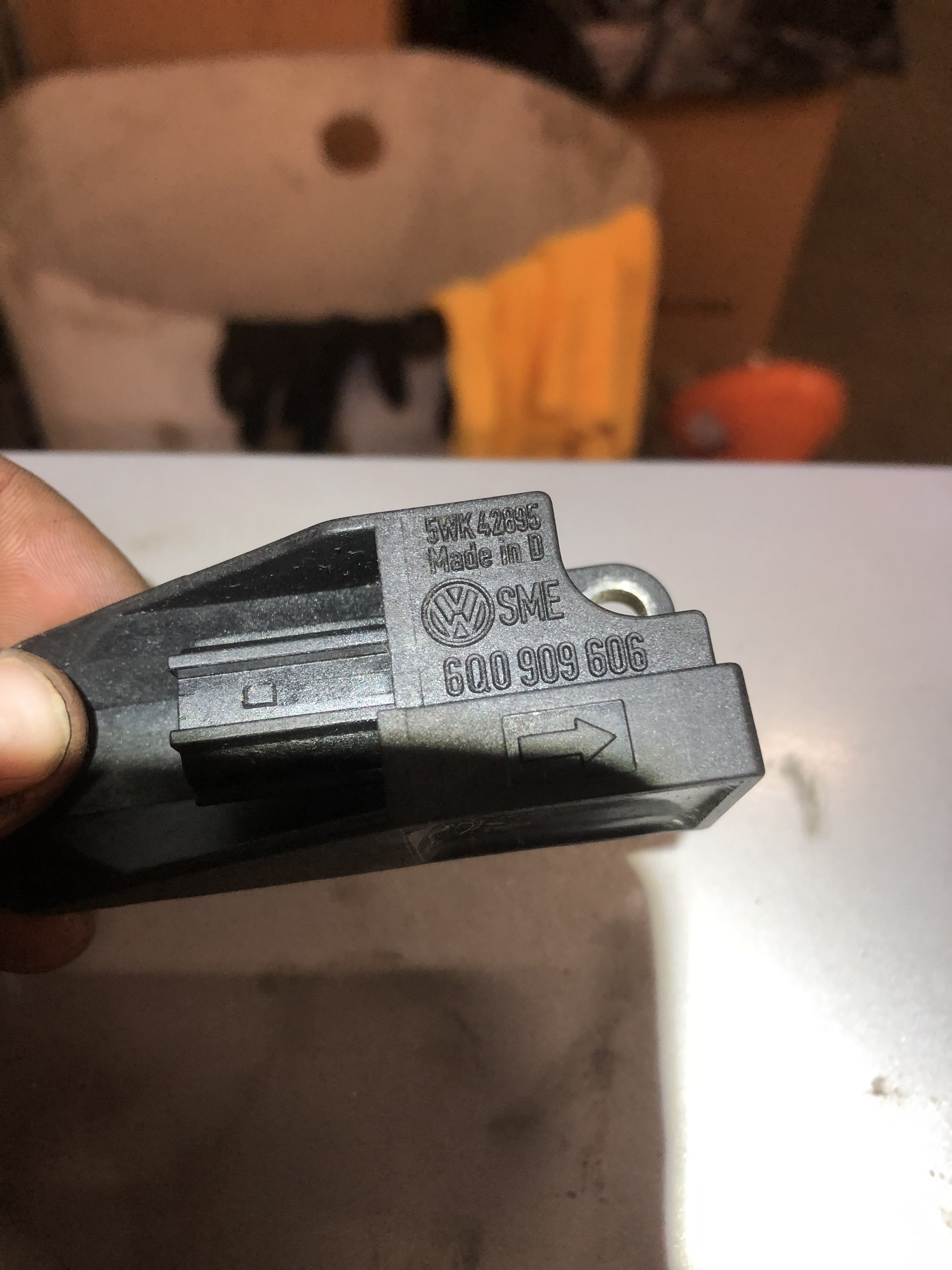

I believe its this one. Drivers side crash sensor! Image included.
REMEMBER TO DISCONNECT BATTERY!!
Bought replacement part from ebay with correct code. For this airbag ECU it was 0K.
To find your ECU number you need to read airbag ecu with VCDS. There you need to find ”Component: ” line and you will find the 4th line saying something like ”0K” and that is the part I ordered. Part number + that ”0K” and got it working.
It needed vcds for clearing codes of course but no adaptation etc. Including picture to help finding the component part.
Replacement for this part took aprox 1 hour - including cup of coffee at the start.

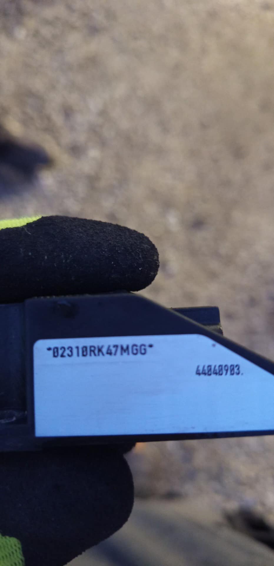

Do i need to get the sensor with the excact code as the old one? The smaller code i suppose 44040903.Messenger_creation_380A17BC-F9A6-40DA-BE3E-40E8AB6E5B61.png
Yeah exact same number and read the airbag ecu unit 👍 Thats atleast how I did it and it worked.

Me again.. I have the same code as u had ''0K'', do i search the part as 6q0909606 0K or 6q0909606K, seems hard to find anywhere both ways. thanks
No worries!
Check the original part (you took a picture already) and look for the same looking number as I had. It should be stamped on the original plastic like ”600909606”.
Can you order from ebay?
Try searching with with the part number and add that 0k to the end. For example in my case it was on ebay:
600909606 0K skoda. Atleast I can see one polish company selling that part!
