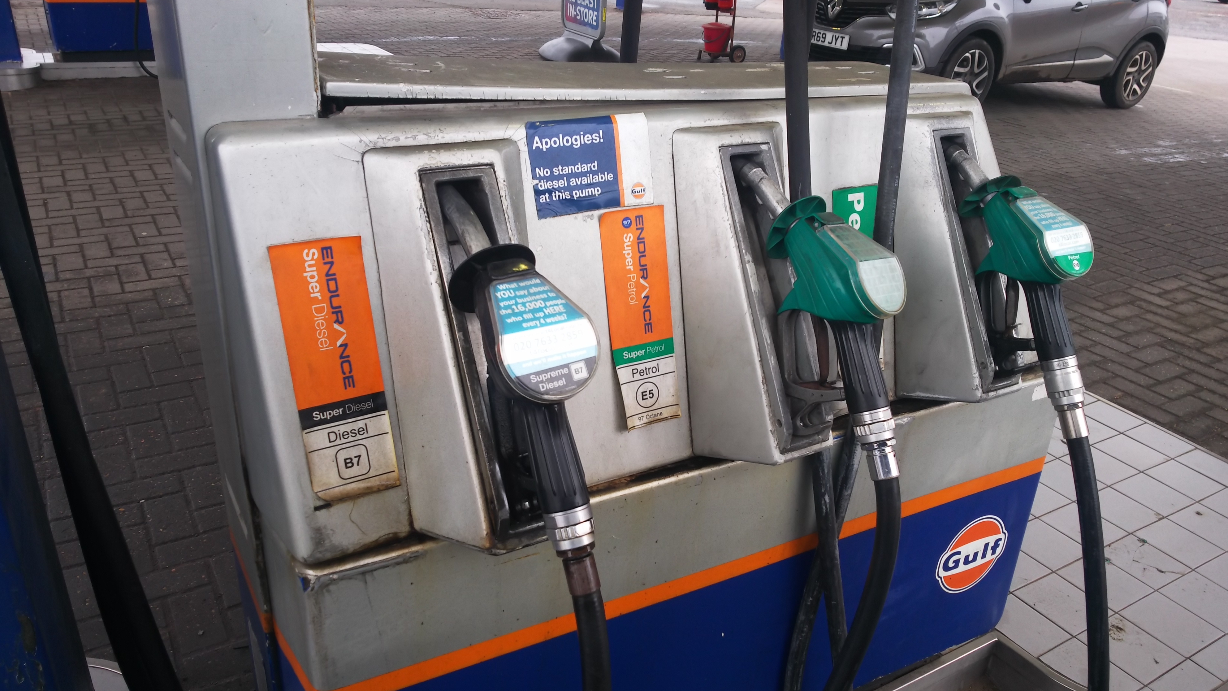

Run a couple of tanks of Premium Diesel then from BP or Shell but if there is a Gulf filling station try the Super Diesel they have.
When was the Air filter last looked at, and the Fuel filter replaced?
It will maybe have it smoke a bit then maybe even then running better.
DSCN2742.JPG.bdc9c67e7ef5b3c6a9e29866f08a0e19.jpeg.550b65037a75f9bfda7a64ae18001616.jpeg

Car has had recent full service.Will try the more premium fuels thanks
