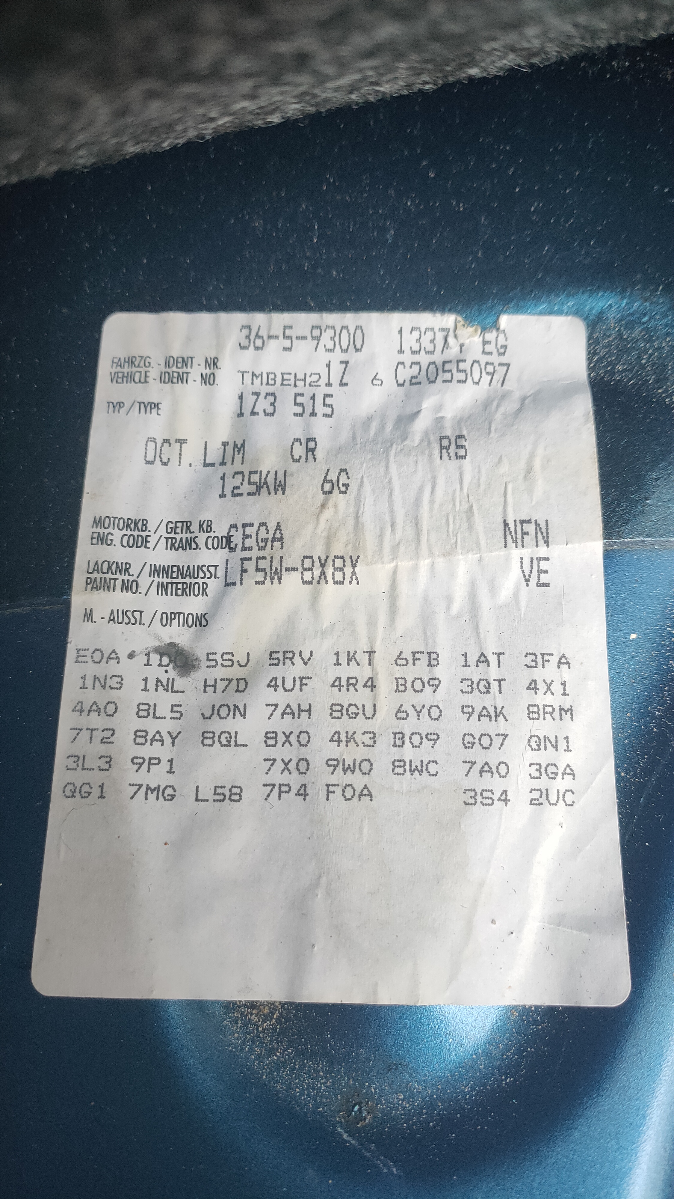

Hi, I have searched the forums and found it mentions I need to check the sticker in my boot, however the sticker doesn't seem to show any of the codes listed on the part sites.
Could someone help pleassse?

Your front brake PR-code is 1ZB.
Current part number for genuine pads is 3C0 698 151P.
Thanks mate, I did wonder if it was the 1ZB just couldn't see 1Z3 on the brembo or pagid site

That 1Z3 on the sticker is nothing to do with it. In my experience front brake PR code is never on the sticker. I use a subscription parts site to look up. Contributions welcome. 😁
Ahh ok, Thankyou for confirming, drop me a pm how to contribute :)
