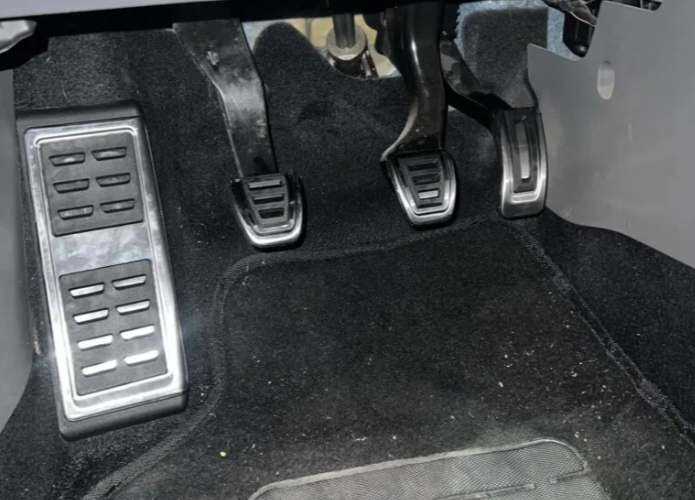

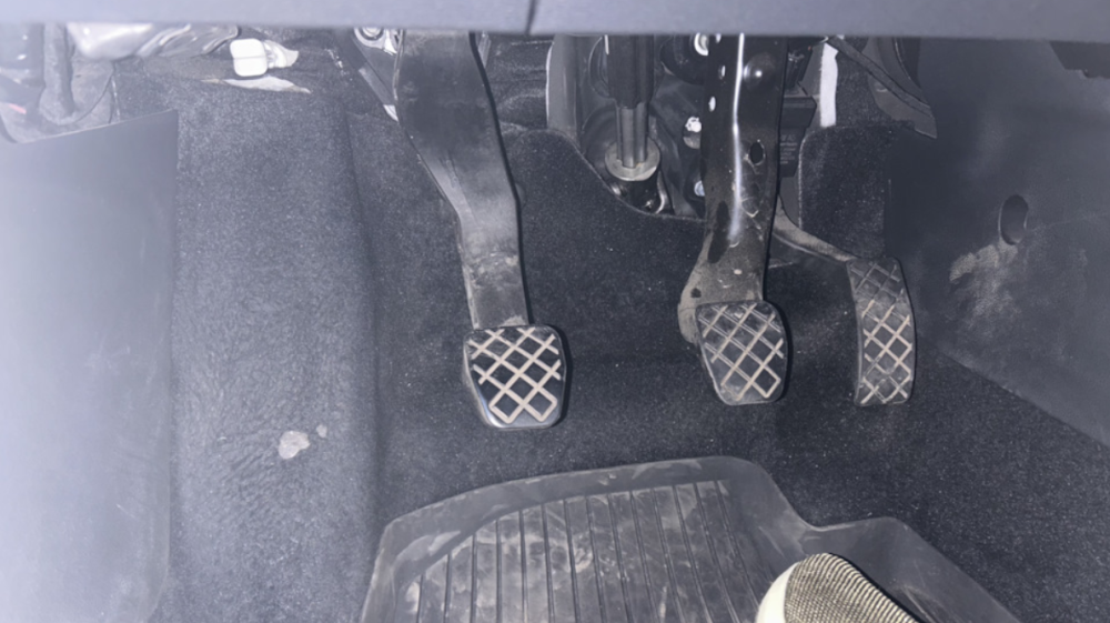

I was looking in my car yesterday:
brake pedal is made of steel
clutch pedal is made of plastics
maybe thats the reason why the vibrations are felt on clutch pedal and not on the brake pedal
also I found some old technical bulletin regarding the vibrations on the clutch pedal on some old vw models equipped with 1.9 tdi - they suggested it could be problem in frequency modulator - a part that minimizes vibration transfer through the clutch line to the pedal
Edited by medley
Well, that is very interesting, that might be it. Which would mean, that while the feeling in the foot is strange and indeed uncomfortable, it probably doesn't do any harm to the clutch or anything else, which is important. The modifications described in that technical document are interesting, but I guess no service would agree to do it under the warranty. So not really a solution right now, but but good news nevertheless
Edited by Happy24
Yes, thats right
if somebody would give you 4 cilinder car with manual transmission now - you would feel the vibration on the clutch pedal as well.....but they are more comfrtable since the vibrations of the 4 cylinder are "more comfortable"
+ the vibrations would not be so evident if the path of the clutch pedal would be shorter....it is a rather long way to push the clutch pedal to the bottom on scala
nevertheless if i would know this before i wouldnt buy this car
for clutch life the vibrations are not so important - but moving from the standstill is....it is a bit weird if the person is not ussed to do it with 1.0 tsi from nowadays (I have written about it too)
