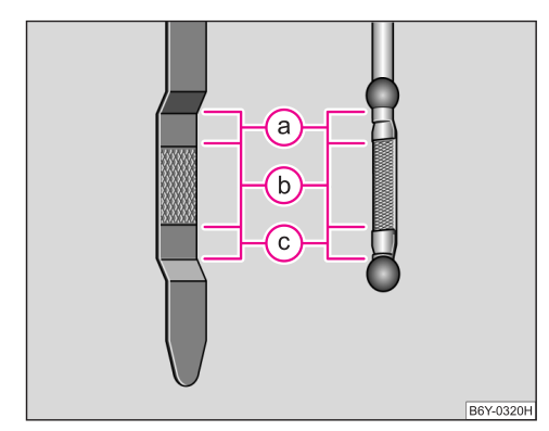

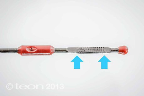

@SK2023 Are you checking and topping up the oil as per the Owners Manual and when the engine is at operating temperature and after stopped for a few minutes and sure there is enough oil in like when you collected the car and then after the dealership has topped up the oil.
Are you leaving the Oil & Filter Service intervals to Variable, and 24 months / 18,000 - 20,000 miles ?
The low miles you do might best have the Servicing on Fixed Service Regimes and 9,400 mile / 12 month intervals.
