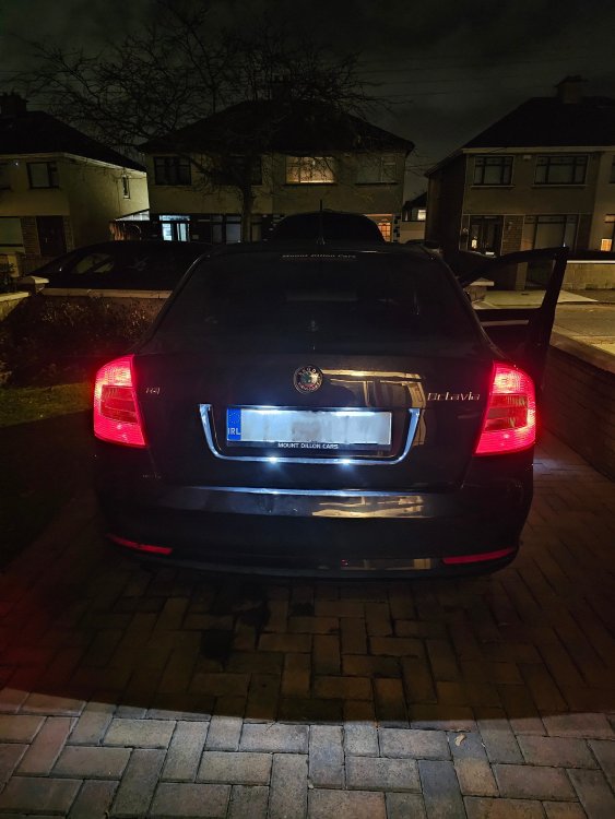

Okay so I fixed the issue, sort of.
I got an OBDeleven scanner and it showed some short/grounding issues with the rear lights so this is something I will have to look at soon.
I cleared the errors and I still had a fault for the LED reg lights.
I programmed in using the OBDeleven scanner that they were LED and now the bulb light on the dash is fixed!
