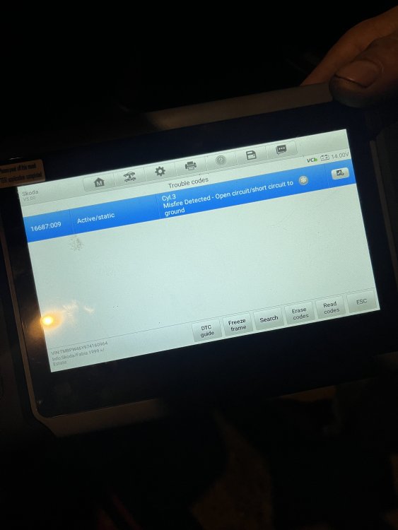

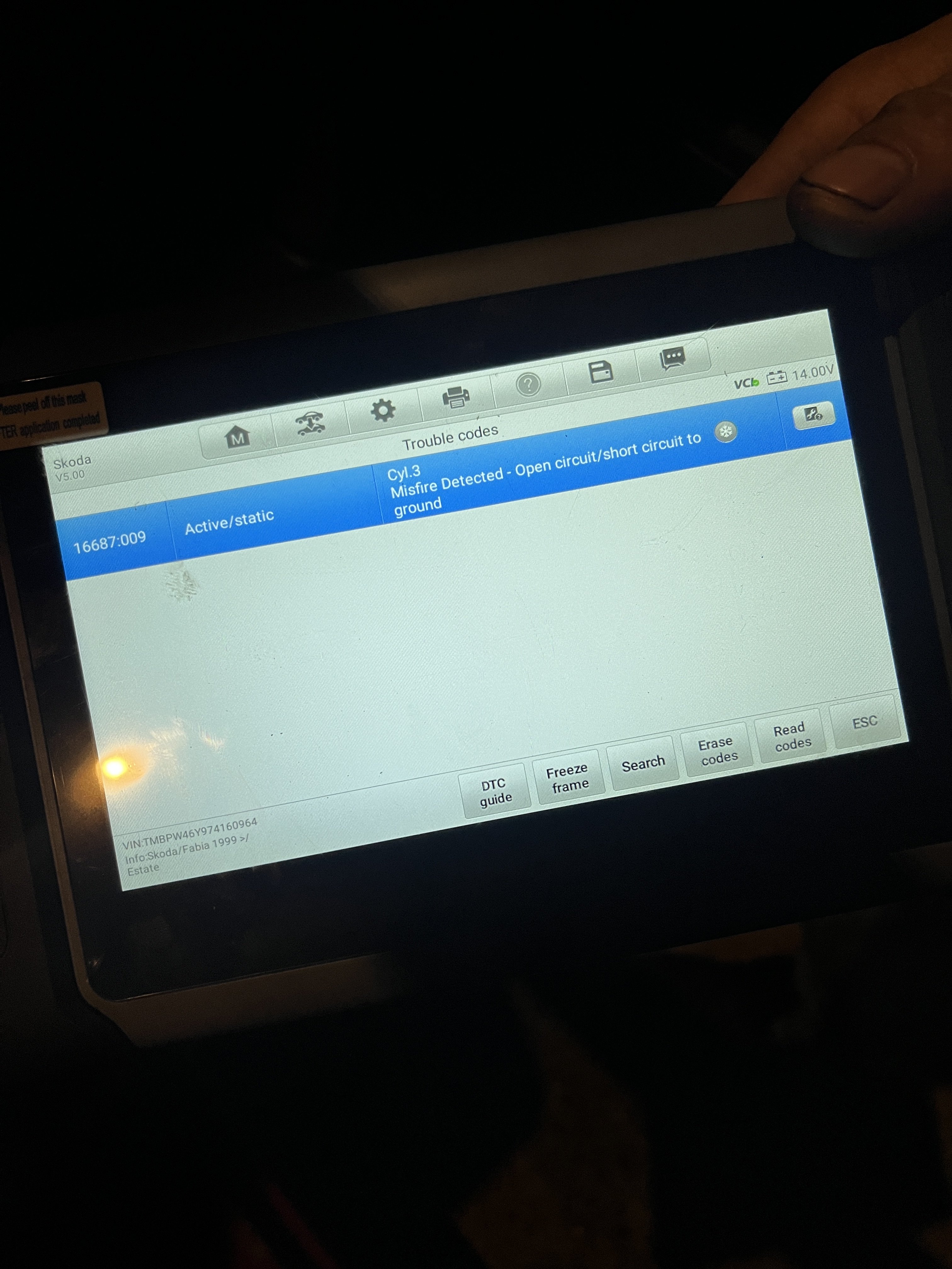

Yesterday I picked up 'red bean’ with a cyl. misfire No.1 and water pump issue. It was running absolutely sh**e, barely going past 10mph and the owner said it was an accelerator cable issue, which we promptly shut down and explained what it really was.
I bought the car for a bargain.
Fixed it all roadside (new coil, water pump and belt) with a local mechanic in MK (he was so cool). Then, I drove it back to london purring as it should. All systems Green you could say. about 40-45mpg for the motorway journey to london.  I thought it's better to fix it in MK instead of towing it to London for 120+ and expensive labour (quoted £200 by a guy I know that has a garage)

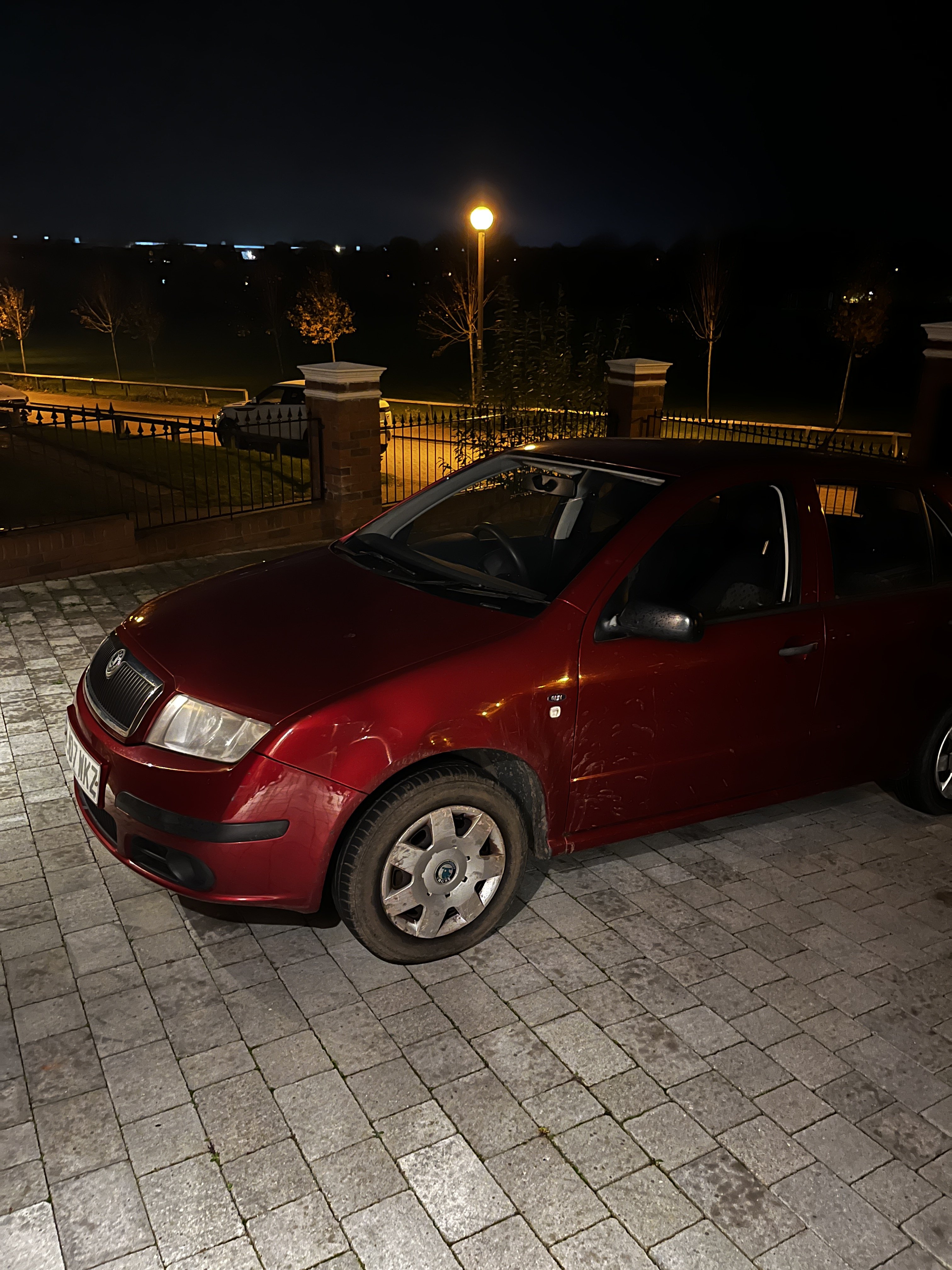

Red Bean parked on my friend's drive after getting fixed and up to scratch.
Cyl. Misfire Code ( we took the coil from position 1 to 3 to test if the error code followed the faulty ignition coil, which it did as we can see here)

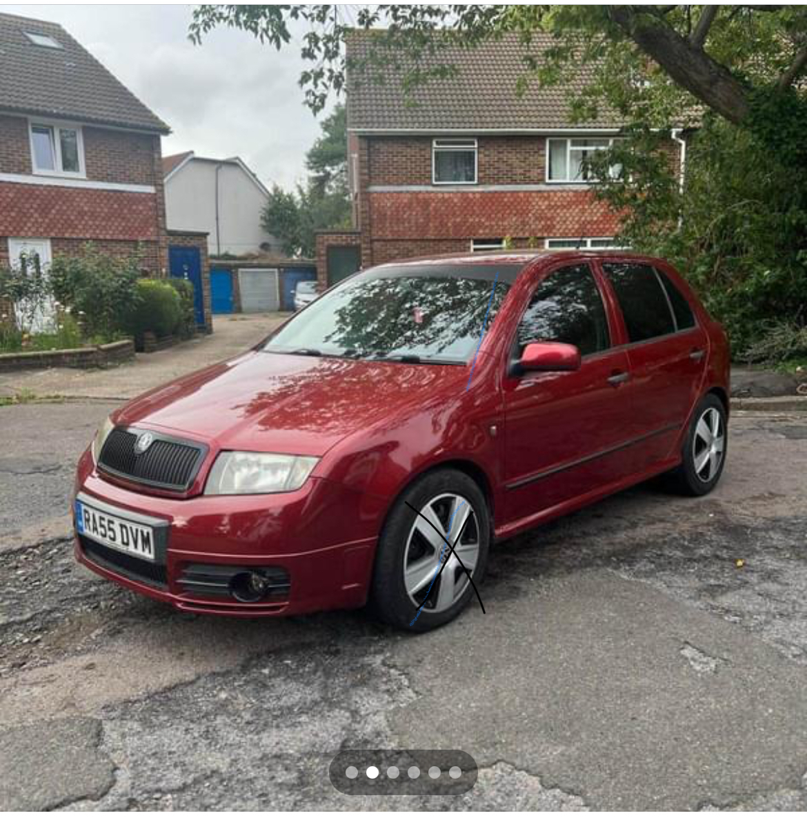

Last photo is a general look of what I’d like the car to look like while it’s here in London. No VW wheels tho, probably Skoda Alloys they were nice.
