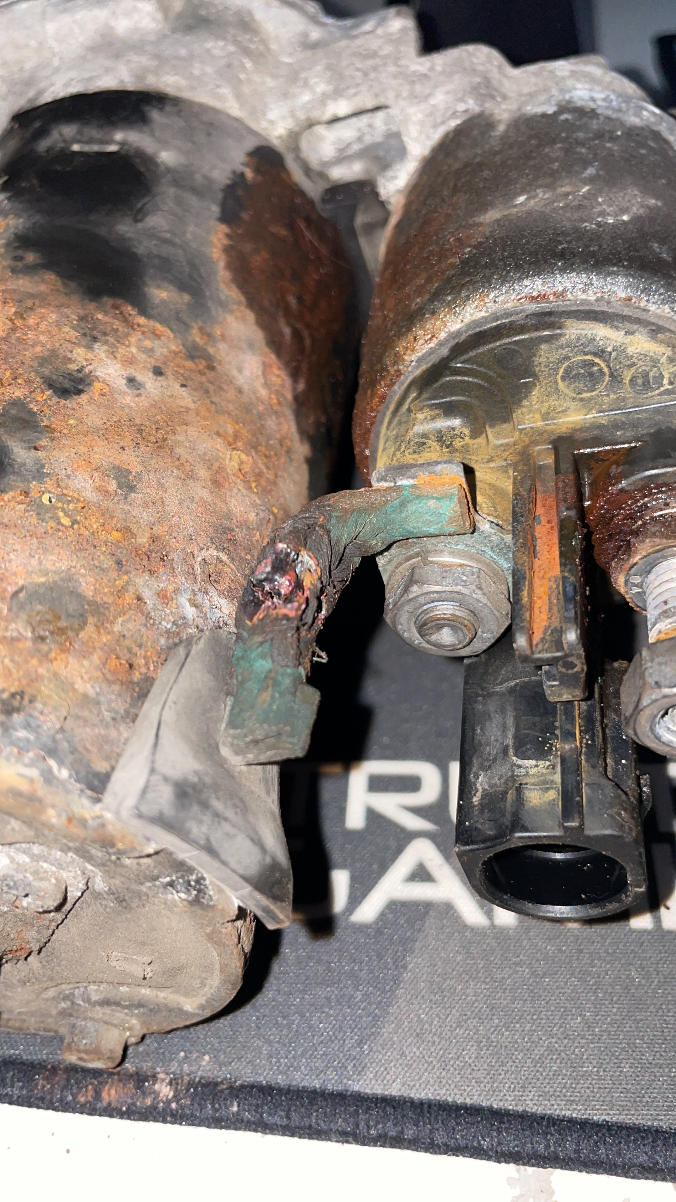

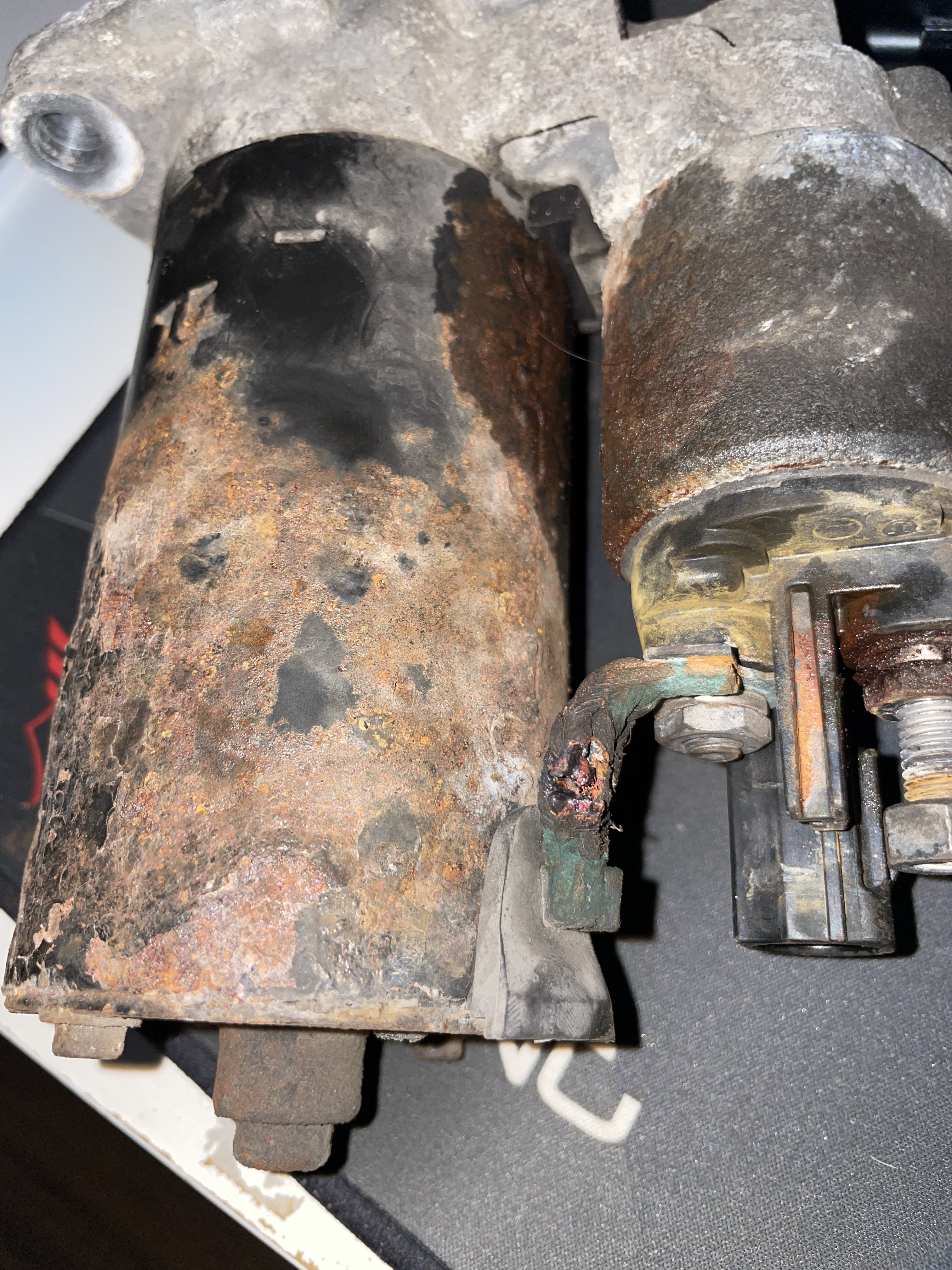

I think i have found the problem.
Anyone knows what it’s the power of the starter, is it 2.0kW?
I can’t read the part number as it’s corroded, and it’s unreadable
  • Sponsor
Yes, I think 2kW. And yes, that looks very much like the problem.
2nd one in as many weeks with corroded braid, easily repairable if you have the tools, material and inclination.
Done, after i replaced the starter. Everything went back to normal.
