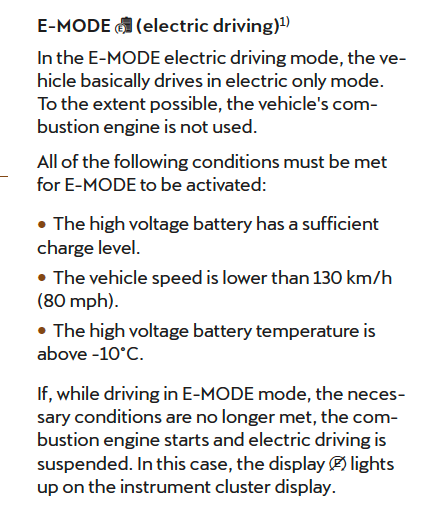

I looked into the (Cupra) User Manual and the info is pretty-scarce on this topic. They only mention 3 conditions that need to be met in order for the EV-mode to be available, but in my case, when I had the car starting in Hybrid-mode with ICE, all the conditions were met. So there must be something else behind, in a second layer of validation conditions - which is not visible to the regular user of the car.
Have a look into the Octavia User Manual, but I assume you'll find the exact same conditions... it's the same car.

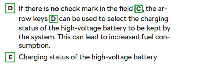

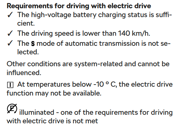

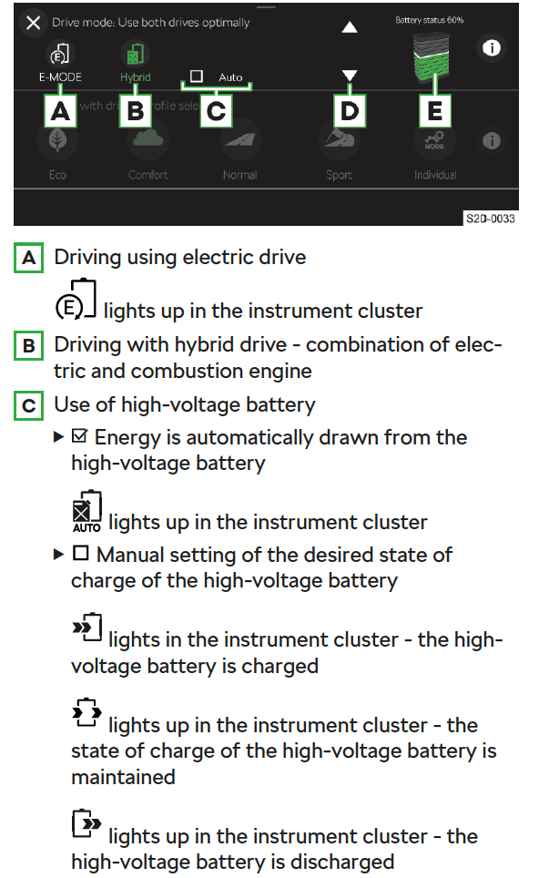

I found the Octavia iV Manual, in Section "Starting and Driving", subsection "Select Drive", there's the following info:
529676442_Screenshot2023-11-28at18_14_11.thumb.png.c1a59736dacc0f912e30886dcaa3b705.png986100229_Screenshot2023-11-28at18_15_31.png.ec46fb7dabb3ab7a886b4f989fa95270.png
Now the next part is what interests you:
Basically, because of those "Other conditions" I recommend you don't stop the engine and restart it immediately simply because you want to use EV-mode. Allow the hybrid-system to decide when all conditions are met and it's fine to use EV only... You won't use too much petrol before the car will validate the electric mode. If that's not the case, then contact your Skoda dealer, 'cause something's not feeling too well on your car. Look for the "strike-through E" sign on your VC, when it's off go into EV-mode.

Yep, that's why I'm blaming "Other conditions"; other users also mentioned that at lower temperatures they were able to go EV with no problem. In my case, when this happened the outside temp was not the minimum that the car was parked into. Too bad we don't know what those are...
