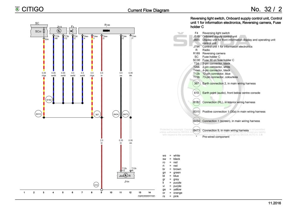

Has anyone retro fitted a reversing camera to a 2020 citigo. I have found the part on car systems EU but it states does not fit certain head units. So I am assuming my head unit is compatible but would appreciate any information such as pin outs ect?
I've looked into this before, on other European forums but at the time I hadn't found anyone who's fitted one to a Citigo.  If I remember correctly it was deduced it certainly wouldn't work on some models of Citigo because the radio doesn't come with a fitted video encoder inside - but which radio models it was unclear to me.  But looking at the wiring diagram it's definitely in there.   The wiring is fairly simple - 5 wires, one to ground and one to power and one to the reverse light switch - and then 2 into the radio - exactly as stated on carsystems.   Never got far enough to look into the coding

You need to code after Install and Must have Rear Parking Sensors
Kufatec does the coding dongle... thinking about it myself..
