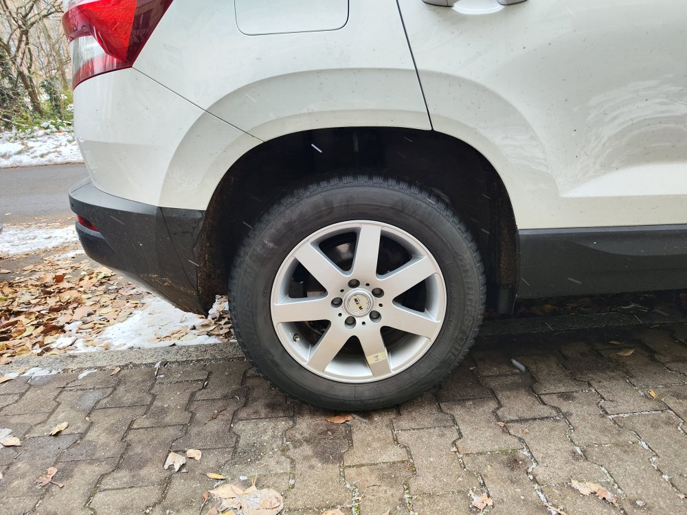

when I bought the car, there were 4 summer tire, size 215/50 R 18 and 4  winter tire 215/60 R 16,  I changed it yesterday due to snow here.
I drive with it for 1 days and driving with it sounds more comfortable for the passenger and steering is softer than 18 inch.
this is the topic that put me on more confusing.  to be honest driving with 18 inch tires on  Karoq 2019 1.6 TDI was a bit rigid. particulary on Bumps and potholes.
I'm attaching the photo that I took today. 16 inch sounds small, isn't that?

Hi Josif,
I missed that you are in Germany where many drivers switch between summer and winter tyres on different wheels.
The 16 inch wheels with a deeper profile will certainly be more comfortable than the 18 inch, and as long as the circumference of both tyres is similar you should be fine. the website Tire Size Converter will let you compare the two tyres. I think that there are also German websites that list the approved wheels and tyres for cars, and that you need to comply with these requirements to be legal. Apart from that, the use of bigger diameter wheels with lower profile tyres is largely a fashion-led drive to 'improve' their appearance and disregard their comfort.
