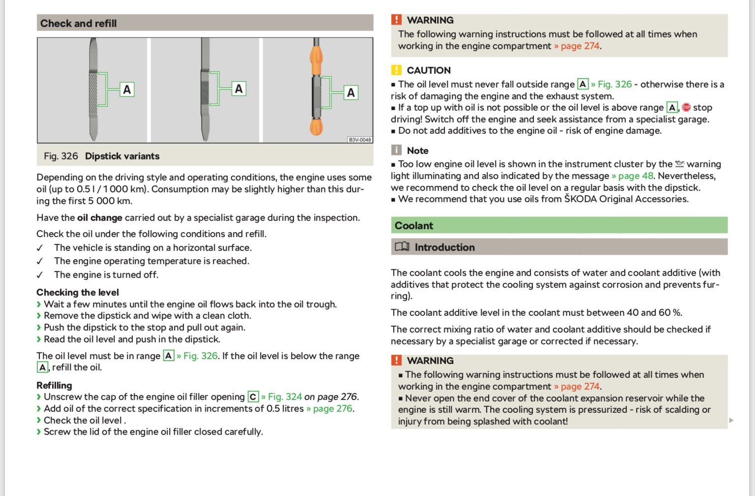

Skoda / VW say 0.5 litres in 1,000 km is acceptable, which it is not, so 621 miles or 1 litre in 1,242 miles.

Is the engine correctly filled at services and not low on oil and how many miles is it between checking and topping up in that 10,000 miles?
