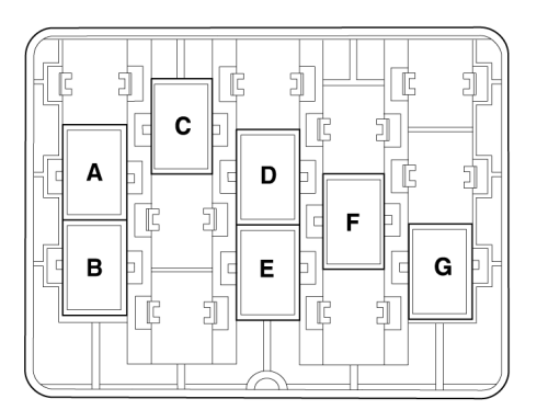

Green connector apparently lives in position A of this image:
I think that matches with an empty position in the above from the Golf video. Different engine in the Golf maybe?
Edited by Breezy_Pete

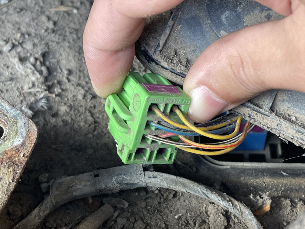

Couldn’t wait much longer, had the wiring checked yesterday
This is the connector pete was referring to:
I checked the wiring from the ECU to this green connector I am holding in my hand using an avometer and both of the yellow and yellow/red wire gave a reading on the avometer
I also checked the wiring from the other end of the green connector to the fan control relay and both wires gave a reading also
That was a huge disappointment to me to be honest.
