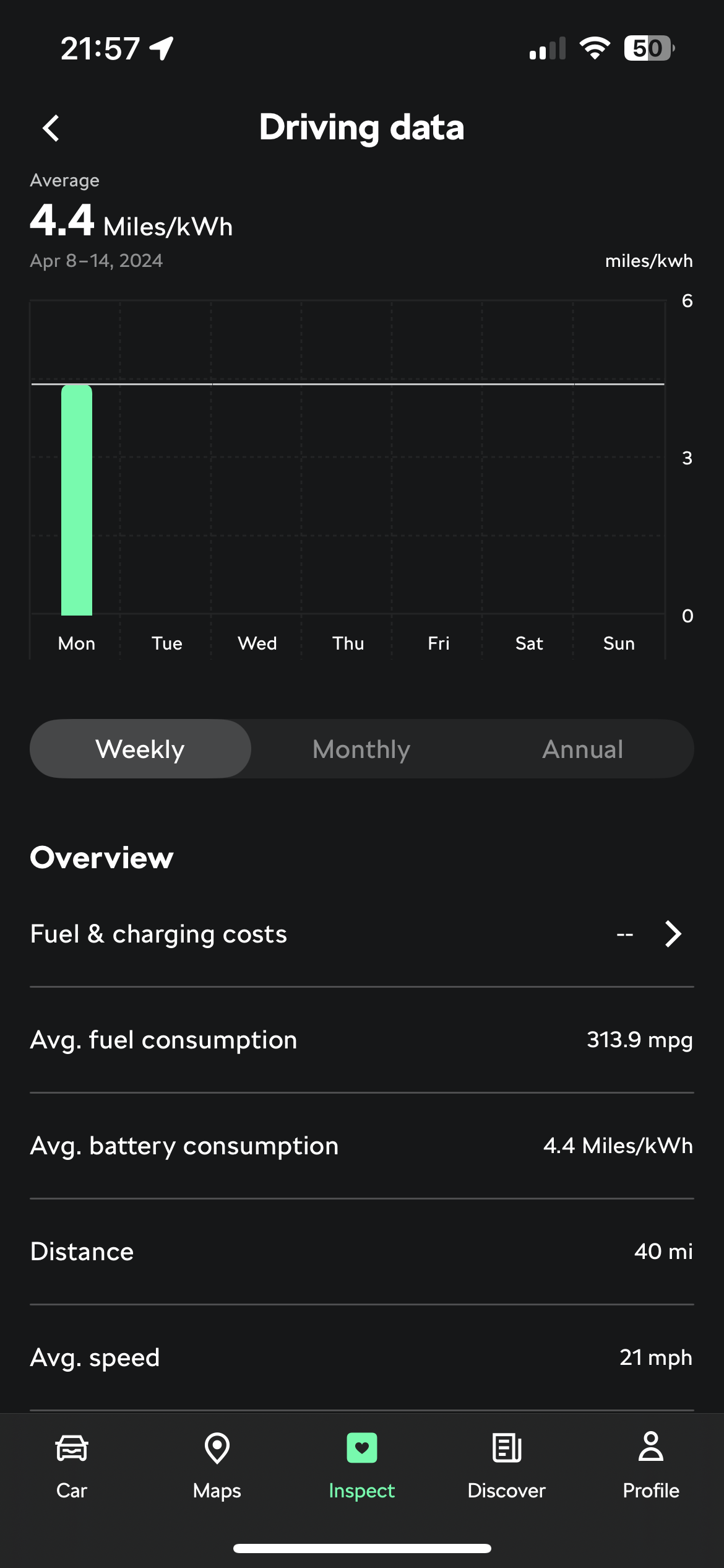

achieved 40 miles elec range today with 5% remaining so probably could’ve done 42 miles total. 2 journeys again. First one about 5 miles and 2nd one about 35. Some motorway on 2nd run but mostly town driving and a few 40mph stretches.
Great.
So looks like only 11 kWh usable battery only. Or less.
4.4 miles x 11 kWh = 48.4 miles.
4.4 miles x 10 kWh = 44.0 miles
Yes 40 miles + 5 % of 11 kWh,  0.55 kW 2 miles,  42 miles.
I think the official figure is 9.6 useable. 9.6 x 4.4 = 42.2 miles
Did the remaining 2 miles this morning as it didn’t charge last night 🙈
