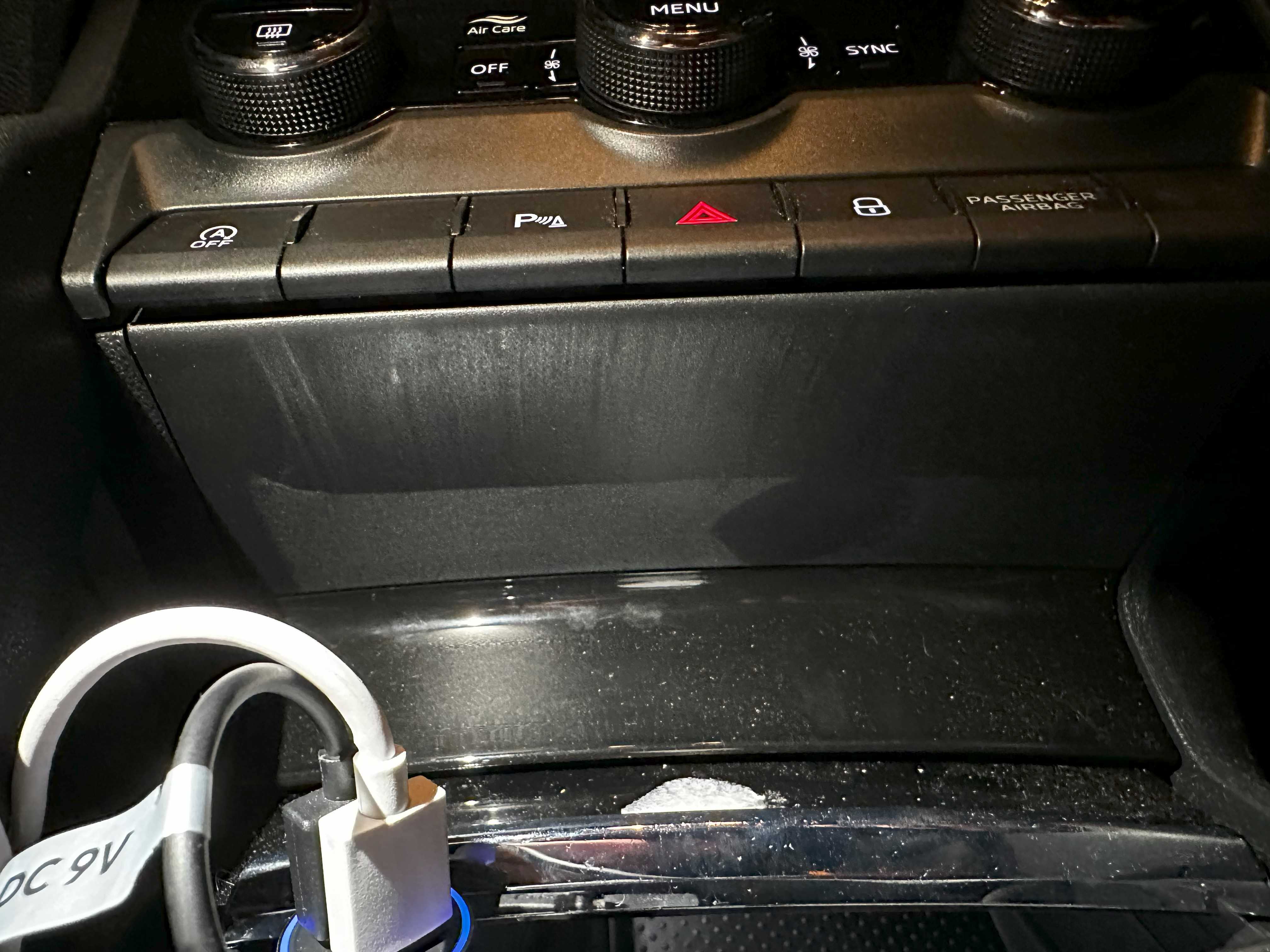

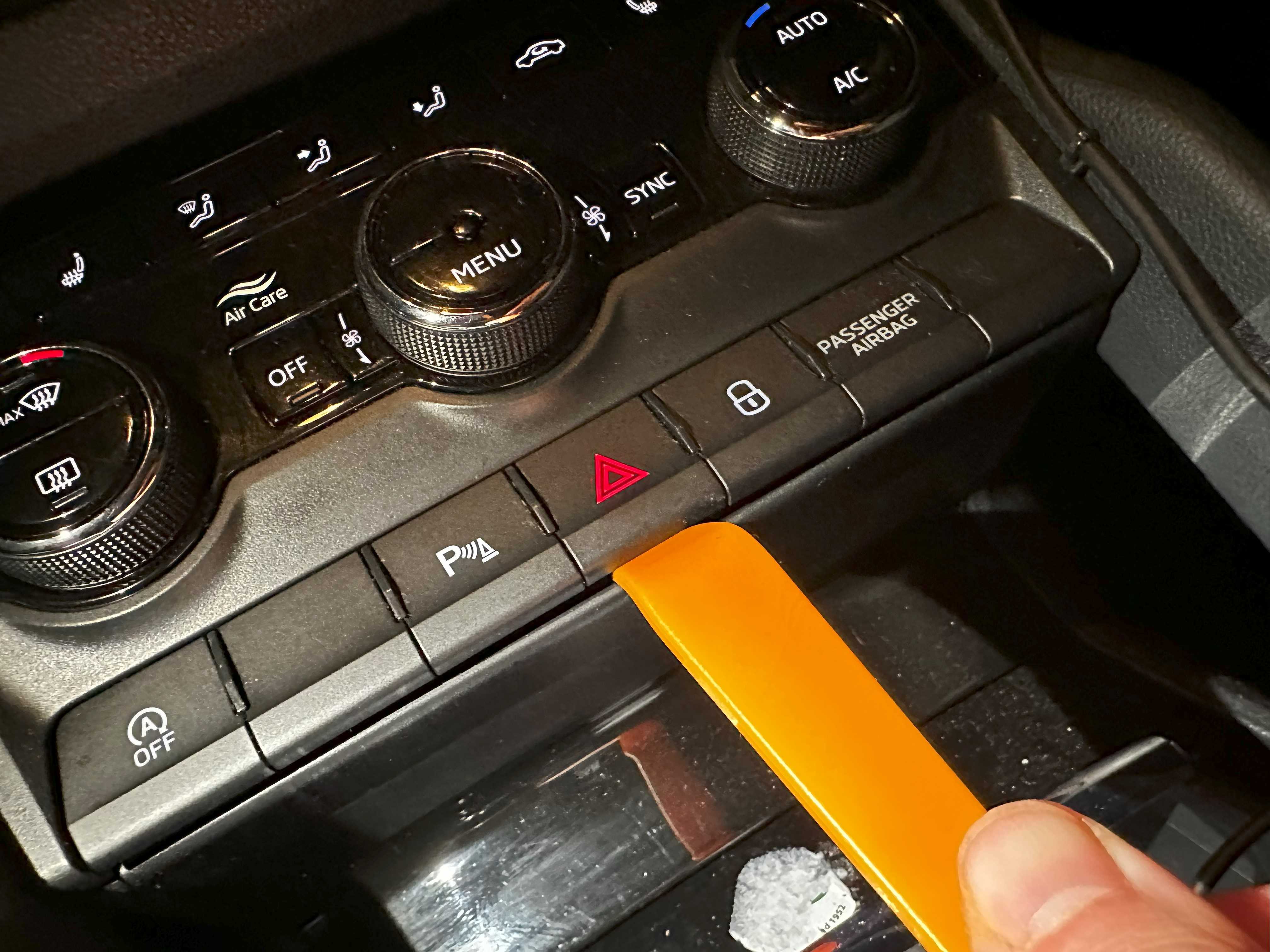

  1. Remove the plastic cover underneath the module using the pry toolIMG_6251.HEICIMG_6252.HEIC
  2. Use the pry tool again to separate the frame and the module to allow the module to pop out. You can gently use the unused buttons to pull the module out with. They might pop out a bit, but shouldn't break.IMG_6254.HEICIMG_6244.HEIC

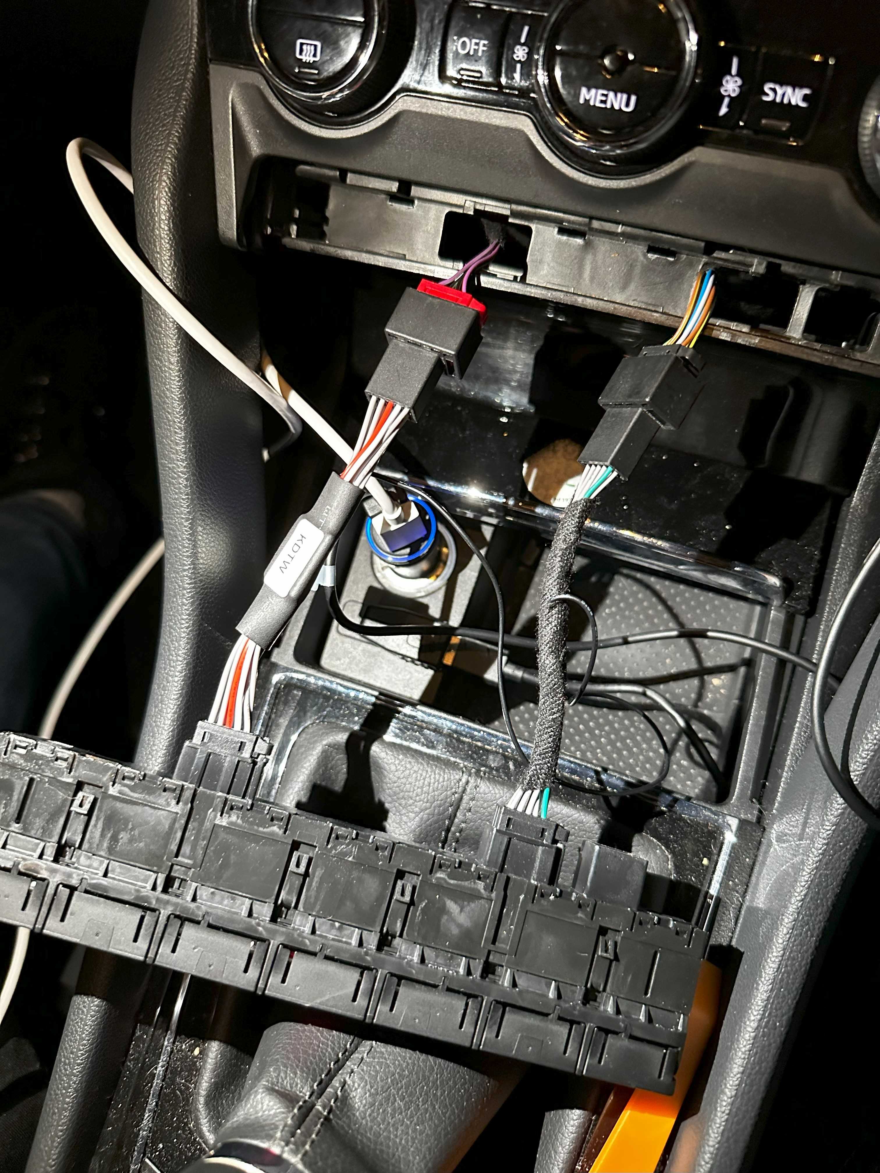

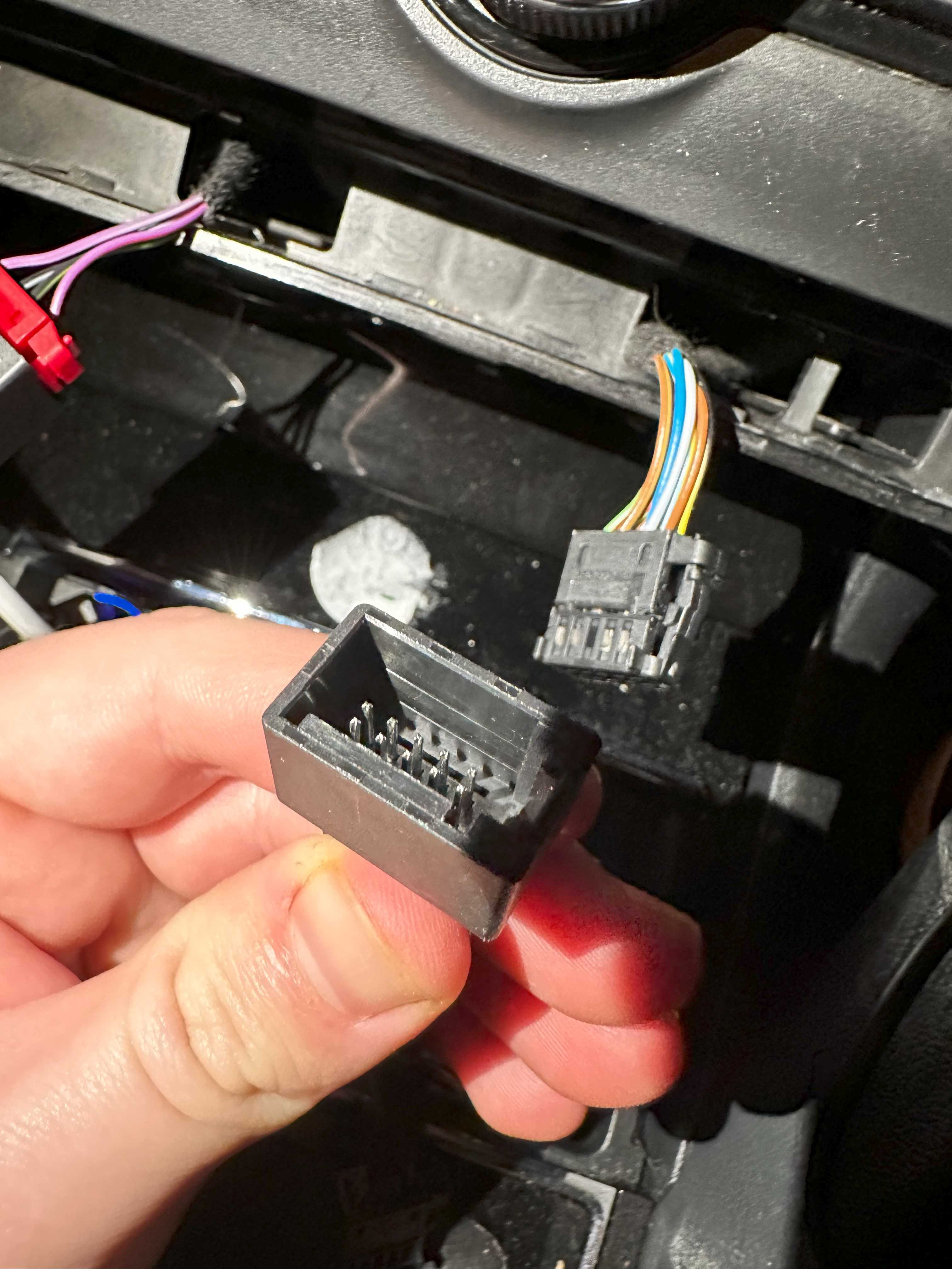

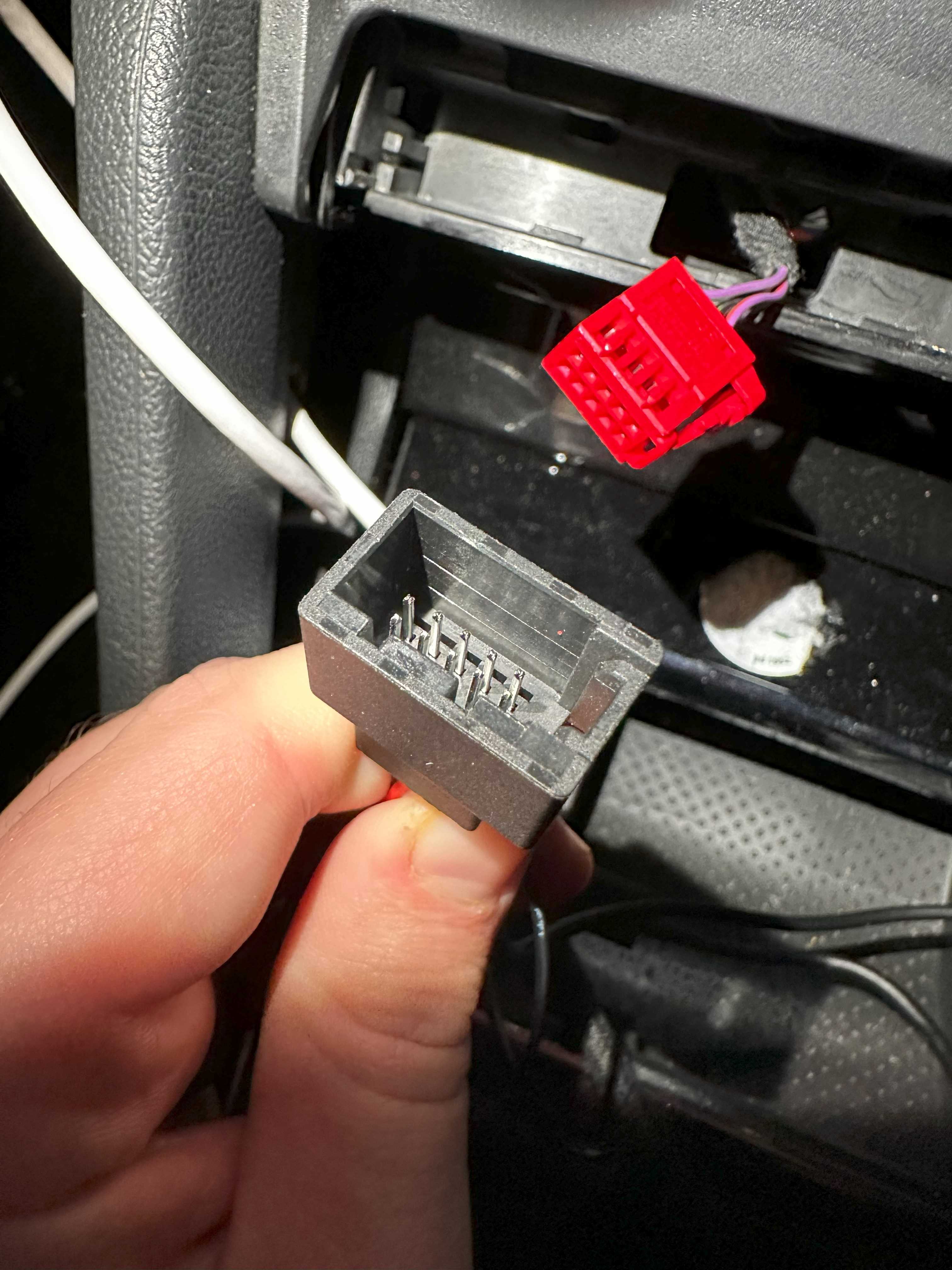

  3. Note that the red connector is on the left side of the module while the black is on the right.
  4. Connect the cable with the thicker middle part to the red connector, and the slimmer one to the black. The connectors look very similar, but there are little plastic keys on the connectors and they should line up with the appropriate connector.IMG_6245.HEICIMG_6246.HEIC

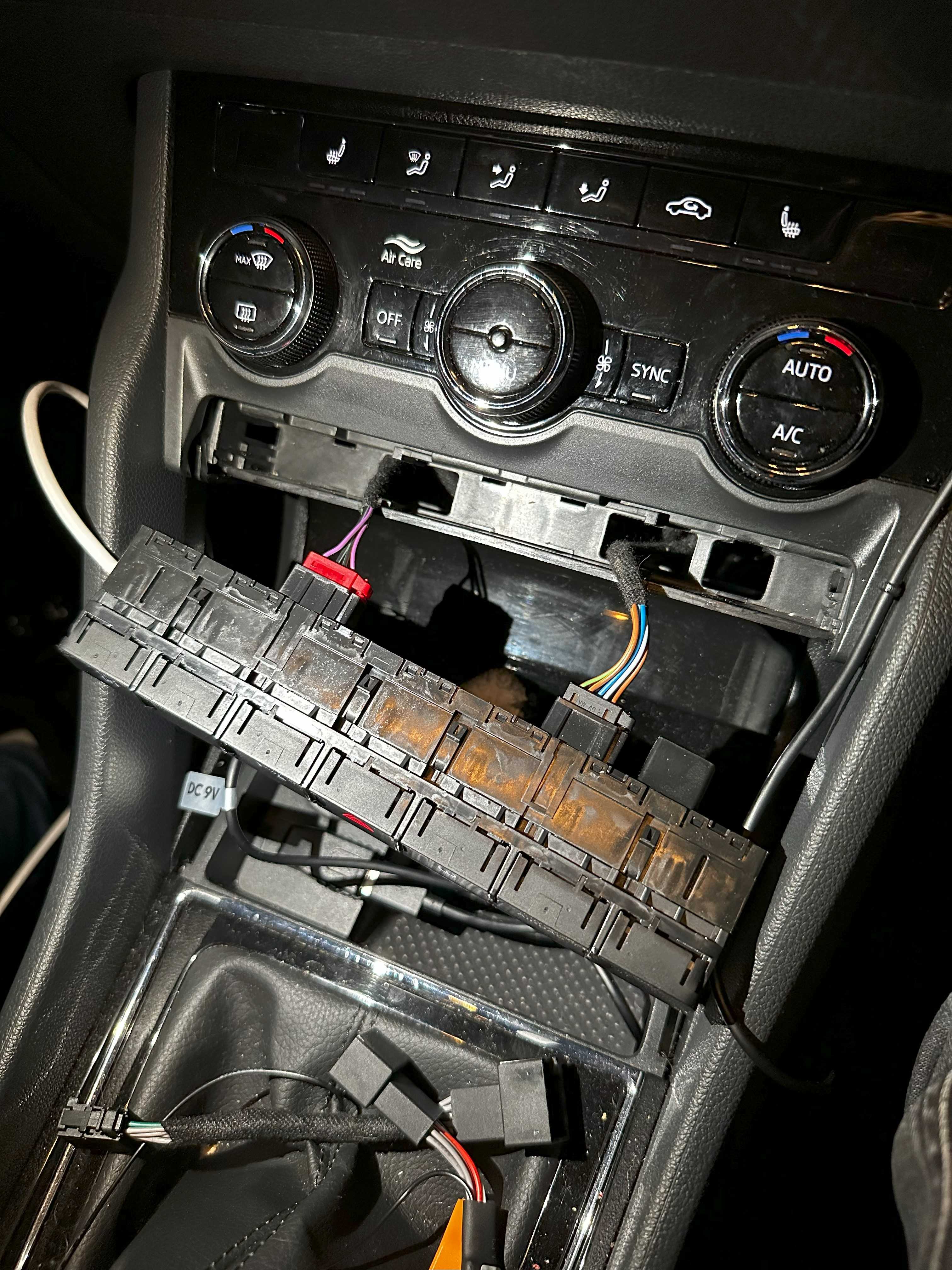

  5. Connect the cable with the thicker middle part to the left side of the module, where the red connector used to sit, and the other slimmer cable to the other connector. Make sure the connections are secure. There is thin wire connecting the 2 cables together, make sure this is not damaged.
  6. Carefully slide the extended cables into their original slow and slide the module back into it's place and push until it clips in.IMG_6249.HEIC
    ModuleBottomCoverPlastic.thumb.jpg.7bda66252a4f948a521fc6e2cf67ba74.jpgModuleBottomCoverPlasticRemoval1.thumb.jpg.3358a5d6c5de0afdeb06719d45700b8d.jpg
    ModuleRedCableConnector.thumb.jpg.66c63eefaa17a9d30417a9dd5b209e55.jpgModuleBlackCableConnector.thumb.jpg.ae44efd40afe85ac4a25143551f8db31.jpg
