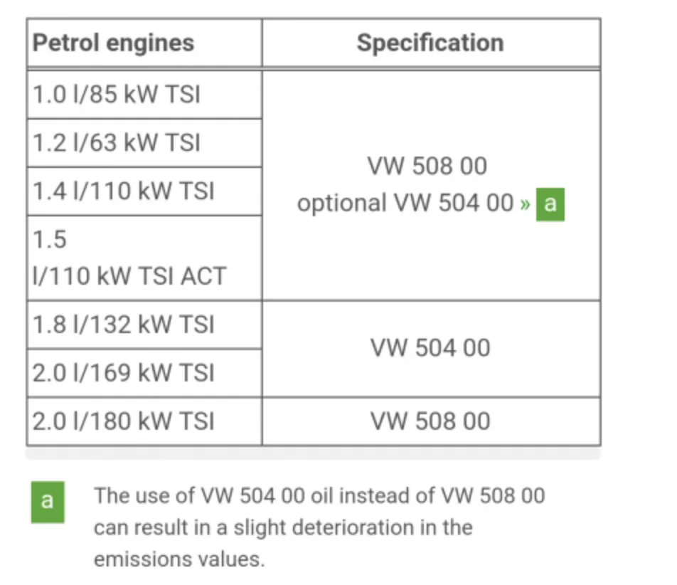

This chart is misleading. Skoda were not putting in VW508 00 / 509 00 at the factory from 2015.

a 2020 TSI is VW508 00 / 509 00 so 0w 20 FS IV.

The 1.0 TSI with GPF can still use non Long Life Oil so VW502 00,  5w 40 FS, but that does not show anyplace from Skoda.

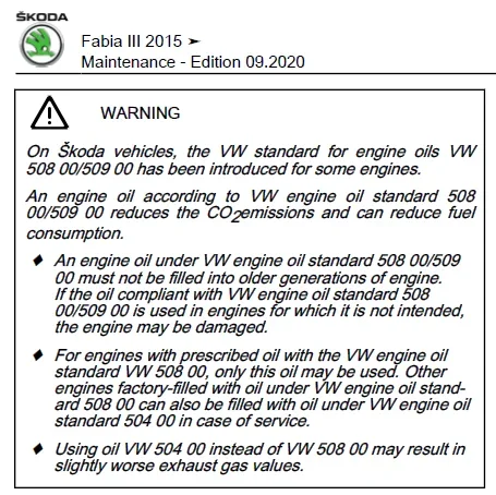

As it can use 5w 30 FS III or 0w 30 FS III, but as the chart shows 'there might be a slight deterioration in emission values.'
 ie, they would not have got the WPTP results under a test regime.

Not necessarily for your engine but just one example only of one 1.0 engine from the 7/2020 Owner's Manual.-
