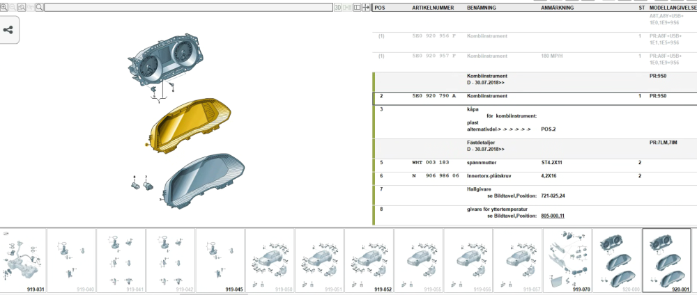

I´ll make a answer to myself 😛
There is just one cluster, 5E0920790A and that can be coded to what motor it has, VRS etc.
I looked in ETKA and it just shows one cluster.
MOST cables can be had for around 40€ shipped from UK to Sweden on ebay.
