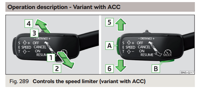

Does anyone know if coding can be done in order to activate speed limiter option and access it through the infotainment / dashboard menus or by replacing the wheel command ?
My wheel command currently looks like this :
Thanks!
It should be possible through simple OBDEleven or VAGCOM Coding, although I cant guarantee it. I don't believe there is an indicator stalk available with both ACC and a MODE button to change the modes, and im not aware of the fabia dashboard being capable of doing this in its place. I can drop you the coding if you'd like, and you could see what it does, but there likely wouldnt be a way to change between the two modes - and it may just throw up errors.
I think you may be missing a button (and wiring probably)
Interesting, there is a stalk with the ACC and Mode button! I did try look but couldn’t find one for the Fabia. Perhaps it will work then providing this stalk is fit
