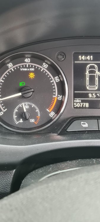

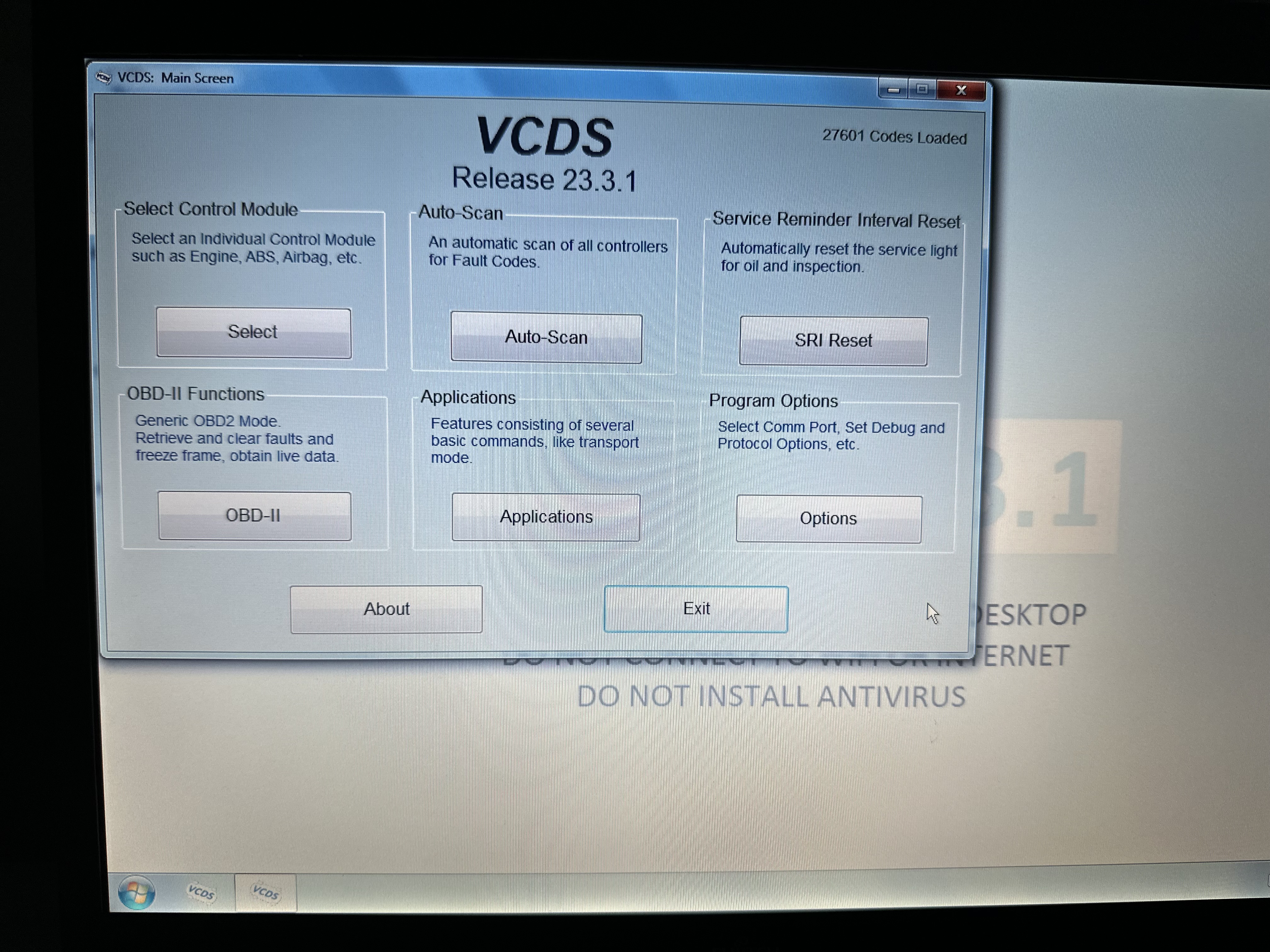

hi everyone, I have recently changed my numberplate lights to LED and I have noticed that the yellow warning light has come on dashboard. I do have vcds software, but I’m not quite sure how to turn the light off using this software so if anyone knows how to knock this light off, that will be a big help thanks (skoda Fabia vrs 2013)
You can't turn it off using VCDS, you can turn it off by fitting normal bulbs back into your number plate lights.

I have been told by several people that you can turn that light off on the dashboard using vcds but I’m not quite sure on how to do it so if you know anyone that would be very grateful thanks

You were given incorrect information, it can't be done using VCDS. Sorry.

so how can it do done with a £70 software but not with vcds it’s gotta be a way to solve it using vcds surely thanks again
You may not be aware, but at the present times LED exterior lights of any kind (including number plate lights) are illegal in the UK in units not specifically designed and certified for LEDs. I would swap back to standard bulbs and save the hassle.
If you do succeed in switching the dashboard light out that will stop it operating for any lamp failure, not a great move.

Deja vu ;) . I literally yesterday pointed out that LED bulbs show up as failed because they don't have sufficient resistance to show as working in the bulb monitor.

It’s fine, don’t worry about it now I have found a video that turns the light out on the dashboard
interesting...............care to share ? did it work........
For what it's worth, there "may" be a setting to turn off bulb failure warning (not 100% sure and have not checked yet) , but that would then disable all warnings, not just for these number plate lights "if" the setting exists.

i’ve sorted it now i got bulbs from a branded website and they work fine without light on dashboard
