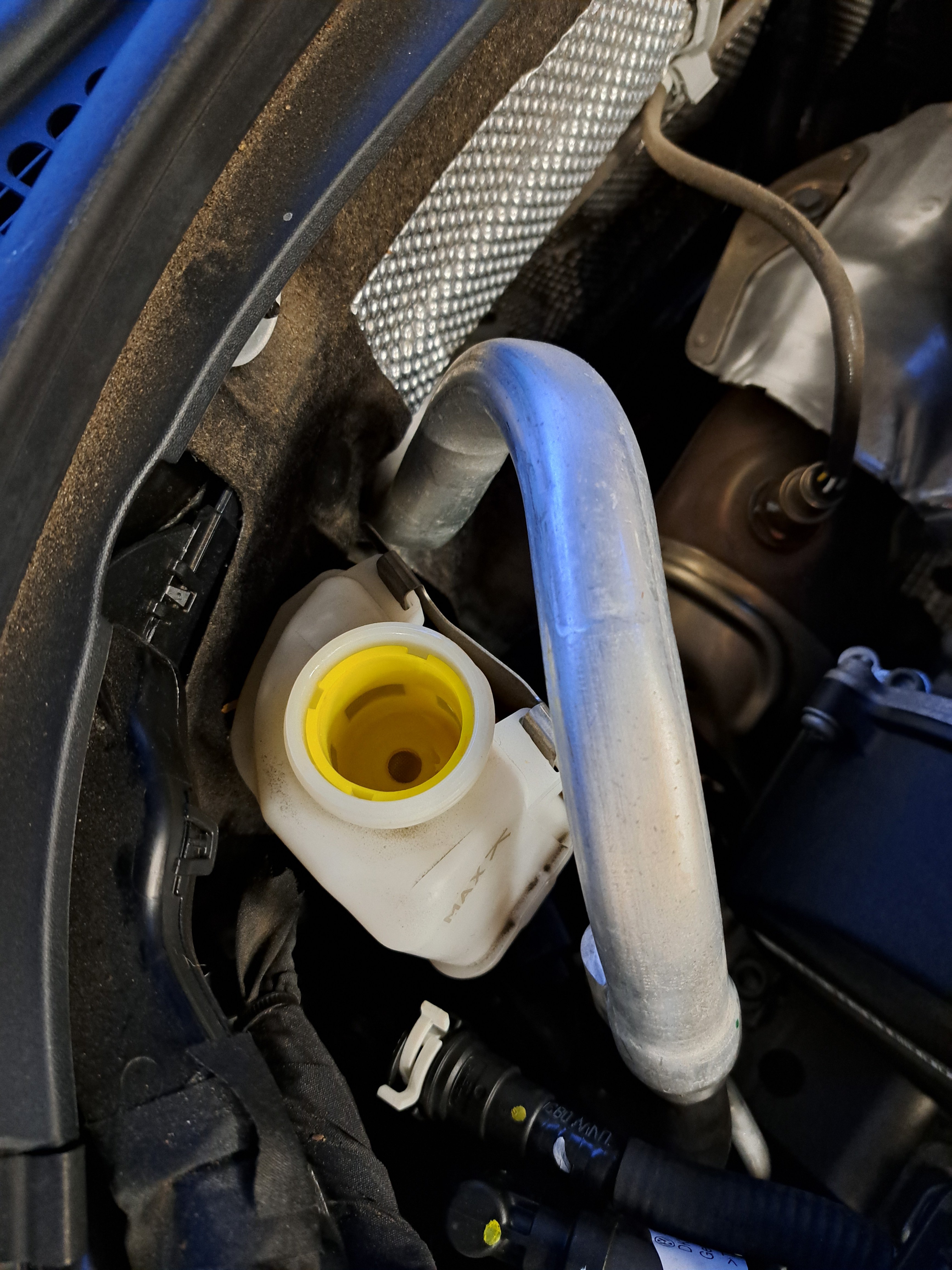

The franchised dealer tells me that I should have the brake fluid changed in my 2020 Superb Estate (at a cost of £75).  However, when my previous car (VW Passat) was serviced over several years by a small independent, they would test the fluid for water content and only advise a change, if it was needed.   So, now I have bought myself a brake fluid tester, but the fluid level is too low for the probe to reach it, due to the yellow filter (I assume it is a filter) in the top of the Brake Fluid Reservoir.  It doesn't come out with a gentle tug - Can I remove it / How do I remove it, please?
Yes they seem to be a right pain, from what I've seen you just use needle nose or long nose pliers and work your way around to lift it a bit and then yank it out.  I'd watch out for brake fluid splashes.  I always had a moist cloth and bucket of water nearby when do brake fluid changes in case of drips.  Obviously you don't want any water to get into the brake fluid reservoir.
Your fluid looks very clean, which is good as it's not just the moist of brake fluid you want to check.

@PeterPan99 in your photo isn't the brake fluid level above the yellow plastic cage enough to get the tip of the probe to as I thought that was all that was required or is that just shadow?
@PeterPan99 did you get it sorted, yellow catch-thing out and fluid tested and/or changed?
