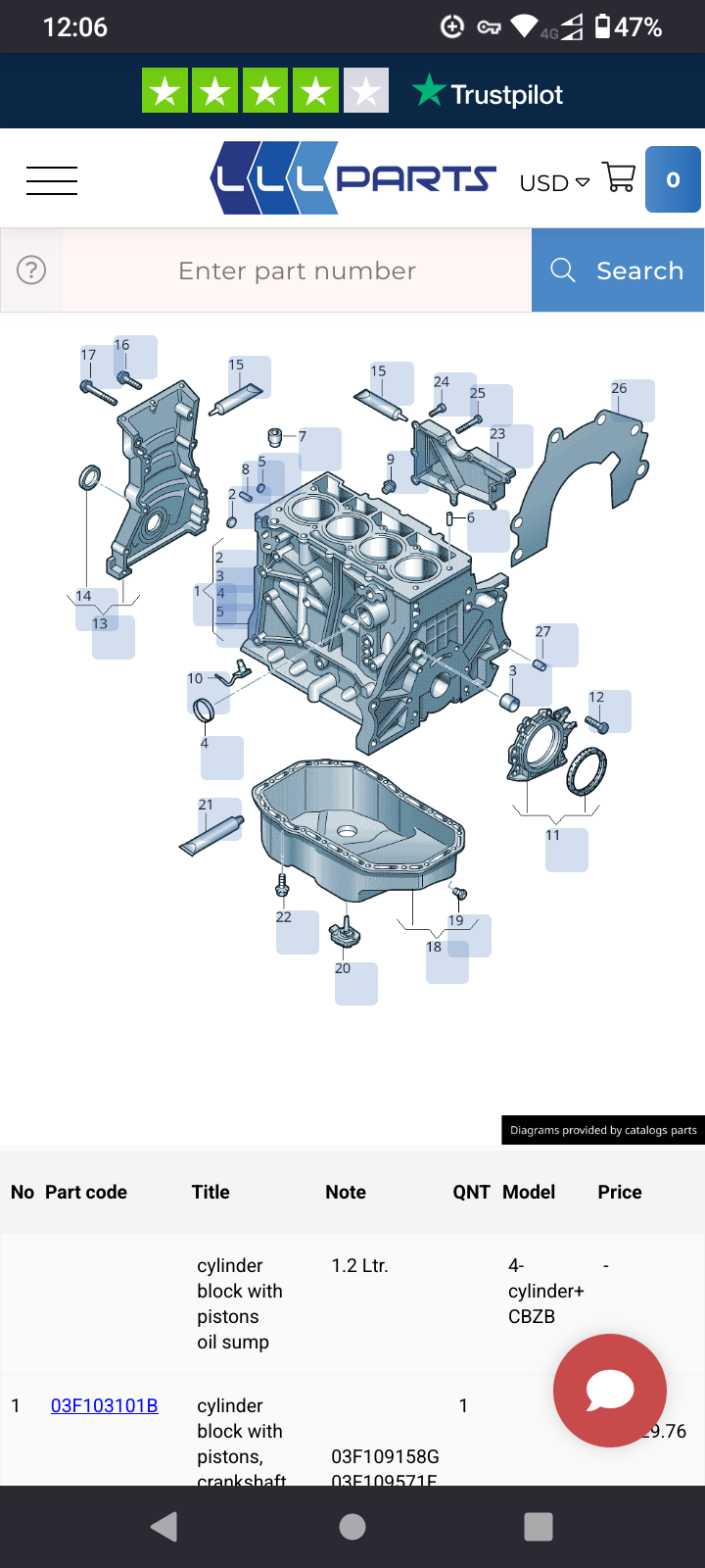

Oil leak - can anyone help identify the source?
xman replied to MijIsTired's topic in Skoda Fabia Mk II (2007-2014)
3 places to check The small PCV valve at the rear and mid to right of the cam cover, often breaks and is left dangling on the rubber hose to the air filter box. Leaving hole open on cam cover blowing oil mist. The crankshaft seal on the timing cover. It looks like the timing cover has been removed judging from the sealant to change the timing chain. Often garages neglect to change the crankshaft seal on the timing cover which invariably leaks after being removed. If the timing chain has been changed, sometimes mechanics don't properly clean off the old liquid gasket seal on the sump and block ( sump has to be removed to do a timing chain) and/or are sloppy on reapplying the correct oe liquid gasket, which requires a bit of skill to do properly. Check around the sump seal gasket, if its leaking, the sump has to be removed, cleaned and new sealant reapplied. The sealant takes over 2 hours to cure, so delay refilling oil and restarting the engine. Also there is some evidence on the photos of the oil filler cap leaking. -
