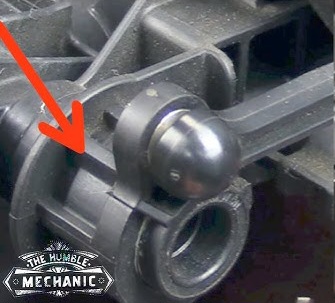

I did some digging an saw that this piece:
Could pop of and cause a vacuum leak which would in turn cause the P2015 fault code.
However, on checking my car, it has the updated intake manifold with this design.hq720.jpg.67484b14991e6cc4236105308bdd18f5.jpg
Im assuming that the pervious owner changed to manfold for the updated one.
My question is what can go wrong on a updated manifold to show a P2015 code?
