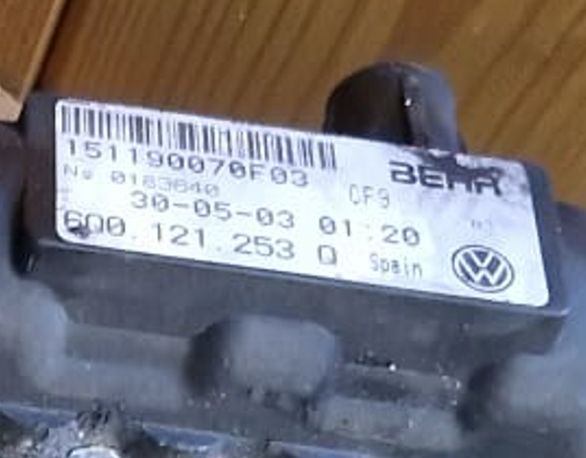

I took a suffix-Q one to bits the other day out of my Polo, manufactured by Behr:
Thanks.
I've ordered a Hella one, which I believe are also Behr, but then also believe Mahle to be too.
Either way, Hella should be OK and it is specified to be dimensionally correct.
