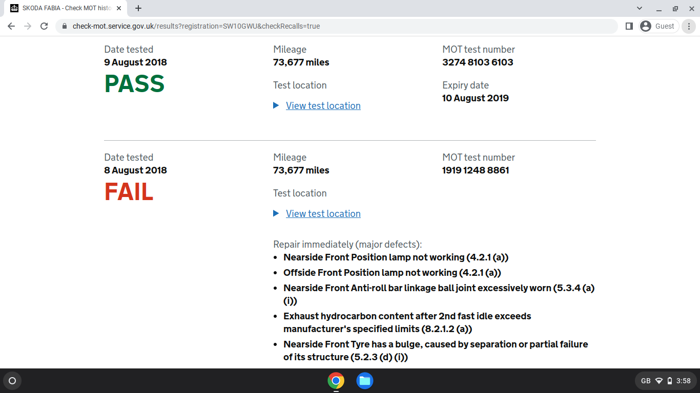

VRS Position Light MOT Failure
As the title says, got an Mk2 VRS that's had position lights inoperative as an MOT failure. From research and other forums this is referring to the blue bulbs which aren't connected to anything correct?
Where do I stand. If I remove the bulbs for the retest will it pass? What can be done in future. Is there a splice in kit for these. What have others done in the past.
Lastly can I get the original failures overturned and how do I tell the MOT without sounding like  d**khead

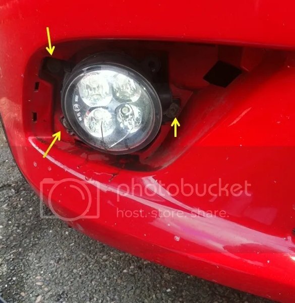

The examiner made an error if the sidelights are on.  That is the DRL units less bright. On as sidelights with sidelight switch or with headlights.   Common mistake.
Does a mk 2 fabia 2011 have drls?

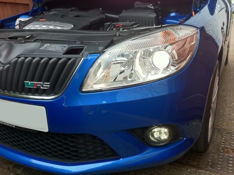

They mk2 doesn't have front fogs, it's got DRL's in place of them
It has sidelights and DRL,s as the same unit, and no Sidelight / Position bulb in the Headlight.  See the Sidelight thread i bumped.

Yes turning the DRL,s off should have him / her see that it is Sidelights on with the Sidelight switch and sidelights and headlights on with Dipped & Full Beam in the headlights.
No Sidelight in headlight to not be seen when when Dipped and Full beam are on, yet some can think Fog Lights are on....
