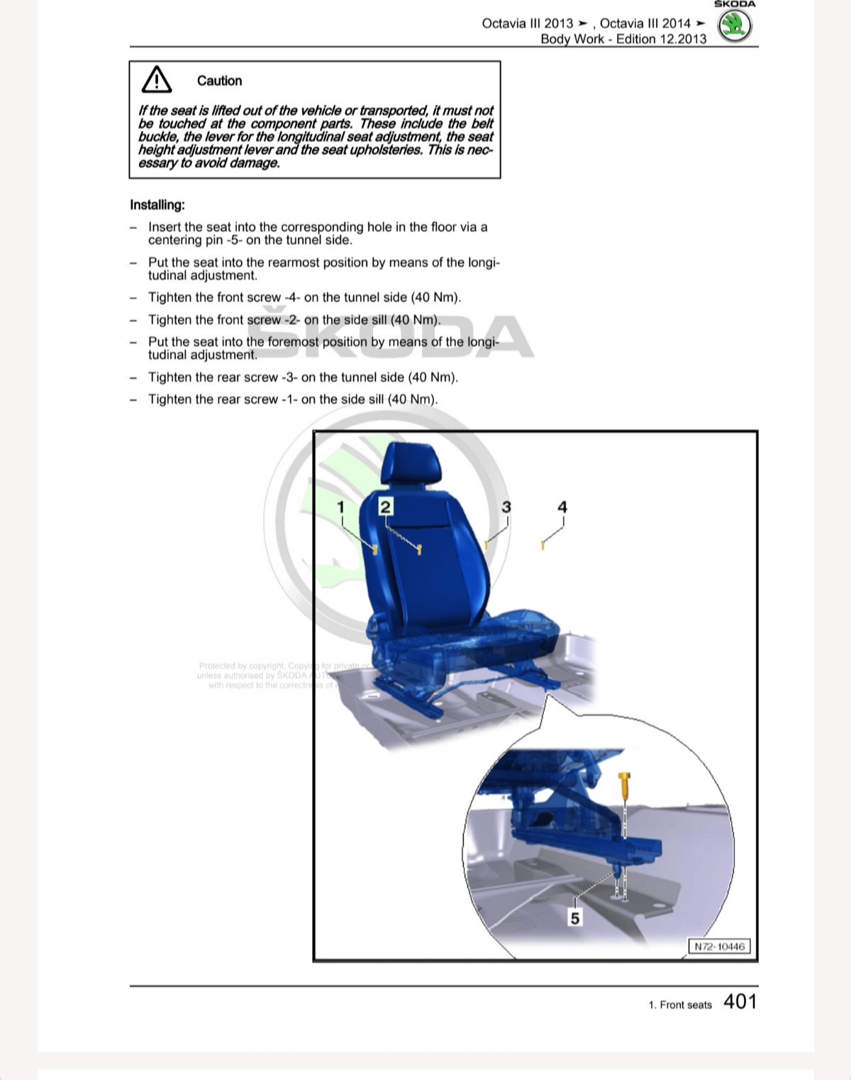

40Nm
7 minutes ago, Cakemonster said:
40Nm
Thanks!!
