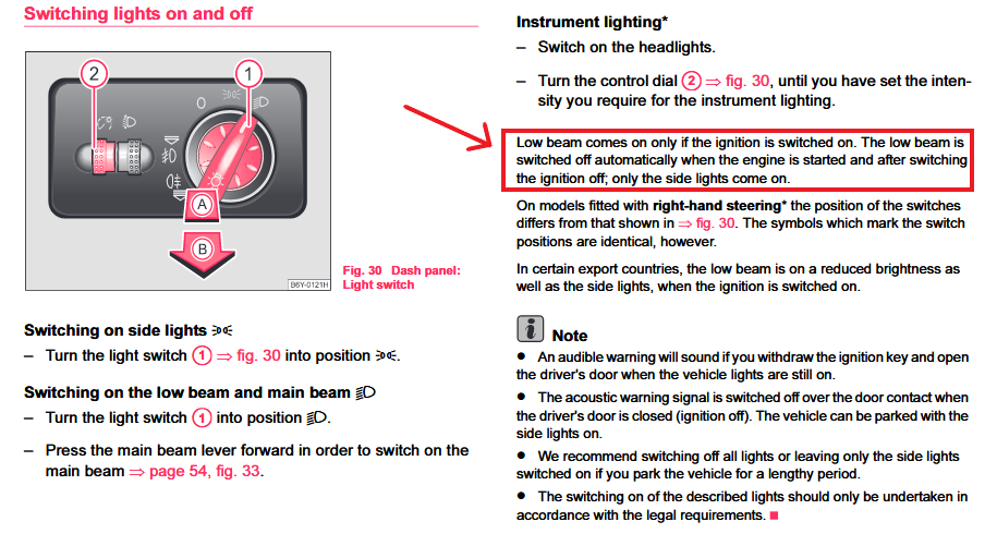

Hi all, I am hoping that I have found the starting fault issue. I believe it was one of the hidden relays behind the dash, the long one . it seemed loose in the carrier so OI twisted the pins slightly and it appears to be working now. I just checked the headlights and they only appear to work with the ignition ON , is that correct, My own vehicle works without .Thanks in advance
Yes that is correct.
