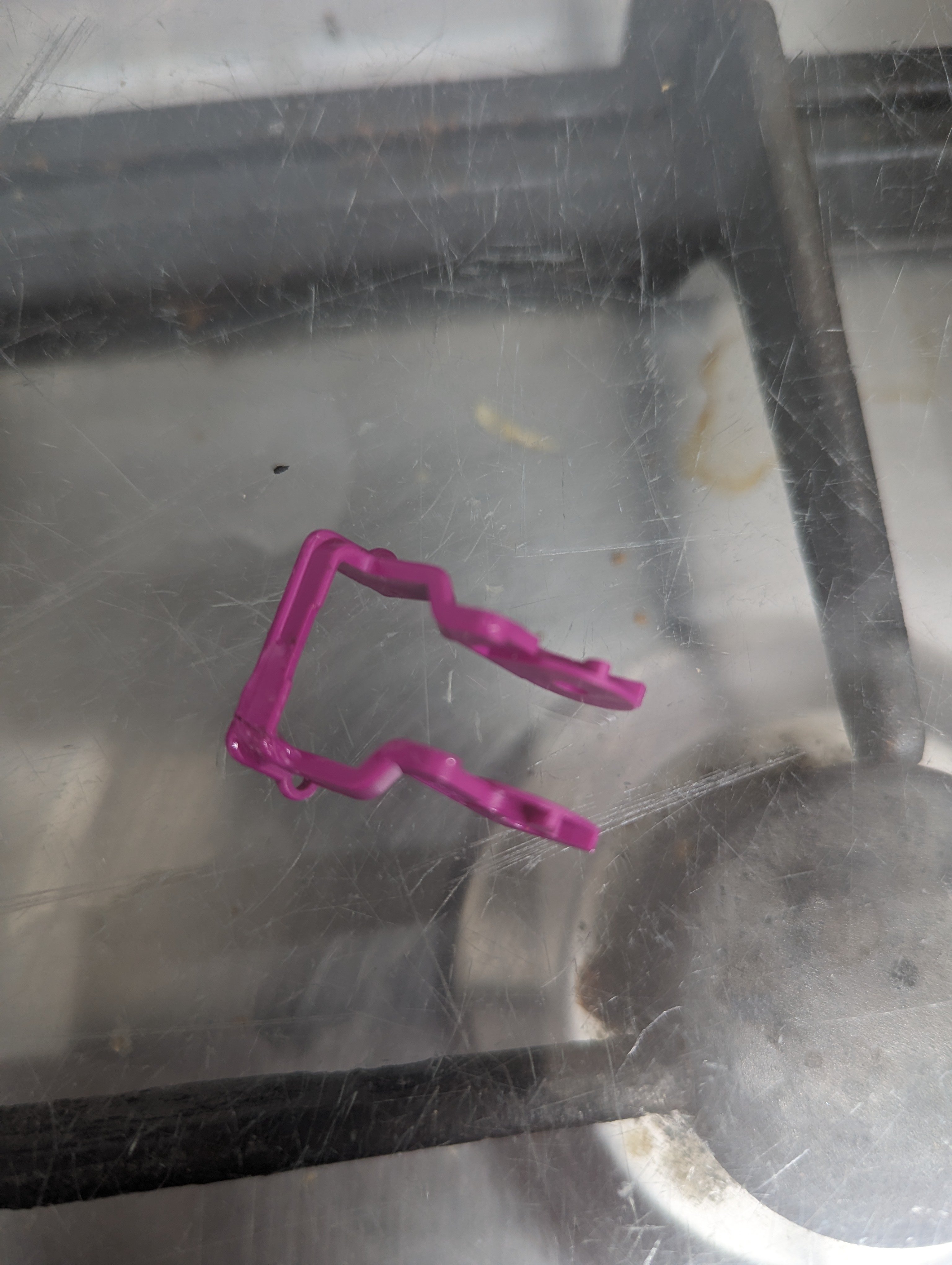

Had to take the Speedo clocks out as they require new LED's for backlighting.
The loom that goes into the back has a clip on it to keep the wire in place.
I've snapped it in half and have no idea what it's called or where to order one from.
Pic included. Thanks
That is the connector engage/disengage lever and almost certainly wont be available as a seperate part.
You will have to knife and fork something with small tywraps or lockwire and judiciously drilled holes to retain it.
Its not a connector that you want to come adrift or have partial contact as any contact problems will immobilise the vehicle.
Sorry to be the bearer of bad news.
It doesn't actually look broken, have you tried re-assembling it?
Thanks for the response. I've put epoxy on it at the minute for that photo.
Any idea where I could source a spare from?
scrap yard or buy the loom (costly)
