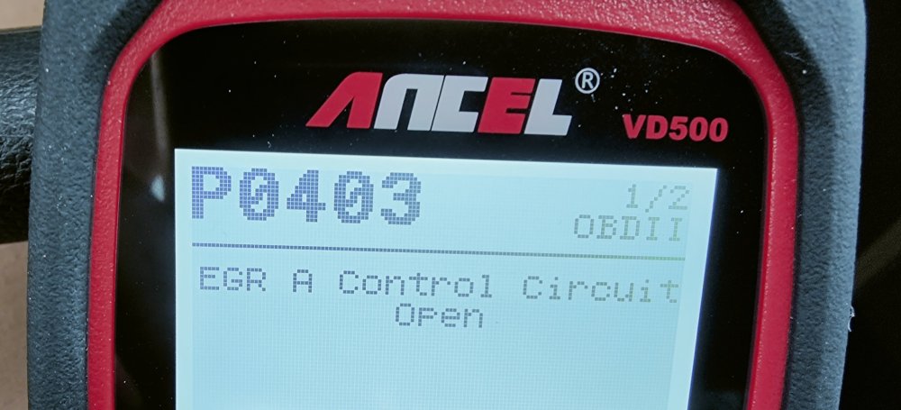

Damn it po403 egr a control circuit open
as title, coming back from Yorkshire and went into limp, cleared at motorway café   and came on at increasingly shorter distances , tbh i have searched and gained a fair bit of insight into the problem , i changed the  egr  vacuum solenoid yesterday  a/ because it was 20 quid b/ could it break down under heat like my oil boiler one did
So did about 25 miles giving her some stick yesterday and she drives great, probably better .
i may be fooling myself though and the egr is sticking but drives great, tickover steady. But i dont feel confident to drive to Yorkshire again

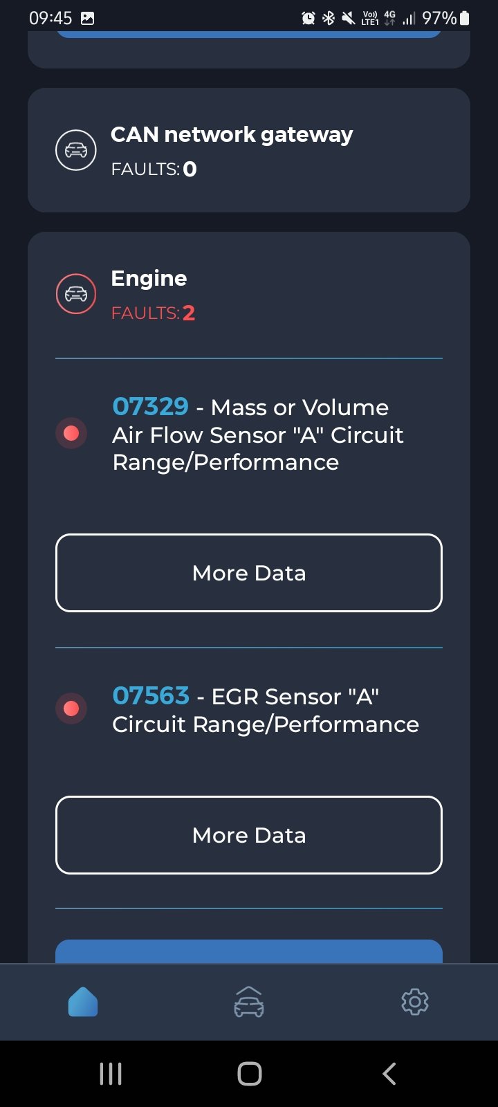

Fault free still since the vacuum solenoid  and thinking about  restricting the egr flow to the point where no light is  put on (badly phrased, just until the light doesn't come on) just to give it chance for my snake oils to clean, if only slightly that area, Also going to set up an old phone to run dpf software to tell me when a regen is due and finished,
