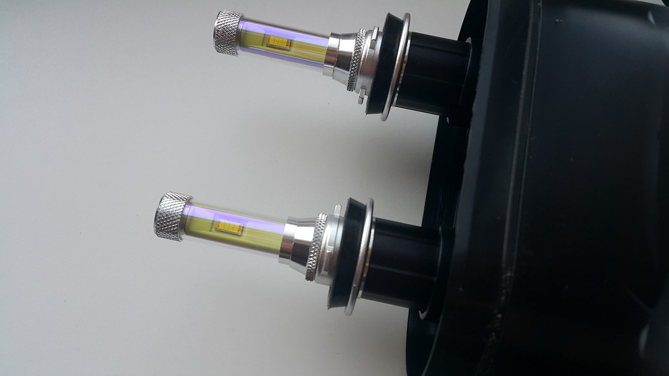

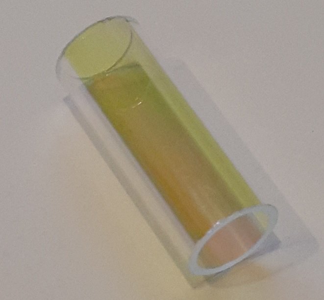

haven't seen any street legal H8 LED, with these from Ali, car failed second MOT control
filter were removed
