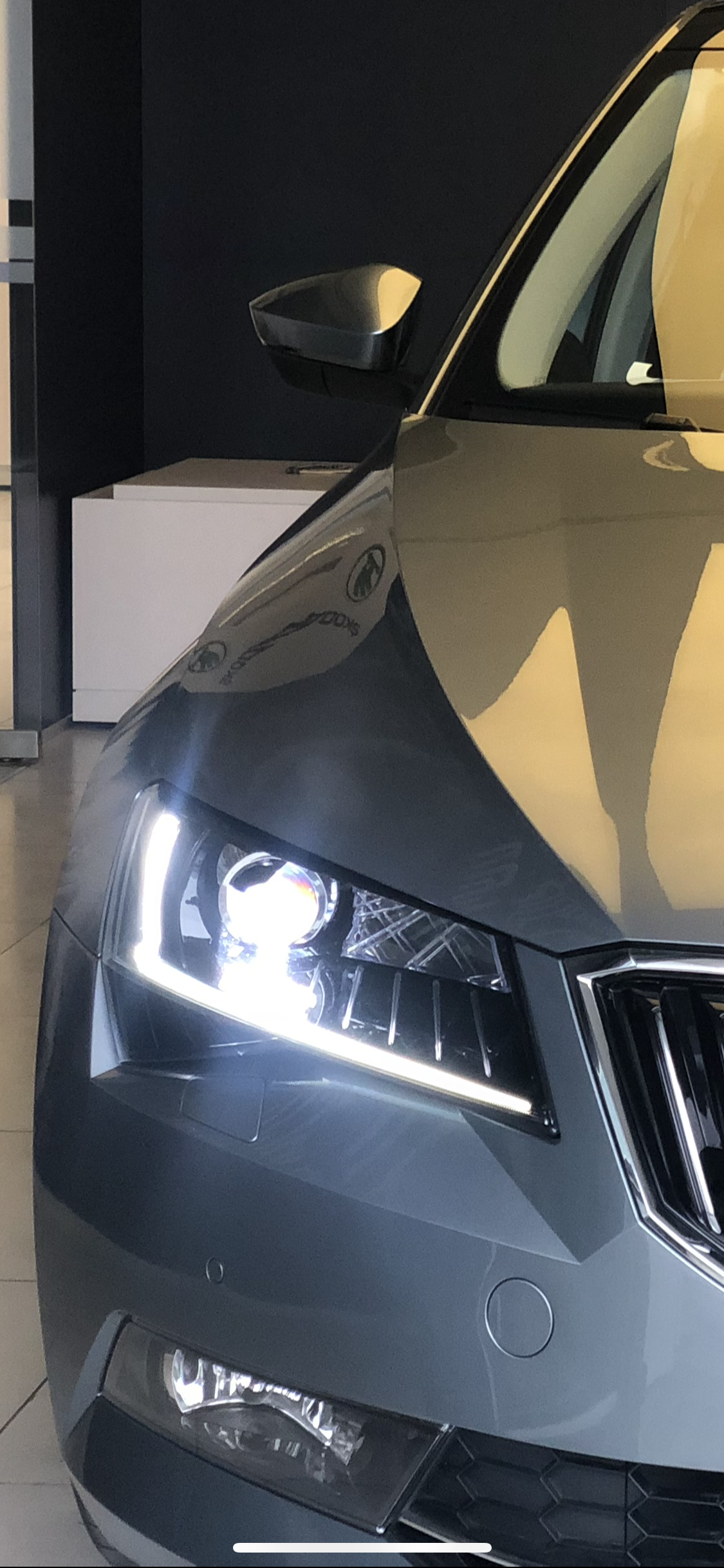

Audi style DRL and TURN signal:
Controller 09 - Central Electronics
16 - Security Access - enter 31347
10 - Adaptations:
1. Leuchte2SL VLB10 Front Left 1
a. Chose channel, which has no active function assigned to it. In my case it was channel E, then
b. set it Leuchte2SL VLB10-Lichtfunktion E2 to «Blinken links Dunkelphase»
c. Leuchte2SL VLB10-dimming EF2 – set «100» (this is not max value for LED)
g. Leuchte2SL VLB10 dimming Direction EF2 – set «Maximize»
2. Leuchte4TFL LB4 Front Left 2
b. set it Leuchte4TFL LB4 -Lichtfunktion E2 to «Blinken links Dunkelphase»
c. Leuchte4TFL LB4 -dimming EF2 – set to 100
d. Leuchte4TFL LB4 dimming Direction EF2 –set to  «Maximize»
3. Leuchte3SL VRB21 Front right 1
b. set it Leuchte3SL VRB21-Lichtfunktion E2 – to – «Blinken rechts Dunkelphase»
c. Leuchte3SL VRB21-dimming EF2 – set to «100»
d. Leuchte3SL VRB21 dimming Direction EF2 – set to «Maximize»
4. Leuchte5 TFL RB32 Front right 2
e. set it Leuchte5TFL RB32 -Lichtfunktion E2 – to– «Blinken rechts Dunkelphase»
f. Leuchte5TFL RB32 -dimming EF2 – set to  «100»
g. Leuchte5TFL RB32 dimming Direction EF2 –set to «Maximize»

nothing seem to changed after tweaking this settings. could you able to post a video of audi style lighting?
1 minute ago, pompom said:
1 minute ago, axd1152 said:
I'll check it during night then, might be too bright during the day now. Thanks mate.
The changes can easily be seen during day!
i  watched it again and i can tell it is dimming like the way in the video. would look much nicer in the night . Thanks again.

This is too much. You only have to change Leuchte2SL Light function E2 from "Blinken Links Aktiv (Beide Phasen)" to "Blinken Links Hellphase"
and in Leuchte3SL Light function E3 Blinken rechts Aktiv (Beide Phasen)" to "Blinken rechts Hellphase". Nothing need in Leuchte4TFL or Leuchte5TFL
But in the meantime there was service action for the xenons which after the initial test  during engine starutp, falls down and don't want to go up.
After that, the previous method is not working any more. Due to that, above is valid for updated cars.
