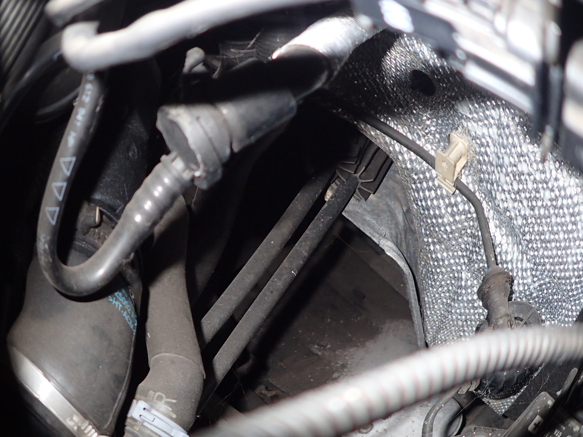

Anyway, compared to my old one there is a lot of road/engine noise coming from the centre console/lower dash area. Actually driving me a bit insane especially in lower gear where the engine is revving harder. On inspection and with help from a friend, I have realised that looking down the back of the engine, there's quite a large gap for the transmission tunnel etc and I'm convinced this is where I'm hearing the noise. Should something be in this area? Sadly I don't have my old one for comparison but it was also a 2.0 Diesel 4x4 and much much quieter.

This view is taken with me standing facing the front of the car, bonnet open, looking downwards from the right hand side of the engine bay, past the firewall.
You can see there is definitely some insulating material on the firewall itself and down and around into the "transmission tunnel".
It is silvered so maybe it is more for heat insulation than for sound. Also it doesn't appear to have any lagging type material associated with it, at least not the material you can see edge on, that disappears into the "transmission tunnel", so again perhaps it's main role is not sound insulation.
And just for info., my brother's 2.0 TDI Yeti, despite similar km's, is noticeably quieter than mine. At idle and in the lower gears, I can clearly hear some "diesel clatter" whereas his car is virtually silent.
