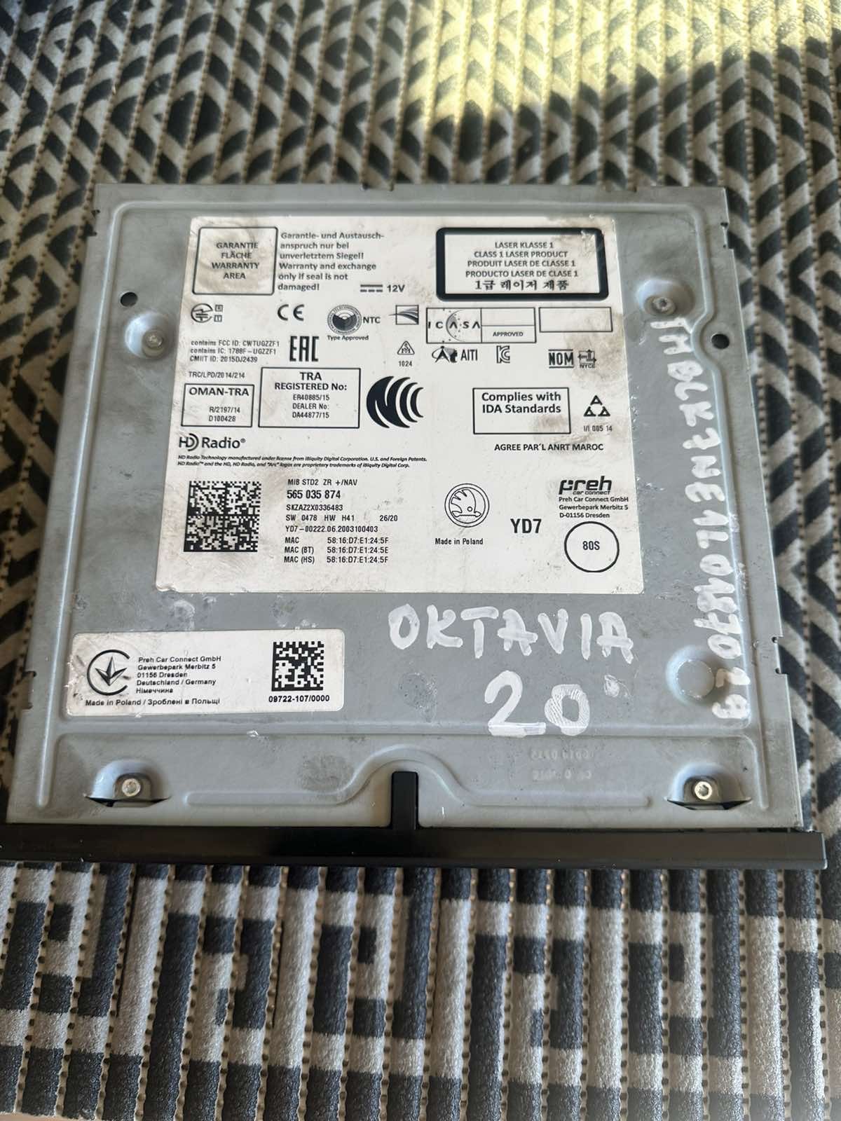

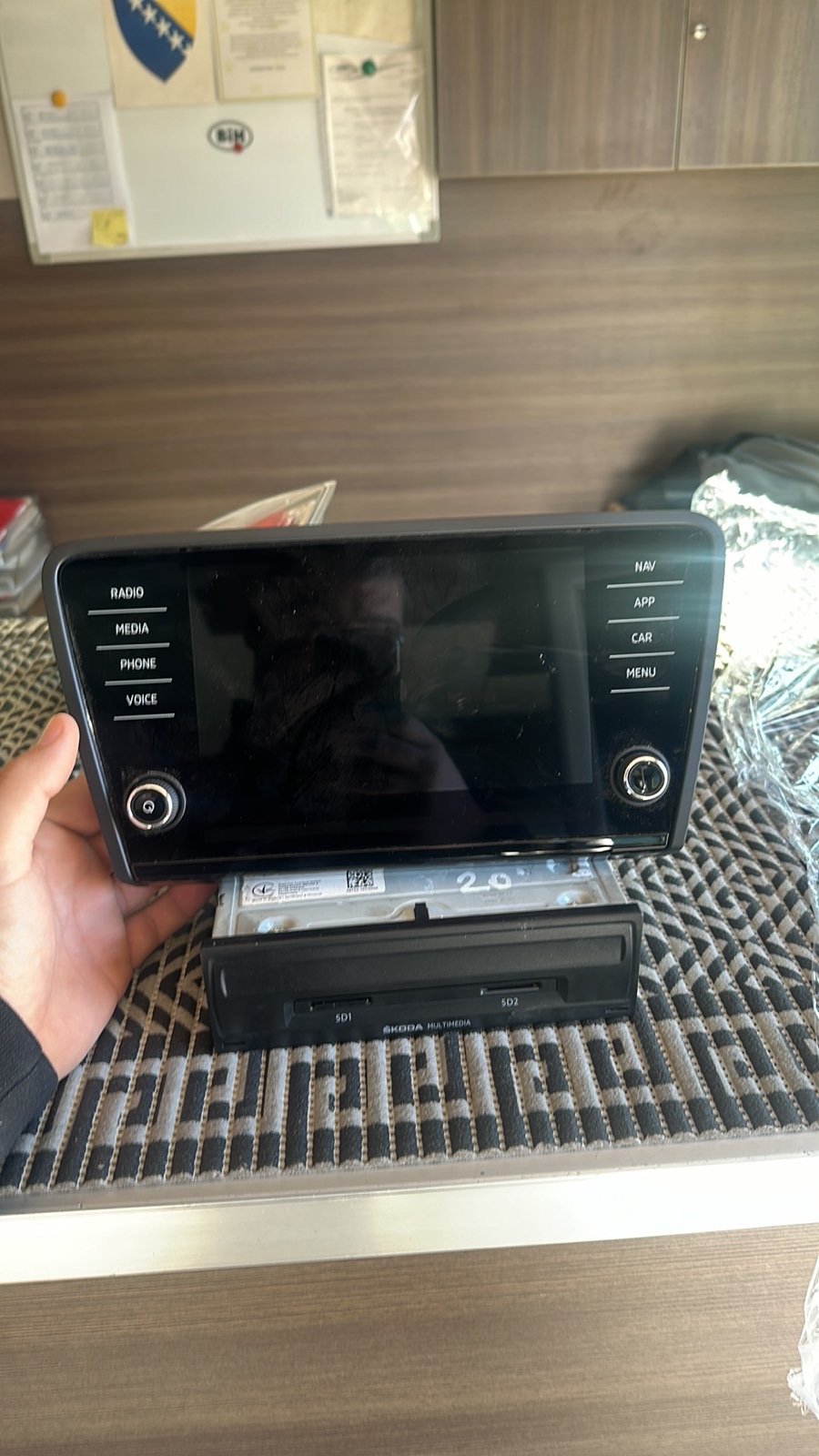

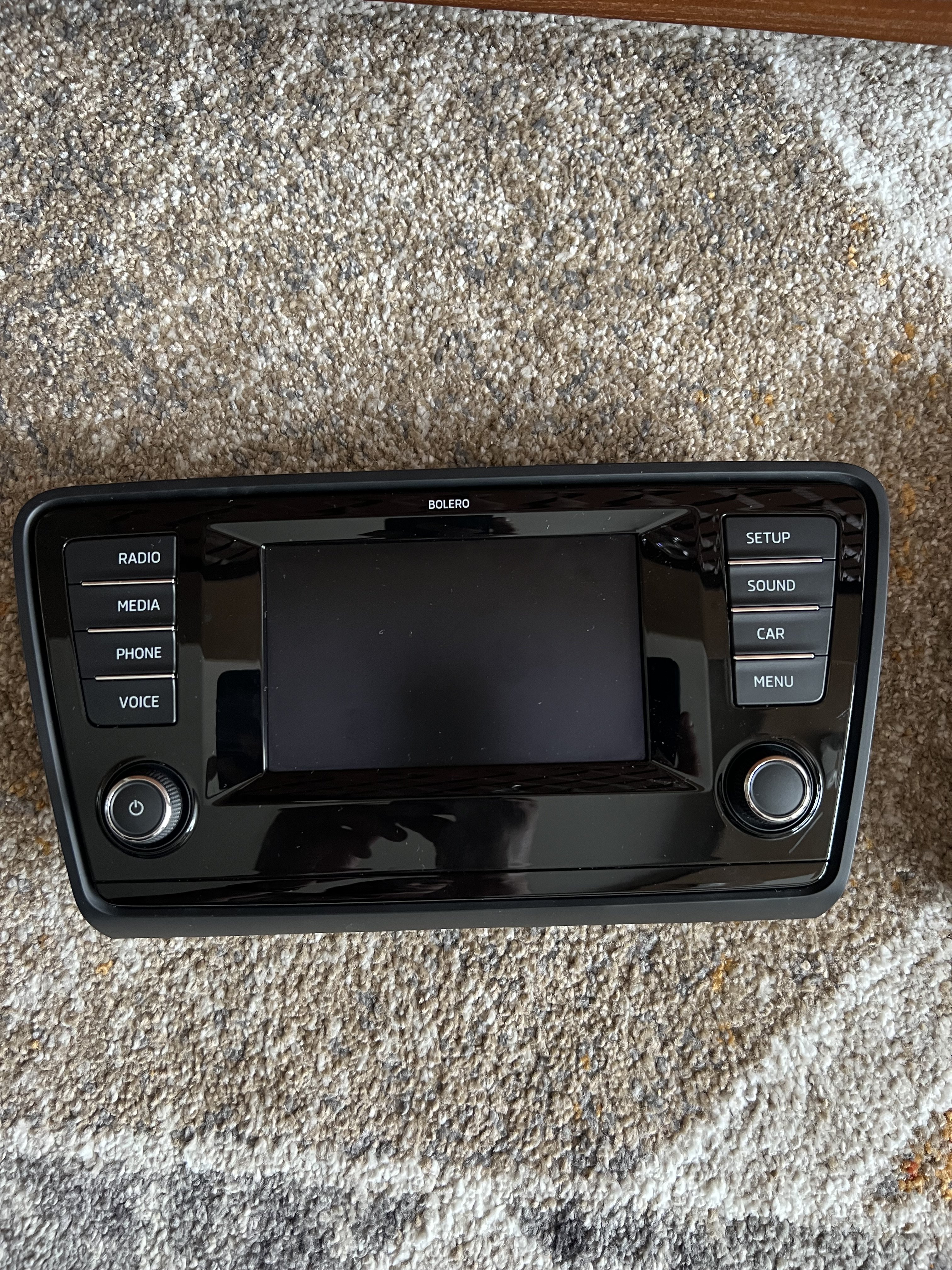

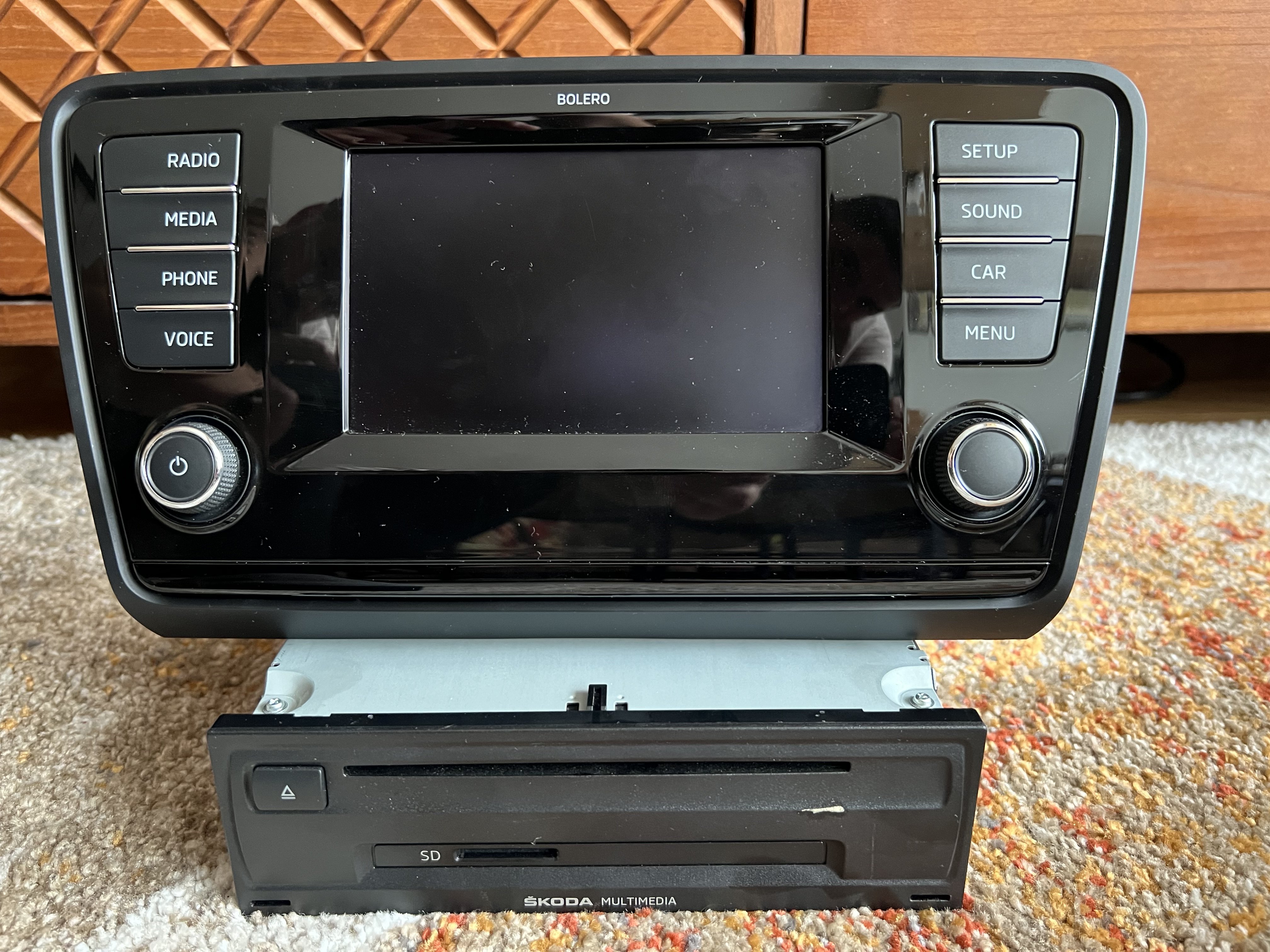

My question is why is this happening, I talked with coding guy and he tells me that main unit of multimedia is going to die? Is it true and is someone have this problem, I will send picture of old multimedia and new one.
